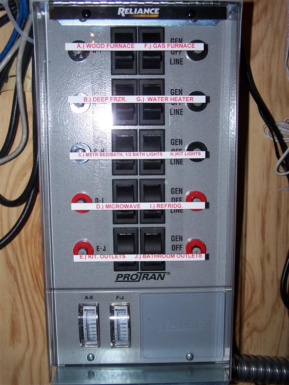

If you are wondering, I have a portable generator and have the furnace wired into this panel.
