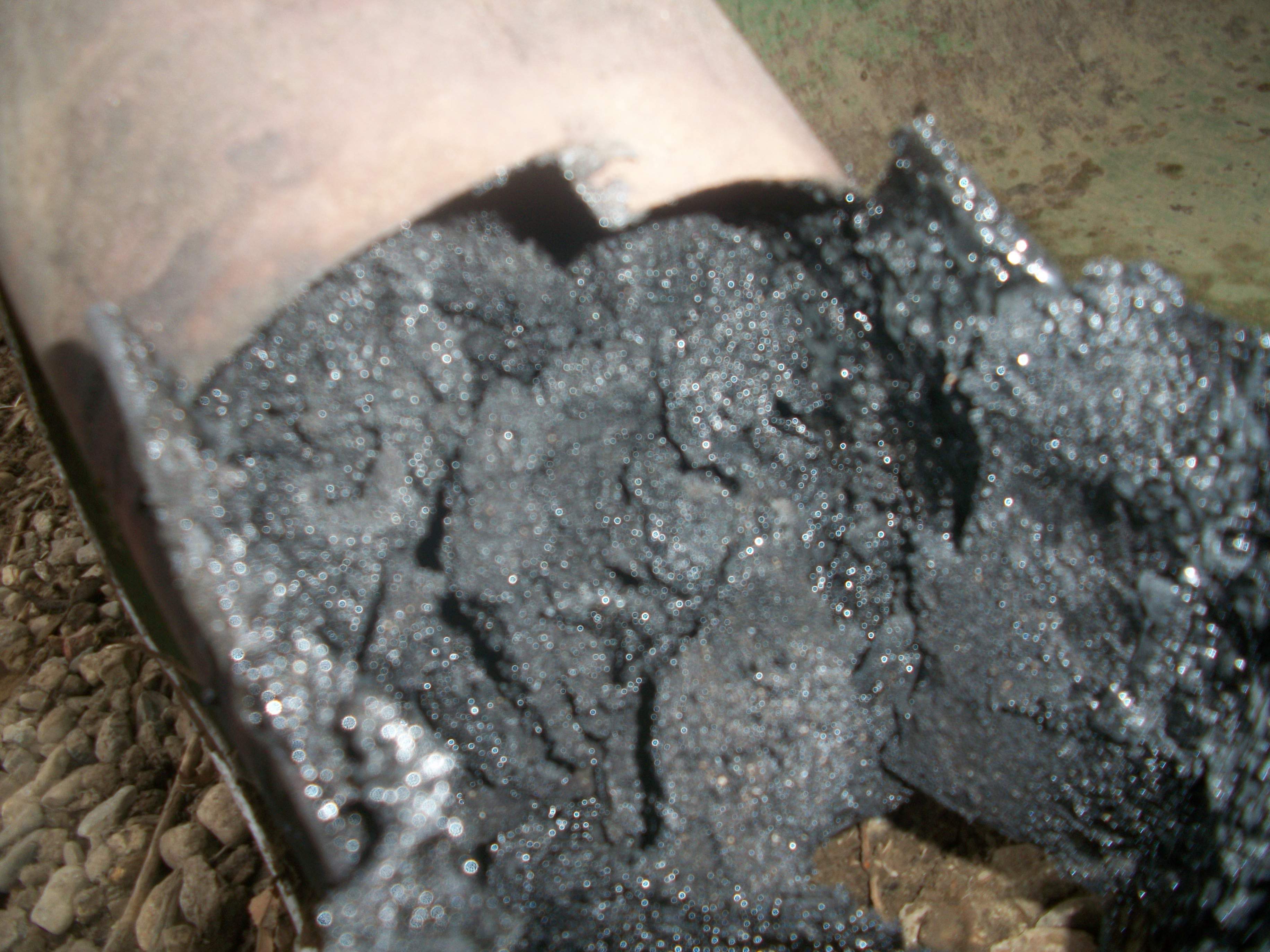

Wayne- I assume the thermometer you refer to is clipped on to the front of the stove? You also have another one in the pipe? I don't have one on my Defiant-probably should get one Point of info and a lesson for everyone-my Defiant is piped in a similar fashion to yours- I have about a 3' rise of 8" pipe, then a 90 that goes into flue. When the house was built 21 years ago, the mason did not put a clay thimble in-what I have is an 8" x 8" hole in the cinder block and then the block is tight to the flue liner-that I think is an 8 x 10. the flue by the way is full length to the base of the chimney and there is a clean out door in the base.
So what I have done is I run a length of 8" stove pipe into the flue up tight against the far side of the flue. I also cut a piece of stove pipe that forms a baffle at the end of the pipe so as the exhaust comes in, the flue gas hits the baffle rather than the clay flue. I also pack fiberglass insulation around the 8" pipe where it penetrates the block so it is relatively tight. My house by the way is two story typical New England "early American" look with 10/12 pitch roof and a center chimney- thus that flue is close to 45' from the basement floor to the top of the chimney-that's a lot of flue that can cool down.
My routine every year before the chimney sweep comes is to pull this pipe assembly out and give it a cleaning. This year, my sweep didn't come until Nov 30th and I started burning about three weeks ago and the stove would not draw and was smoking whenever I would load it-regardless of draft control.
Well they say a picture is worth a thousand words-this is the end of the pipe that rests in the flue. the sweep took 6 five gallon pails of creosote out. shame on me- I guess I burned more than a little damp wood last season. I'm also guilty of not cutting my wood ahead of time and getting it under cover-rather I go "hand to mouth" all winter-its my winter recreation program. So I've got plenty of log length wood that is not green, but its not cut or split yet either.
I've learned my lesson though and will be burning a lot hotter this year. By the way, my chimney guy is a good guy and a pro. he usually cleans it from the basement and this time, this thing was so packed, his quick coupling came apart and he had about two lengths of rod and his brush jammed in not far from the top. Long story short he had to get the ladders out and go up on the roof and push the jammed brush and rod assembly down. Cost me twice the usual fee.
