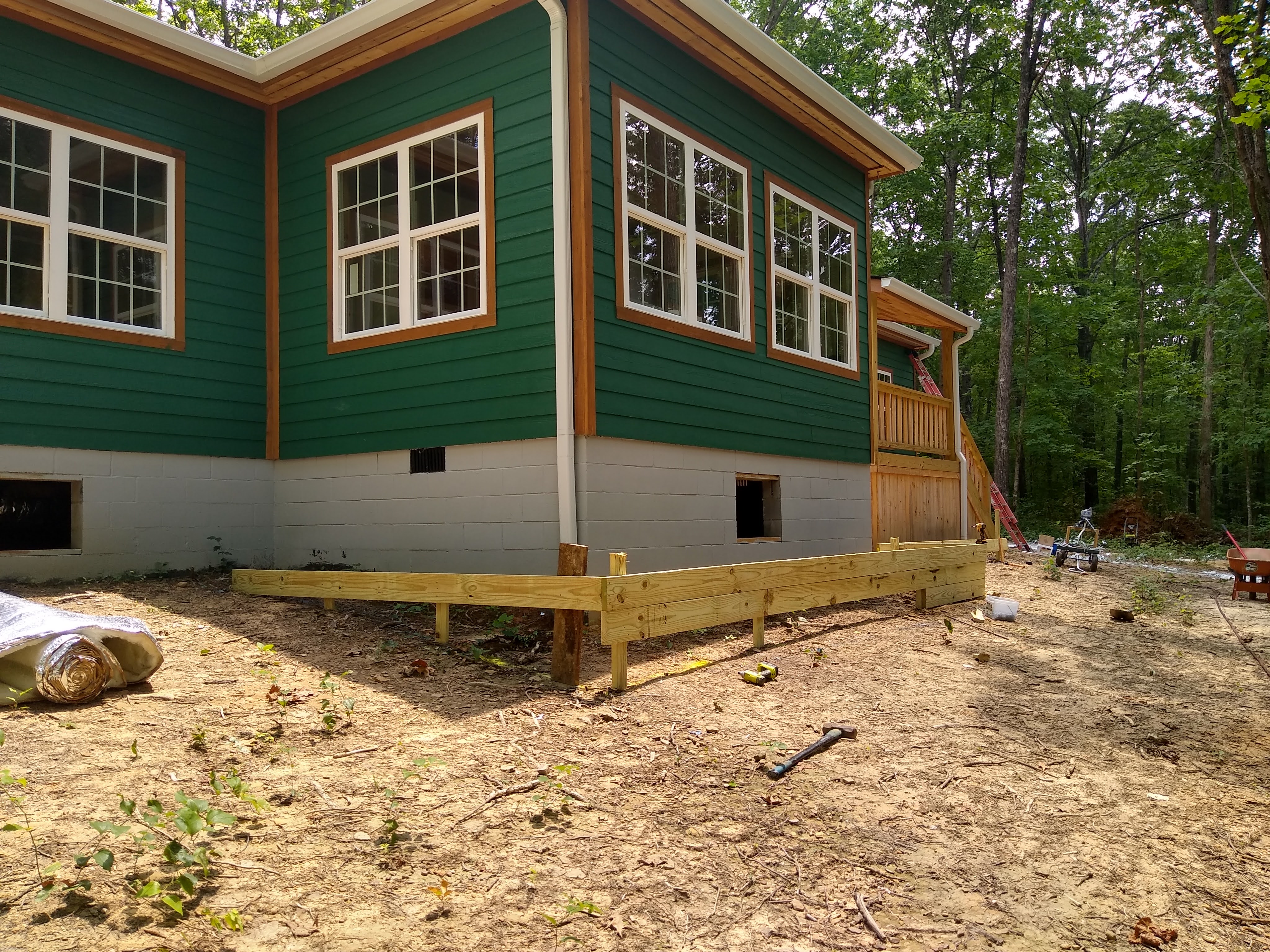

I am finishing up this house. LP Smartside instead of Hardie, but same idea. Stained western red cedar.
