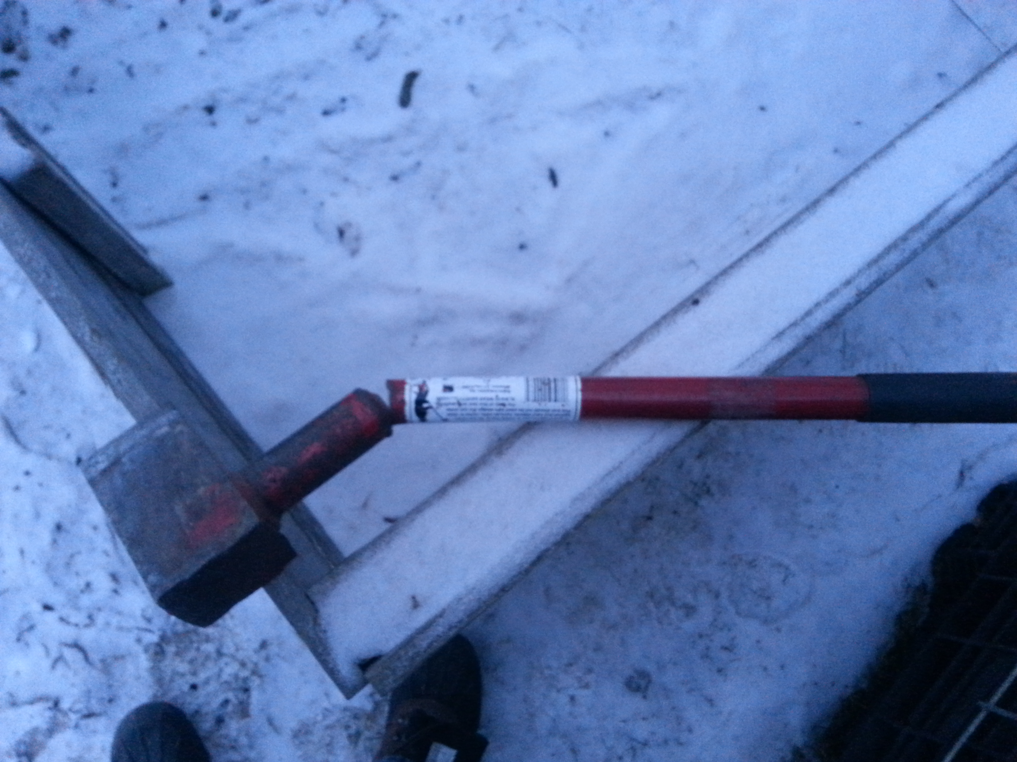

That's what I will have done but it was disappointing. I was working on some hard elm that I tried to split when I cut the standing dead tree last spring but it just went thud. So I waited until we had some good cold weather for easier splitting. Most of it was split when this happened while I was doing the largest round. Out came the saw.
What brand maul was that?
   / Wood vs Pellet heat ??? #84
It looks like a hollow steel handle that probably filled up with water and rusted out.
   / Wood vs Pellet heat ??? #85
Brave Industries out of Wisconsin.
It is a hollow steel handle but it was sealed - not even surface rust.
It looks to me like they started and stopped the weld at exactly the wrong spot creating a small stress concentration.
