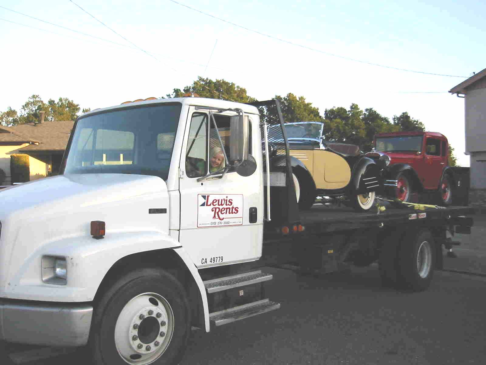

The repo guys can winch up a car like a BMW with all the theft deterrents by spaying a little water on the deck... and they are fast.
I've rented rollbacks many times and would love to have one...
Here is a picture with my co-pilot loading up for the car show... no problem putting two vehicles on one rollback!
My open car trailer is a tilt with steel rails... never had any problems.
