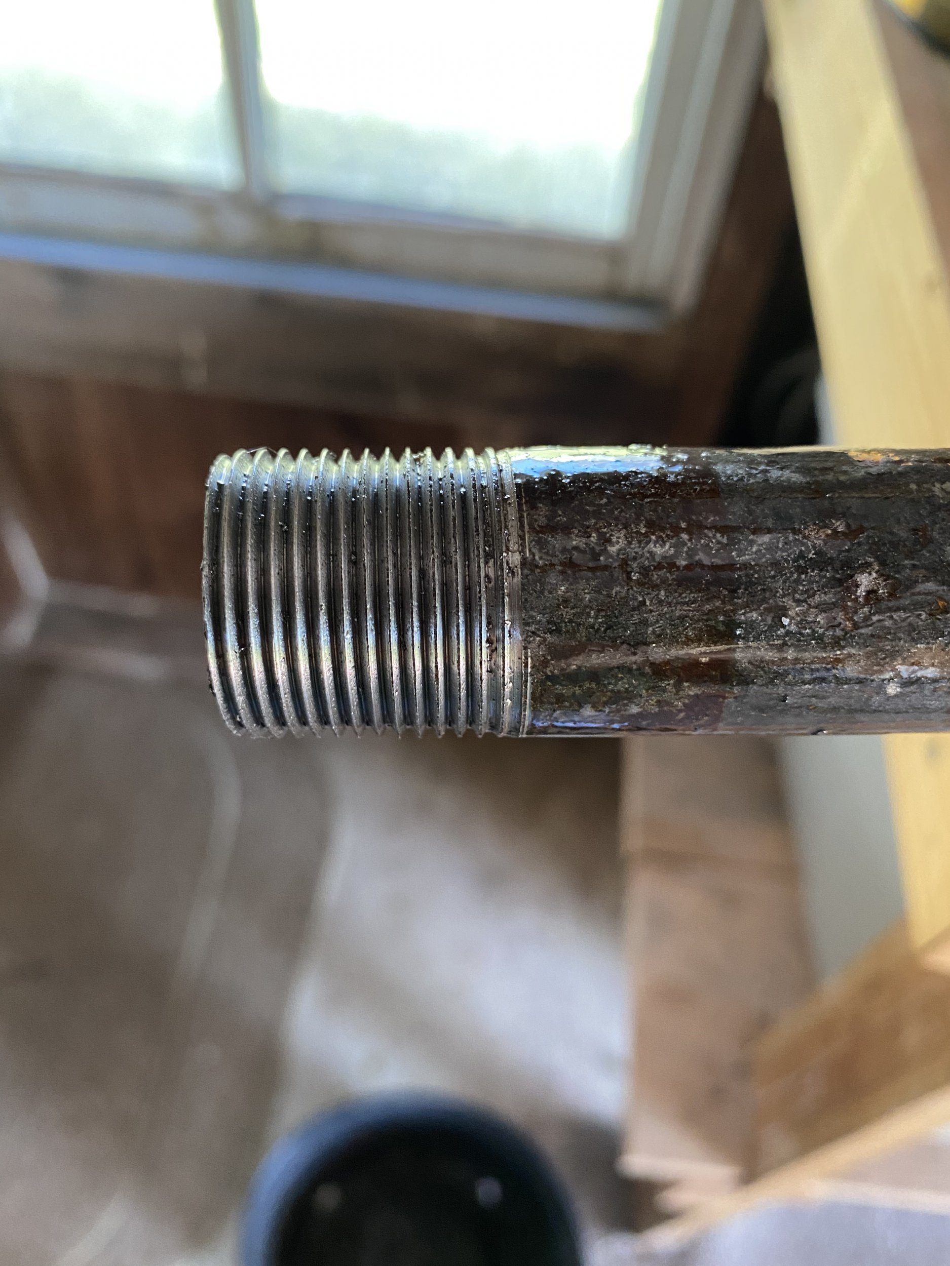

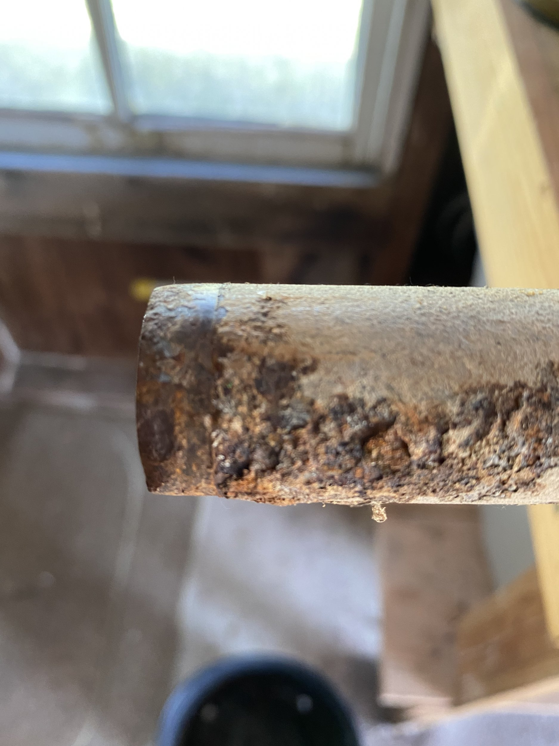

I bought four Bessey 24” parallel clamps to start my clamp collection. Next thing, went to back shed and found old 3/4”galvanized pipe. Cut four each of 3ft, 4ft & 6ft…Used a strong wire brush w my 110V drill, then filed off any left over debris. Then put 1” worth of 3/4” threads. Worked like a charm and the clamps really bite well. Here’s a b4 & after:
