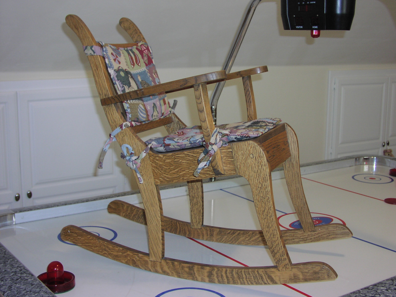

Here is some trivia for you - old timers were smart.
They used quarter sawn oak for doors, trim, furniture. Expansion and contraction splits doors and causes gaps in miter joints. Quarter sawn expands/contracts with the thickness and not across the face so it alleviates the problem. Pretty smart..
Love quarter sawn Oak; made this for my Grandson maybe 20 years ago.
