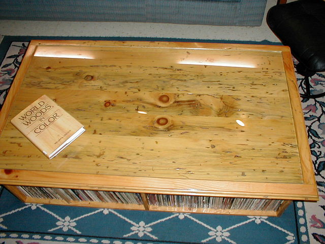

I buy lod truck loads of pine and hemlock. That particular log was from a load that I payed $100 for. Al brings me some of his junk for the cost of trucking and he probably cut that tree from someones yard along with many that were much nicer. He knew that he couldn't make any money from that log at a regular circle mill so I got it. Most of what I get from him is either short, lumpy, crooked, or has some tramp metal in it.
It sat in my log pile for 2 years before I got around to it. Pine can be cut for a long time after felling but will not yield very much clean honey colored wood. In warm weather it will get blue/black stain very quickly. I call it "denim" pine and some people love the look. After a few months pine will also get grub worms that will bore holes in the wood. When you walk near the logs you can hear them crunching inside. Again some people love the look of what is called wormy pine.
I have cut many old logs. Hemlock seems fine even 2-3 years old. Oak I have cut that was nearly completley buried for 3 years. The outside was a little punky with pin holes from bugs but the heart wood cut fine. You can see a difference in old cut oak but I have to point it out to most customers. Older logs also cut a little harder on the mill but not nearly as hard as even fresh hickory is. Cherry and walnut seem fine, however maple and birch will begin to spalt when left for a long time. Again though spalty maple is a prized specialty wood that brings in big bucks.
Try this. Check http://www.woodmizer.com/welcome.html to find someone close to you with a mill. Use your tractor to get a few logs together and put them on some level ground parallel to each other and trim them on the ends with your chainsaw. Then hire the woodmizer owner to come over and cut them for you. This will let you get a feel for the labor and fun involved as well as giving you some product to see and work with. If you are like so many of the people I talk to on the http://forestryforum.com/ you will get a whiff of sawdust and get hooked.
   / Wood you cut this?
#19
here is a shot of a coffee table I made from wormy denim pine.

woodsmill1
Thanks for the info!!!!!!! /forums/images/graemlins/grin.gif
Nice table!
