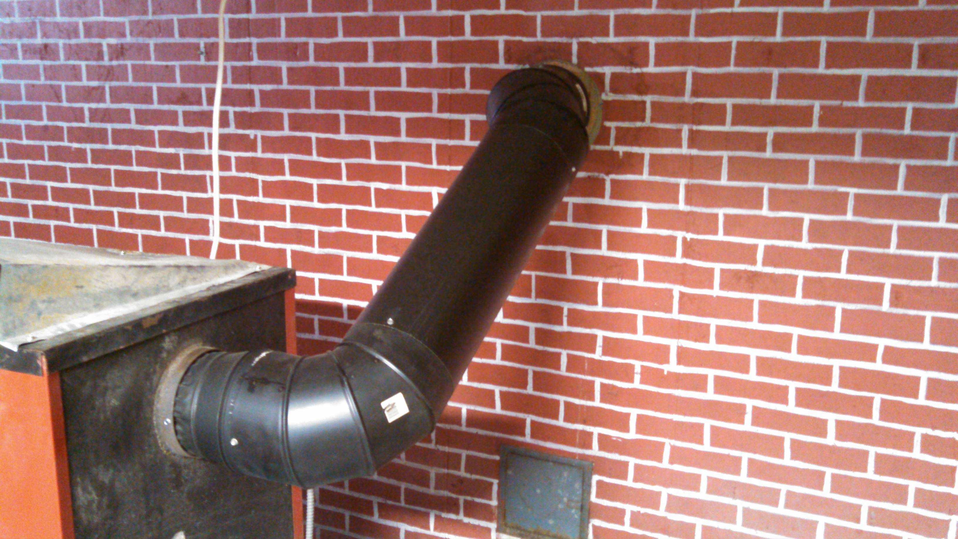

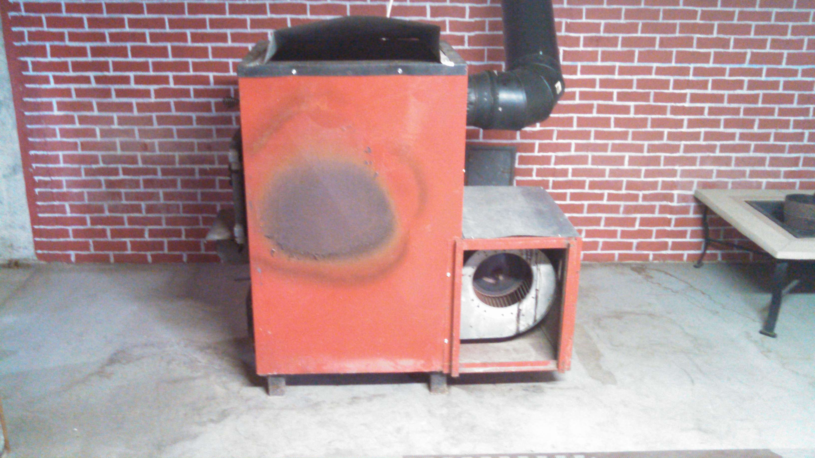

Just some pics of the brunco 120 wood-stove I installed. Had to take the pics for the insurance company so I figured I'd post them also.
Probably only burn it for a year then it will be back-up only once I get geo-thermal installed.
Basebard heat is $$$$. My daily KwH usage was 115-120. Or about 3500/month. In my area, that equates to $420/month electric bill.
Using this for the past 3 days had dropped the usage to 50/day. Or about 1500/month. and at $0.12/kwh, thats $180/month.
So baseboard heat was costing me ~$240/month for the past month, with an average temp probably in the mid 30's. And Jan-Feb probably average low 20's. So it was only gonna get worse.
We will see just how much wood it takes to get through a month to see how much it will take me for that savings.

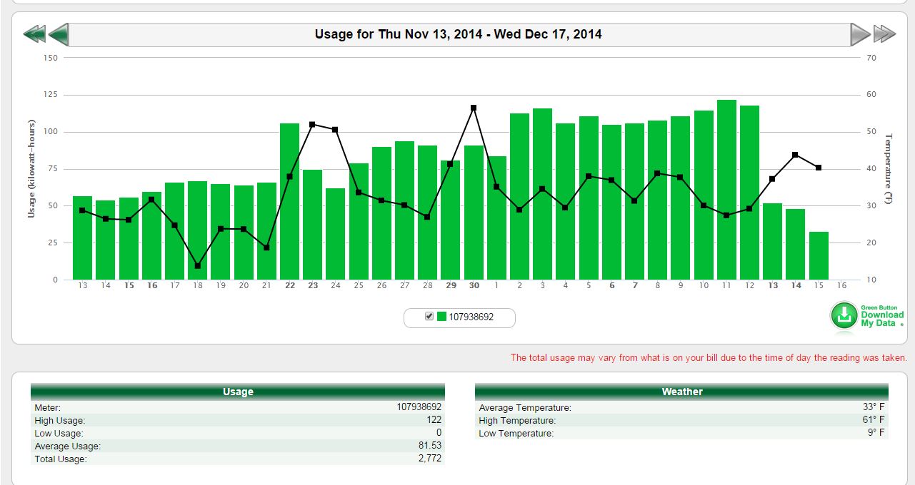

Electric company has a nice tool to moniter my usage.
Green bars us usage, Black line is temps.
Can anyone tell what day I moved in? And what day I started the wood stove?

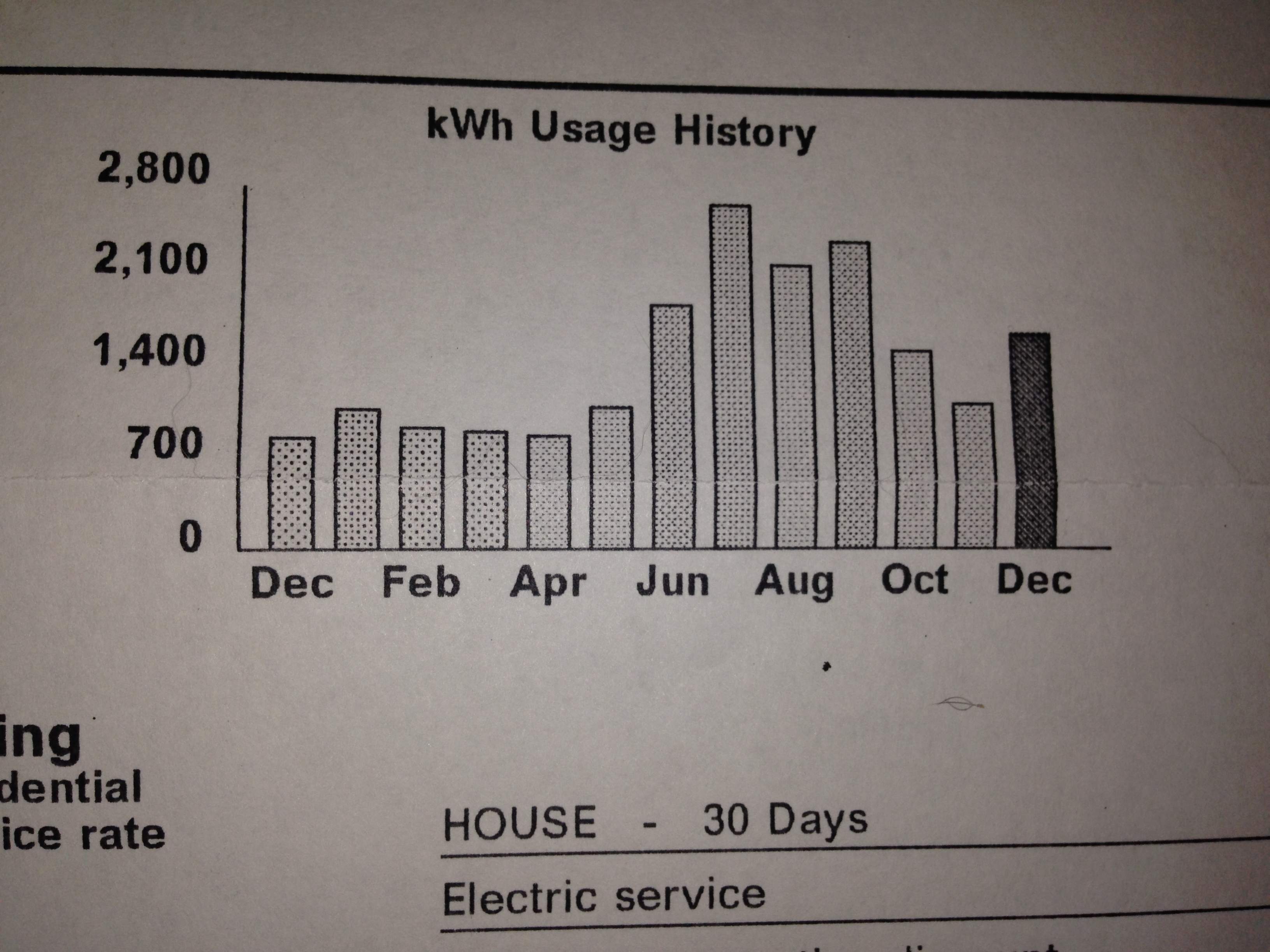

That's awesome. I wish my power company did that. We just get a low-res bar graph printed on the bill, and it only goes back one year.

Yea, its pretty cool to be able to break it down by day.
I can go back multiple months or multiple years too, but since I have only owned the place since the first week of november....I cannot go back any further.
   / Woodburner install Pics #8
Well, had you installed it back in November, you'd notice a bigger savings. This month has been very warm.
