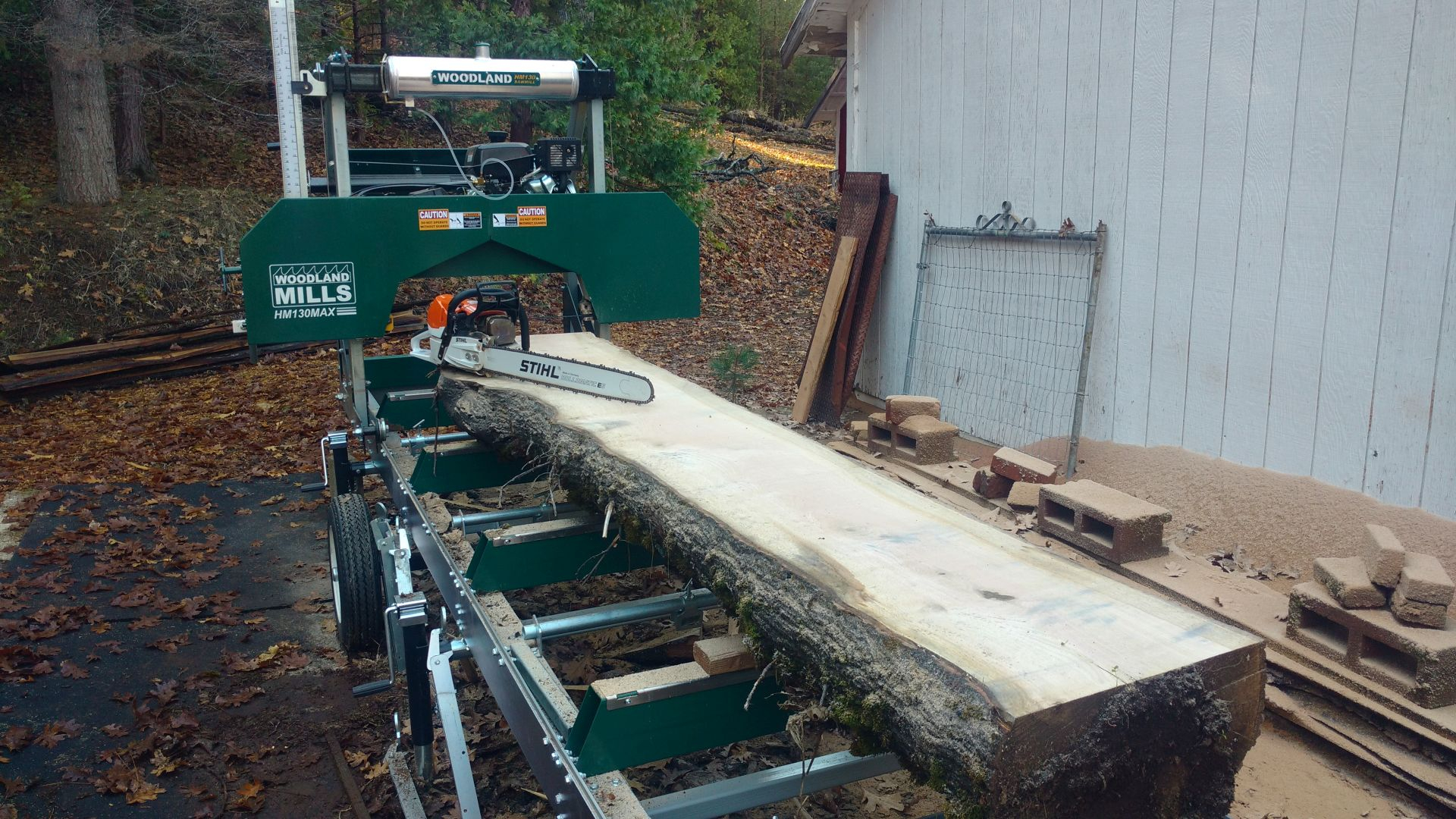

I got the 14 which is the biggest they offer.
Mine is 14hp also. It seems like the right power for the mill (although you can never have too much ..)
fyi their manual recommends first oil change at 5 hours.
The 14hp cuts easily through pine and cedar. You do have to find the right "pace" of moving the mill down the track. Not too fast.
Had to go a little slower through this 24" oak limb-- making a slab. And it gave a little hesitation when encountering two knots where smaller limbs use to protrude. But my blade was also getting a little dull-- probably 2/3 the way toward needing a newer sharper one. (I've only changed the blade once so far.)
fyi that's a 30" bar on my Stihl 462 saw.
