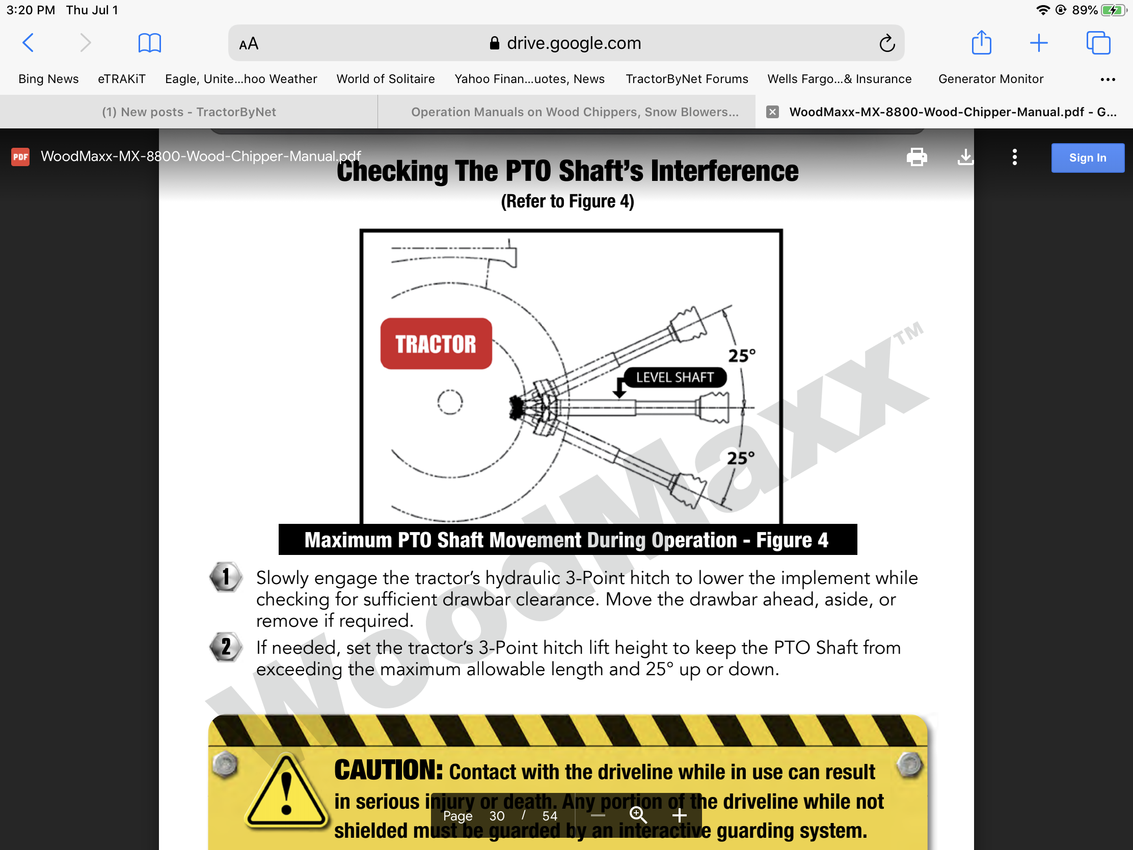

I just downloaded the wood max mx8800 manual. They say to raise or lower chipper to maintain drive shaft angle.

Not fully lowering when running is ok?
The idea is to have the pto shaft level. Doesnt matter squat about how low the machine is. It needs to be setting on something solid, but it could be off the ground on blocks.
That is another good thing about the bigger woodmax's - adjustable legs!

The Victory I bought has adjustable legs- I try to get the PTO shaft as close to straight as possible and then drop and pin the legs. I wouldn’t be very comfortable running it using the just the 3 pt as my support.

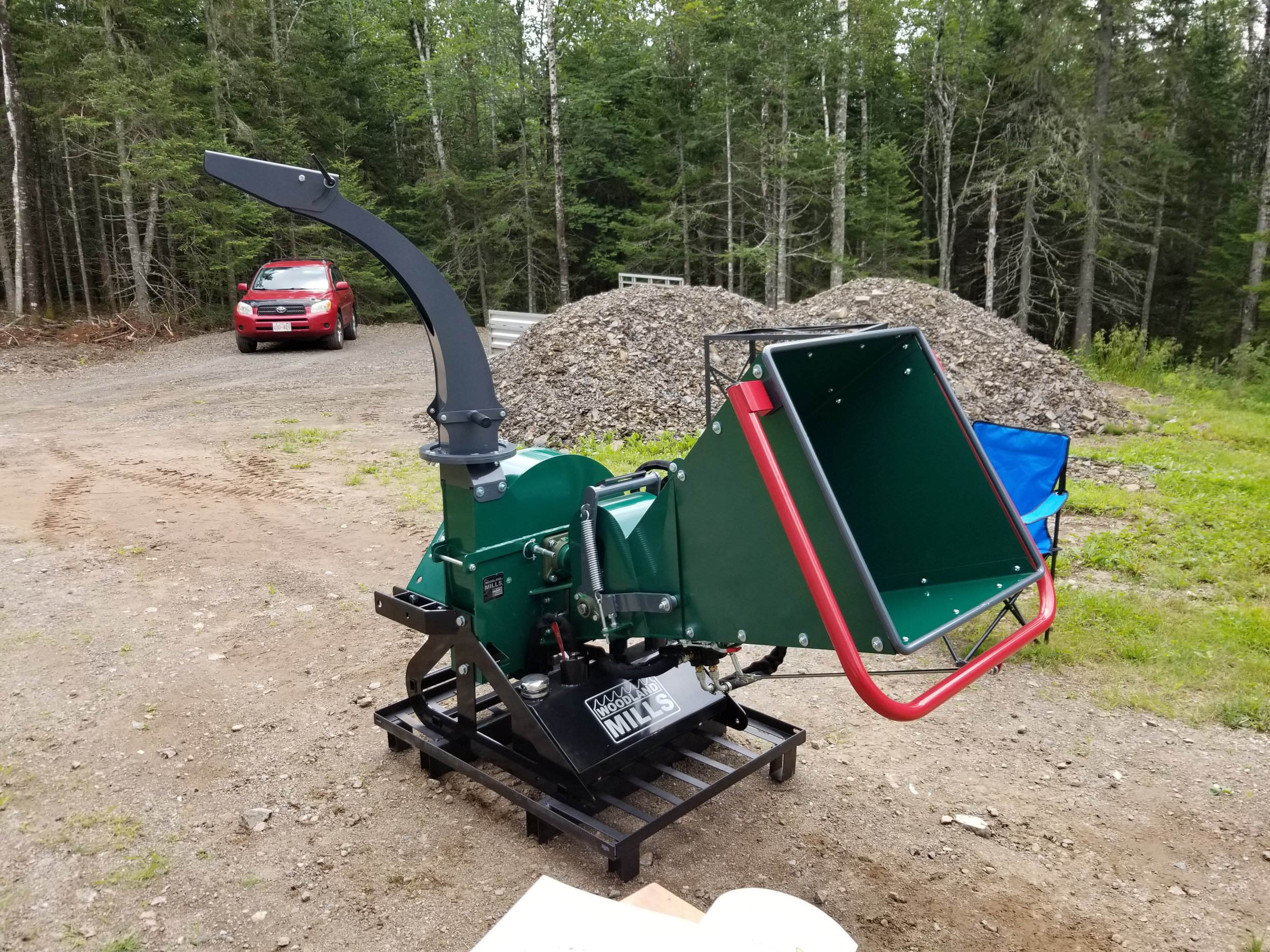

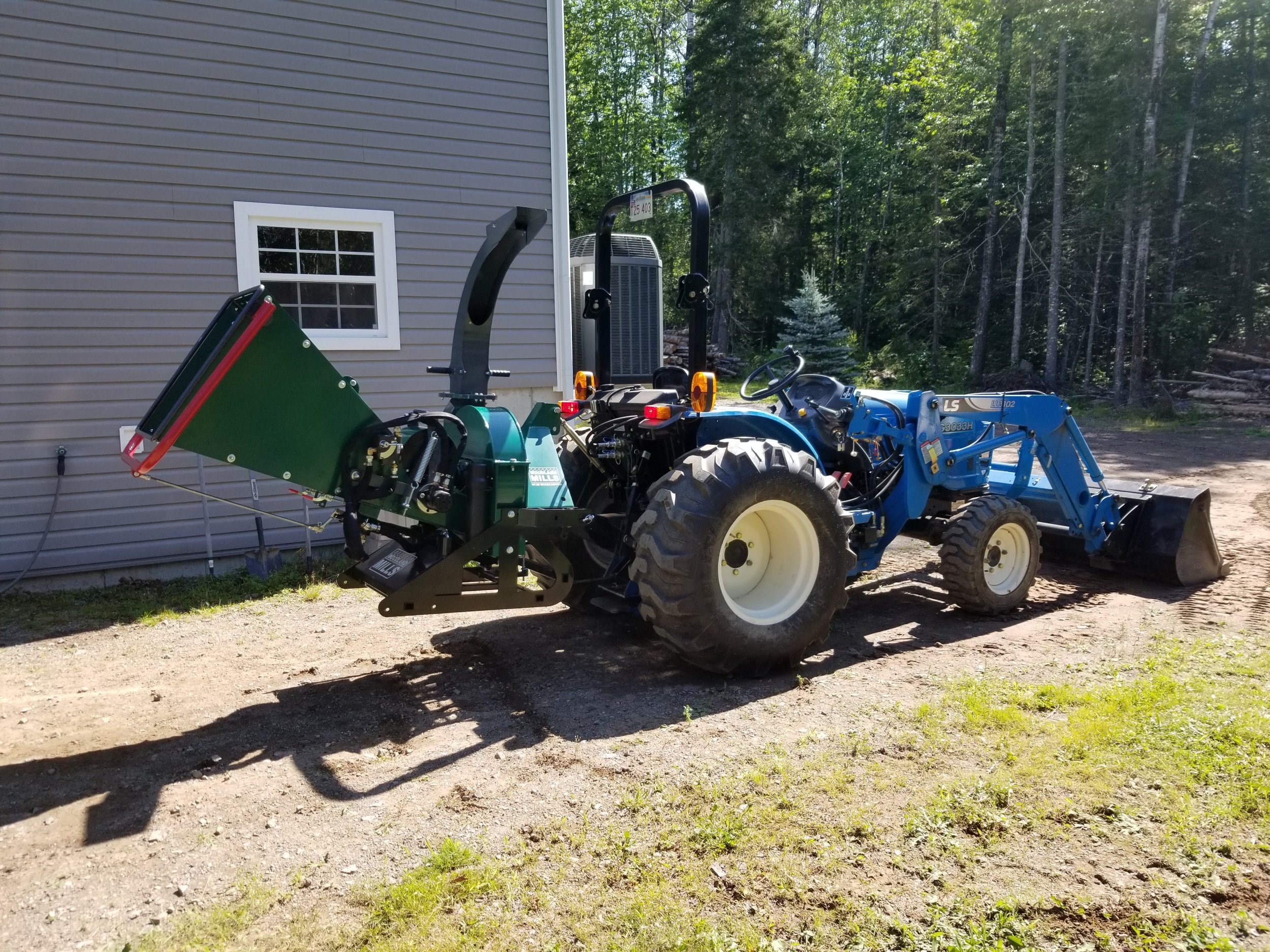

I am a little late posting this. My chipper arrived July 28 . A full 2 months ahead of the due shipping date. Fine by me. I have not had much of a chance to use it yet but the few pieces that I ran into it went no problem. It was packaged really well but it still had some noticeable dings on the paint job. I guess it will get scratched up soon enough. It took longer to put together than what I have read but that is probably due to me being methodical . (slow and steady wins the race)
What was a bummer was having to trim the pto shaft and plastic guard twice. The formula for cutting the pto shaft did not work for my tractor. I had to cut an extra 3/4 " off after the first cut did not work (I was careful with the measurements). It left me with a 6.5 inch over lap .Slightly over the minimum. Fully compressed and shoved past the locking groove on the pto shaft left me with 1/4 inch clearance to get lined up and onto the other shaft.
Other than the pto shaft the assembly went really smooth. Btw , the videos do not do any justice to just how loud this thing is. Ear protection for sure. All I have chipped so far is a half dozen 3-4 inch poplar. Anyway , this thing is super rugged and I hope to get many years of work from it . I just need to get some free time to use it !
