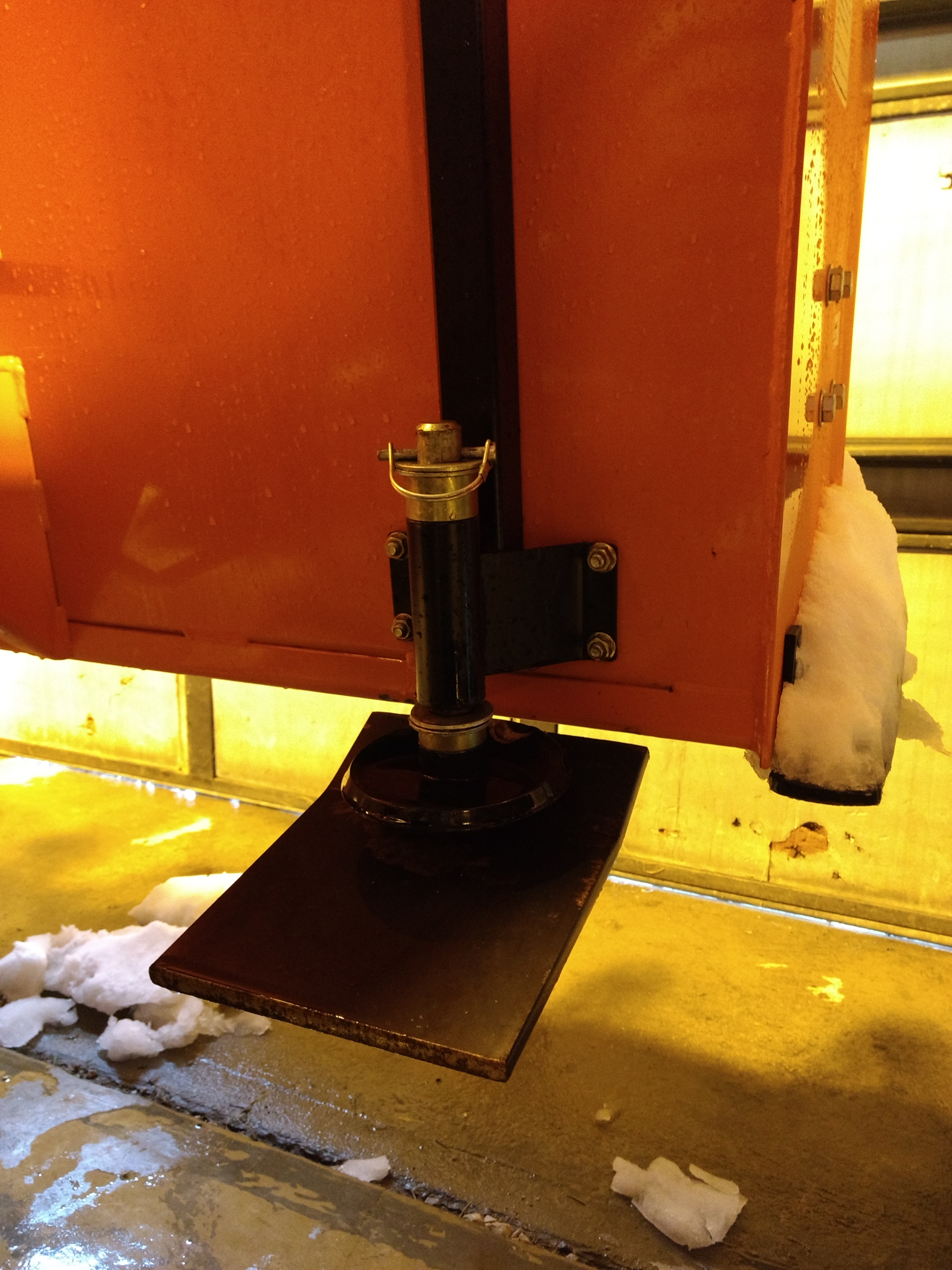

I modified the optional skids that Land Pride offered for my SB1574 Snow Blower, they work slicker than snot on a rake handle on my gravel drive. Phone pics 093.jpg

Have the same problem with my SB-60 on gravel and have been trying to figure out a DIY better skid shoe to keep from digging in the gravel drive. Haven't discovered any other solution than packing drive down with the pickup for the first few snows to create a solid (frozen) base as you noted. The SB-60 moves a lot of snow and is quiet, well built. So far I have just greased the chain before the season and haven't detected a problem. It gets a little getting use to having to turn around on the seat to navigate going backwards.
I was thinking about replacing skids with hard rubber wheels. Anybody done that?

I just got a SS-60 (olver version of the SB-60) I have yet to use it but from years of plowing gravel driveways you dont ever want the plow to touch the gravel. Until you have 2in of compacted snow/ice leave the plow up. This is what I plan to do with my blower also.
I have tried skids on gravel plowing and they seem to just dig in and destroy the driveway.
I replaced skids with 6 inch hard rubber tires from Tractor Supply. Worked good for me. Leaves about 2-2.5 inches from the ground
