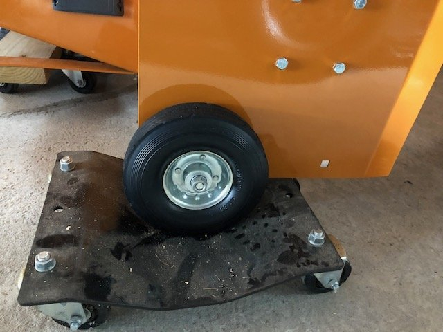

I replaced skids with 6 inch hard rubber tires from Tractor Supply. Worked good for me. Leaves about 2-2.5 inches from the ground
That sounds ideal. Have any pictures of this?
   / WoodMax SB-60 Rear PTO Snow Blower on Gravel Report #14
alexinPA, Last year I bought the WoodMaxx SB-48 and intended to adapt some casters to replace the skids. I was glad to see your reply above. Would you be willing to attach a photo or two showing how you modified the Tractor Supply rubber tires? This sounds like just what I had in mind. Thanks.

Oops...sorry. I didn't see that you already attached photos on your 2nd page. Thank you.
