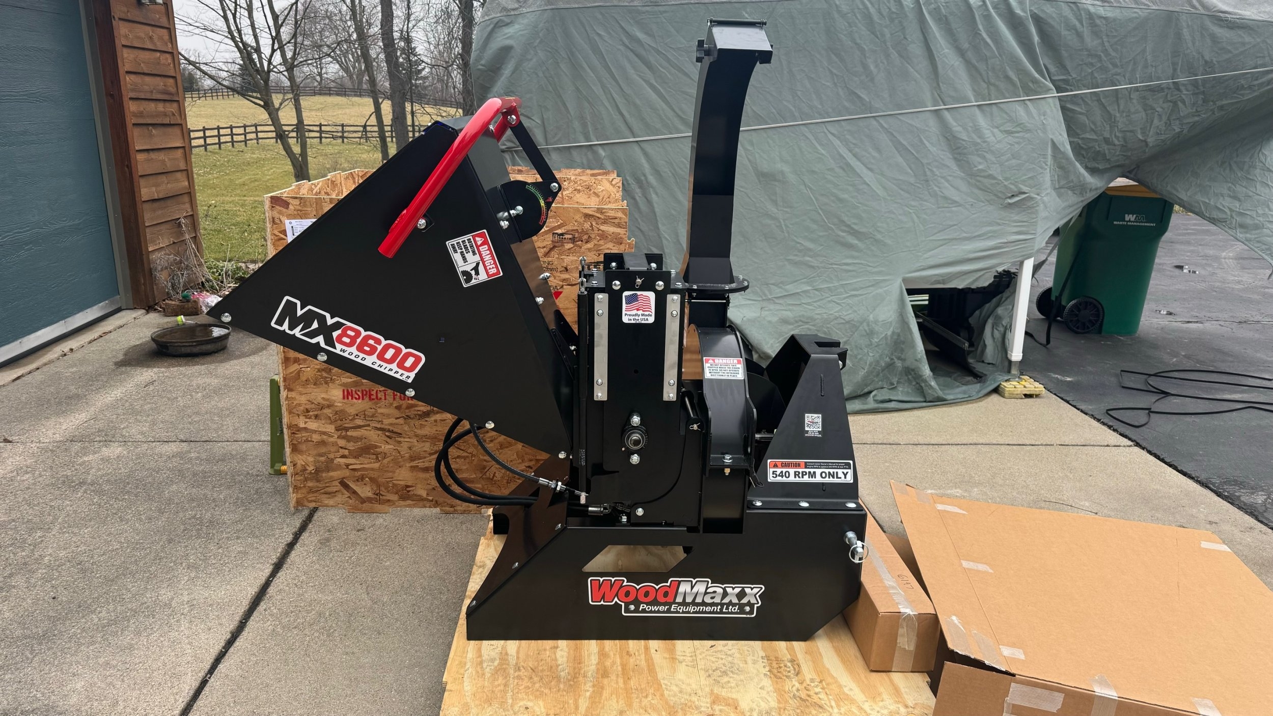

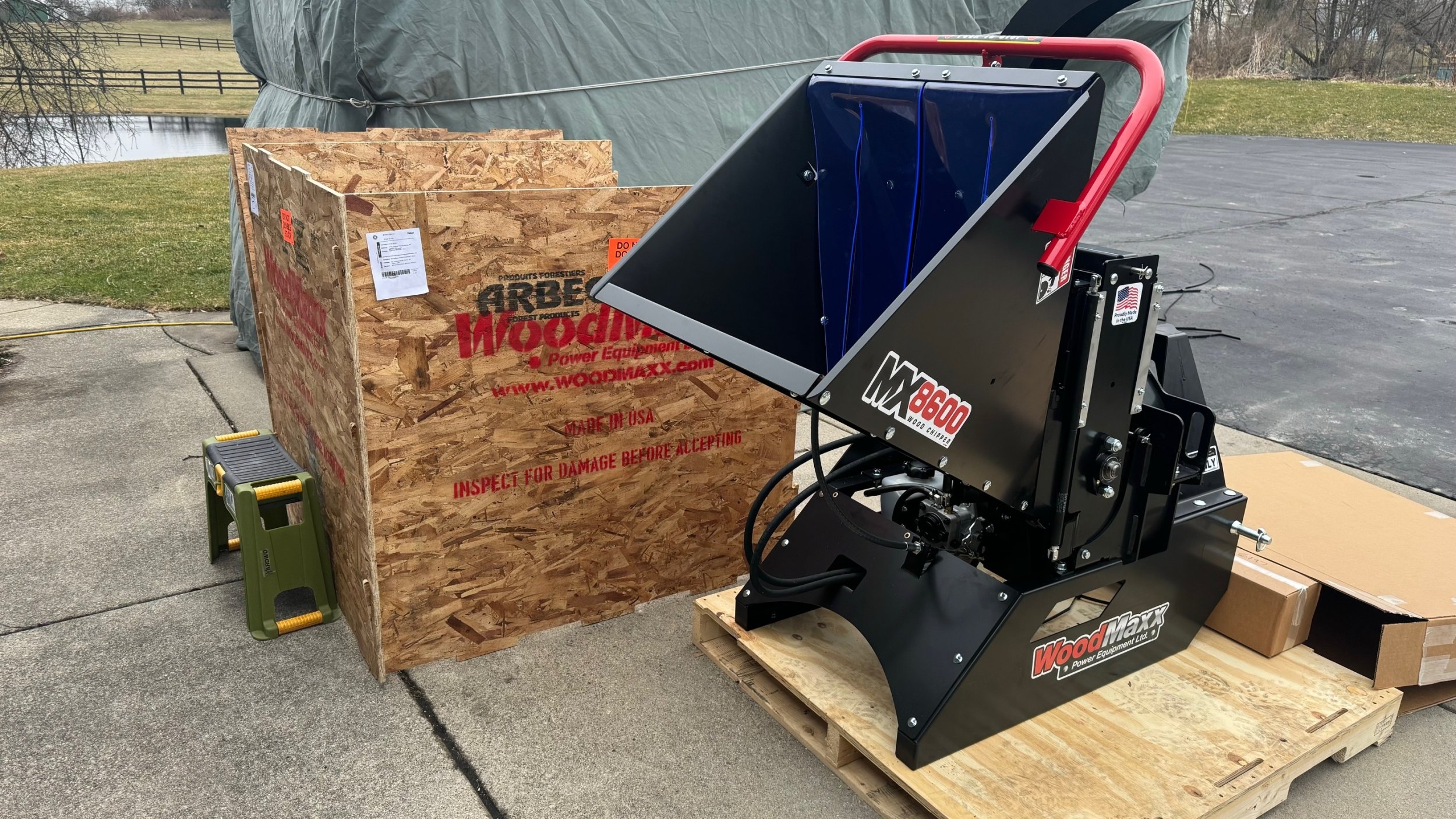

Just got this to clean up all the storm damage in the past year around the homestead. Was going to cost almost double for someone else to do it. Insurance only pays for damage to structures all other tree debris they consider maintenance. At least the insurance money paid for this. This machine is a beast behind my Kioti DK45. Chips through anything that can fit through the opening. Oak, black locust, willow, pine, and cherry no issue. Very happy with the quality and the feed system. I actually like the angled chute vs the straight approach.

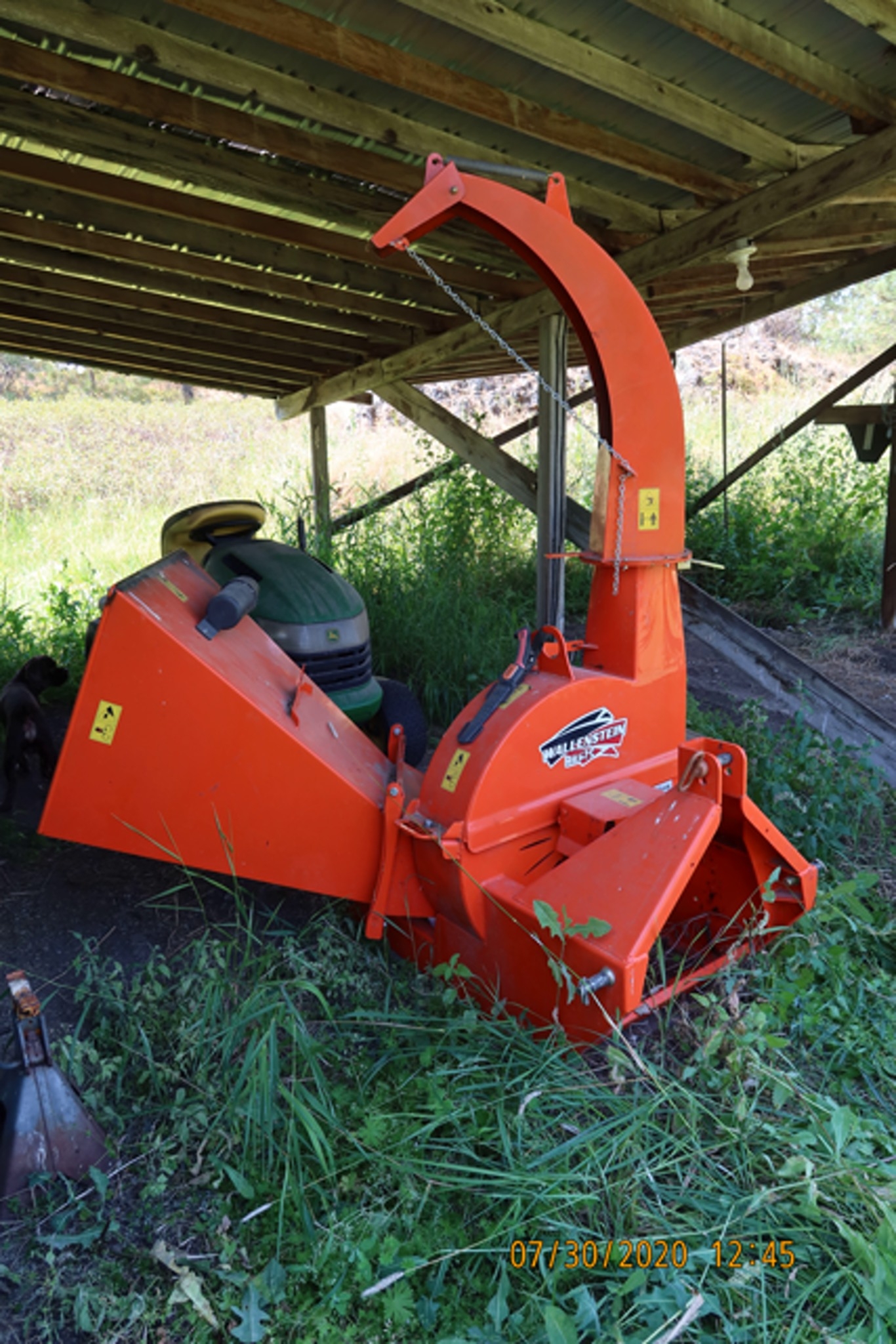

Good looking unit. Looks a whole lot like my Wallenstein BX62S. My in-feed is a tad lower than yours. When you get as old as I am - it makes a difference.
All I have out here is Ponderosa pine. I thin my pine stands - every other year or so. Pine has to be one of the easiest kind of tree to chip. The trees I'm chipping are 1" to 6" on the butt.
EXCEPT - five years ago I chipped up my old, dead, standing apple trees. Good Lord - was that wood ever hard. Put a sweat on the Wally - but it walked right thru those trees.
