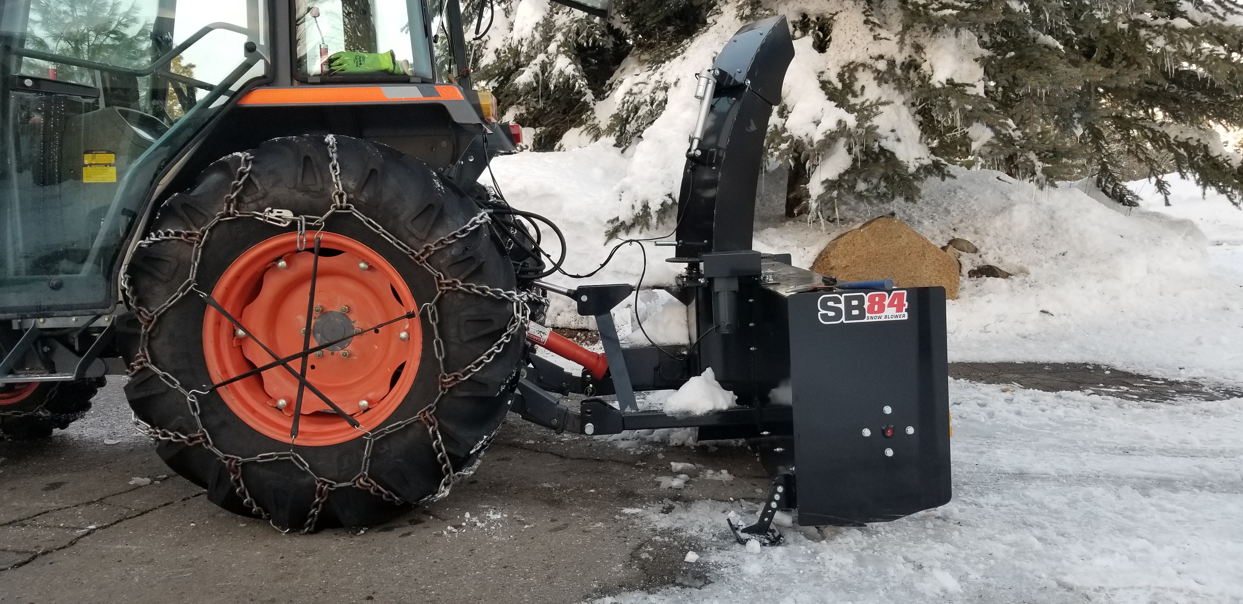

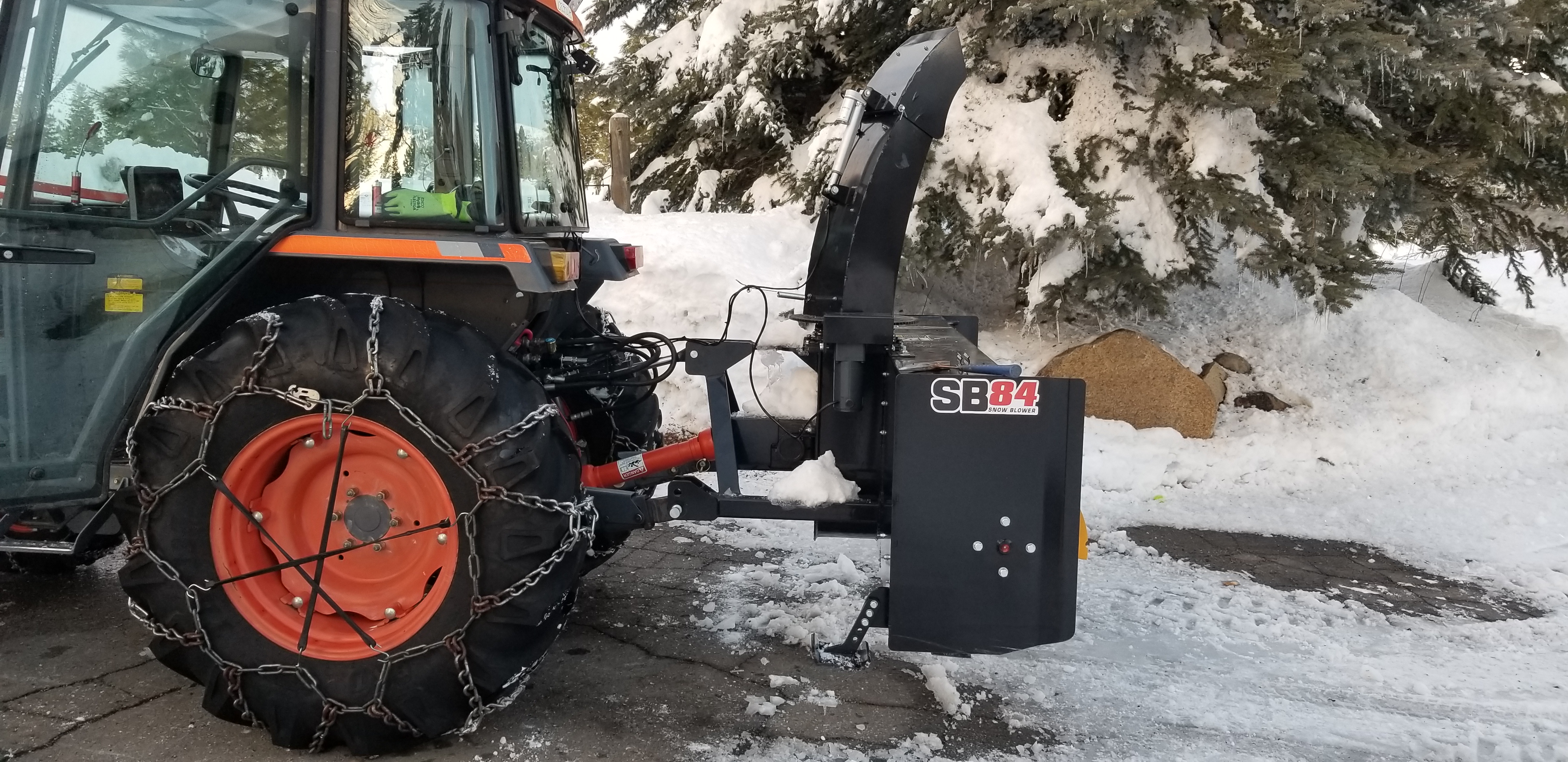

Just got done plowing in a 3' overnight dump, here in Truckee. I think I am narrowing down the issues.
In front of the draft levers are two other levers. One is for the tilt, and the other is for the top. The top lever is different from the tilt lever in that, in the summer that is the valve I pull back to open flow to my backhoe. And since I am not using the backhoe in the winter, I figured I could use that valve for the top cylinder. The problem with that valve is when it opens, it opens as either on or off and nothing in between and it stays open. One of the issues is the speed of the flow when opened- and it has been suggested that I get a flow restrictor to eliminated the shuddering when I try to feather that valve to try to slowly adjust the top. The BIGGER PROBLEM is that when I am running the tractor, and I bump that lever with my leg, it opens fully and pushes the top fully out in literally an instant, causing the blower box to shift forward 45 degrees instantly and then I hear the dreaded bolt snap. Last night I broke two shear pins by accidentally bumping that one lever with my knee. I guess I need to dig out that threaded top link and see if that solves the problem.... I wonder where it is???
I guess the solution to that is to use a threaded top link instead of the hydraulic and just don't bother with that valve.
