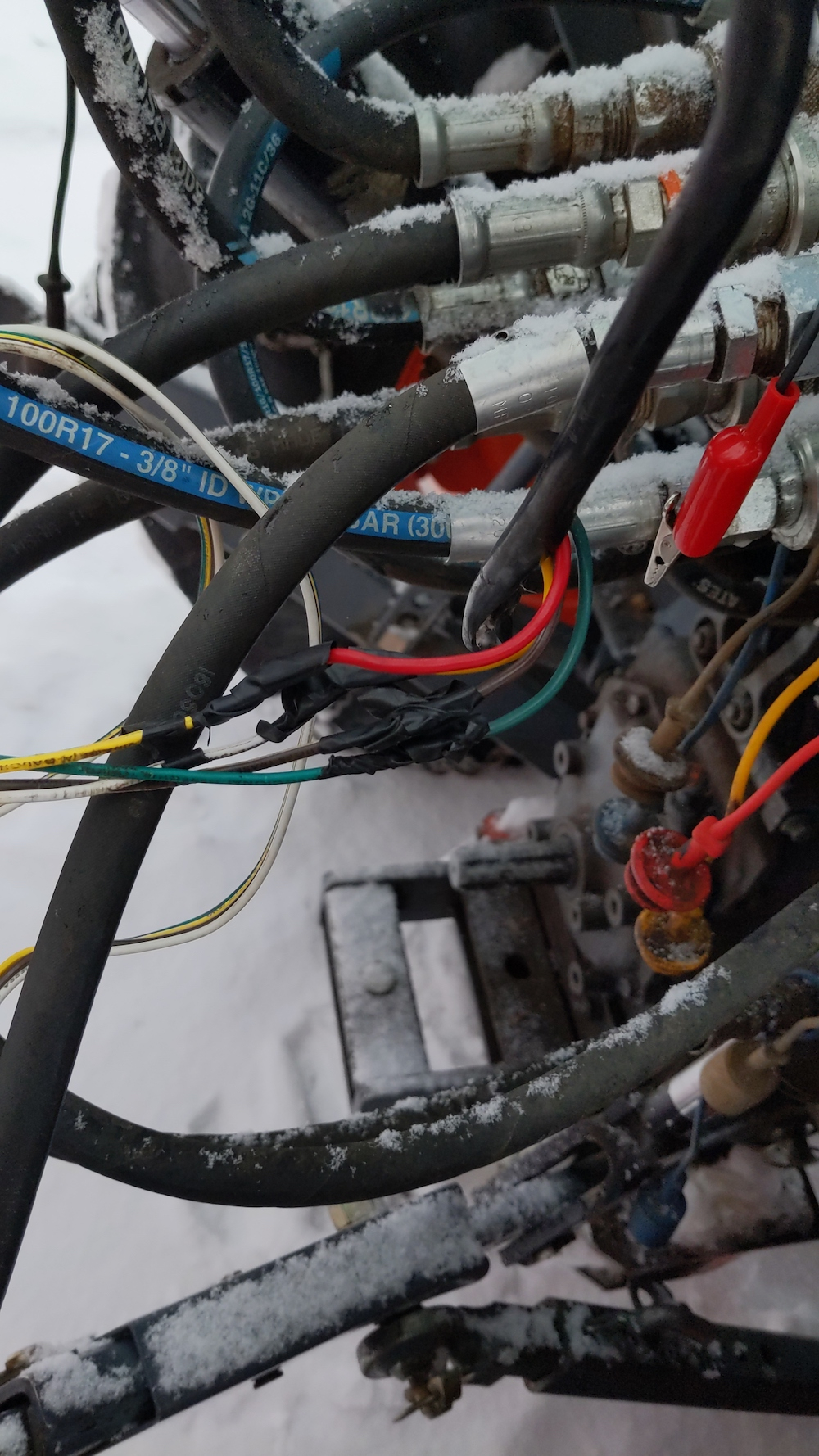

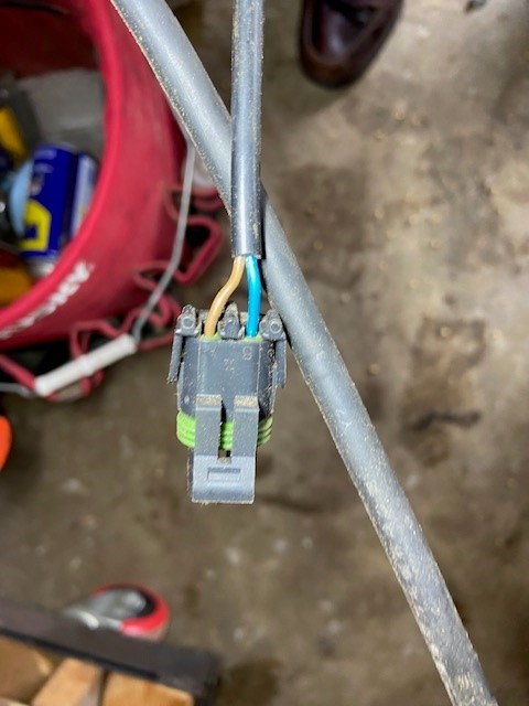

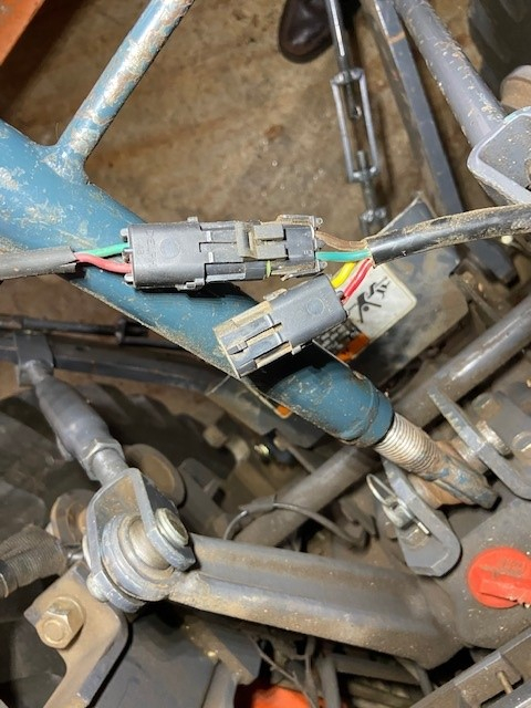

Sorry I was wrong! My blower isn't on the tractor see pics below
I just went out and hooked up the chute rotation motor and brown from the chute goes to green on the tractor, and green on the chute goes to red on the tractor side. The chute works/rotates.
On the deflector Blue from the deflector goes to yellow on the tractor, and brown from the deflector goes to red on the tractor.

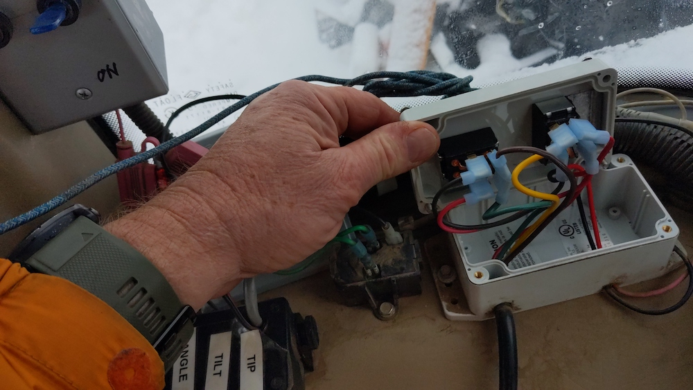

Here are photos of the wiring.
