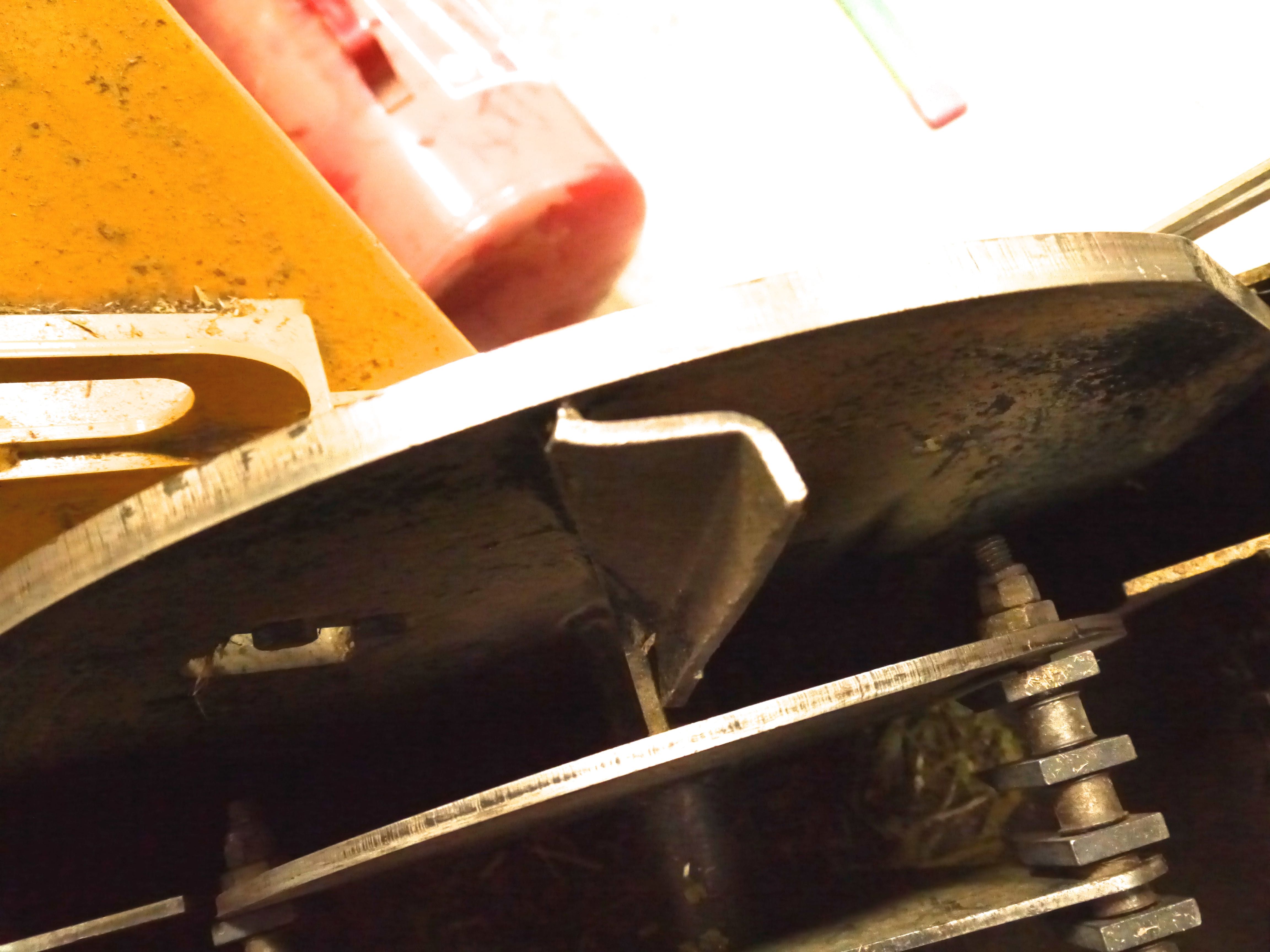

I have owned a Wallenstein BXM32 Chipper/Shredder for several years, and it has been a constant source of frustration. It is used on my Kubota B3030 to chip and shred primarily green Bay Laurel (a hardwood) in a 40 acre Conifer forest, as we do "thin & release" work. It is slow, and clogs frequently. Mechanical problems are an ongoing problem, and I believe it was poorly designed for this work. Wallenstein has refused to help, and blames me for it's problems. The flywheel flanges that expel the chipped/shredded material have become extremely distorted and it seemed the only path was replacement. Wallenstein (while the unit was still in warranty) said I must have feed it rocks and refused to take responsibility! I was able to reform/bend and reinforce them, but it still clogs frequently.
Thus I am looking to replace it. Would the WoodMaxx TM-86H be a good choice? Are there any TBN readers with experience with these machines who can offer an opinion? Is the WoodMaxx TM-86H likely to be a superior performer?
