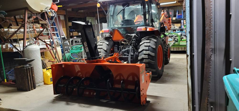

Actually Woodmaxx has been out of stock since this summer & just got a batch of snowblower in last week (got the in-stock notification finally). Doesn't look like they have sold out yet.
Dropped the L4060 off at the dealer for leaky front axle seals & saw 2 blowers on the lot. Got a quote & he verified at least one wasn't sold yet.
The Woodmaxx is $2k cheaper, hair bigger auger (if that means much) & a HDPE lined chute, made in China. 6.75" deep fan. 755lbs
The LandPride is 2" wider, made in the USA, probably has better parts & support. 8" deep fan housing (may or may not mean fan itself I suppose). 545lbs.
Fan diameter, number of blades, chain size, QH compatibility & most other specs seem to be pretty much equal.
LandPride is a hair bigger but lighter, which isn't great if we assume weight equals strength. Really torn if I should shell out the extra $2k for a possibly lighter unit with better support.

I have the Woodmax 84". It's a beast. Yes it's got metric fasteners. It is not a Comer gearbox. Not sure what your point is on knowing what the ratio is? It works fine as is. The shoes are adjustable. I made oversize ones for mine.
It's a lot of blower for the money. Yes it's made in China. I had considered one but was hesitant until another guy at work got one and it was delivered to the shop so I got a good look at it. I was impressed. Good quality welding. Heavy made. Nice paint job. I have no complaints. I understand the buy USA made, and normally I do. I haven't kept up, but I thought Woodmax was going to start making some of there stuff here?

Lol, I own a Kubota tractor, Peruzzo flail mower & 3 Fords built in the past decade. Everything is already metric anyway.
All gravel/dirt roads around here & lots of freeze/thaw in Colorado. High of 90 with over 1" of snow has happened at least once on the past few years. Makes for snow covered mud, which sucks compared to you people that count on the ground freezing solid all winter long. Likely I may have to make wider shoes or skis or something.

We have similar conditions with snow over mud and almost never having a base that would hold up a blower or blade. The shoes, or skis, I have on the Woodmax are 8"x12".

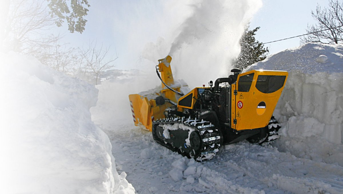

The Mconnel single stage snow thrower in the second image is driven by high volume a hydraulic system
on the robomower in this photo. The Mconnel single stage snow thrower uses a roller chain drive using a
hydraulic drive gear motor.

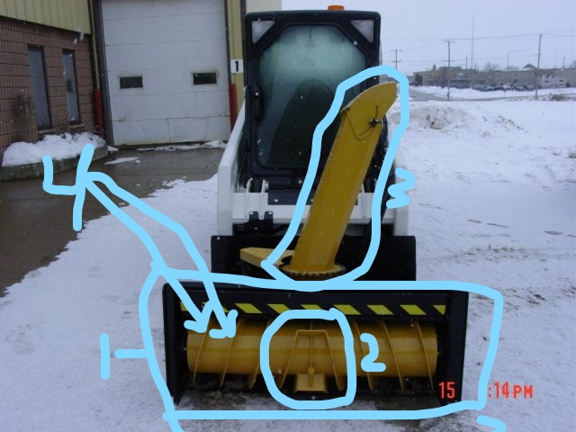

The third image is the front view business end of the mcconnel/robomower single stage snow thrower.

Whelp, looks like I successfully warded off snow this winter. The region is going to hate me as we badly need the moisture.
$5,700 plus tax out the door. It's missing the hydraulic deflector. But if I can't remove & reinstall 2 cotter pins & 2 pins to mount it when it comes in I seriously need to reevaluate my life choices.
Wanting it now played a big part as I was picking up the L4060 from the dealer today (leaky font axle & apparently rough bearings). So I guess that goes to supportability too.
