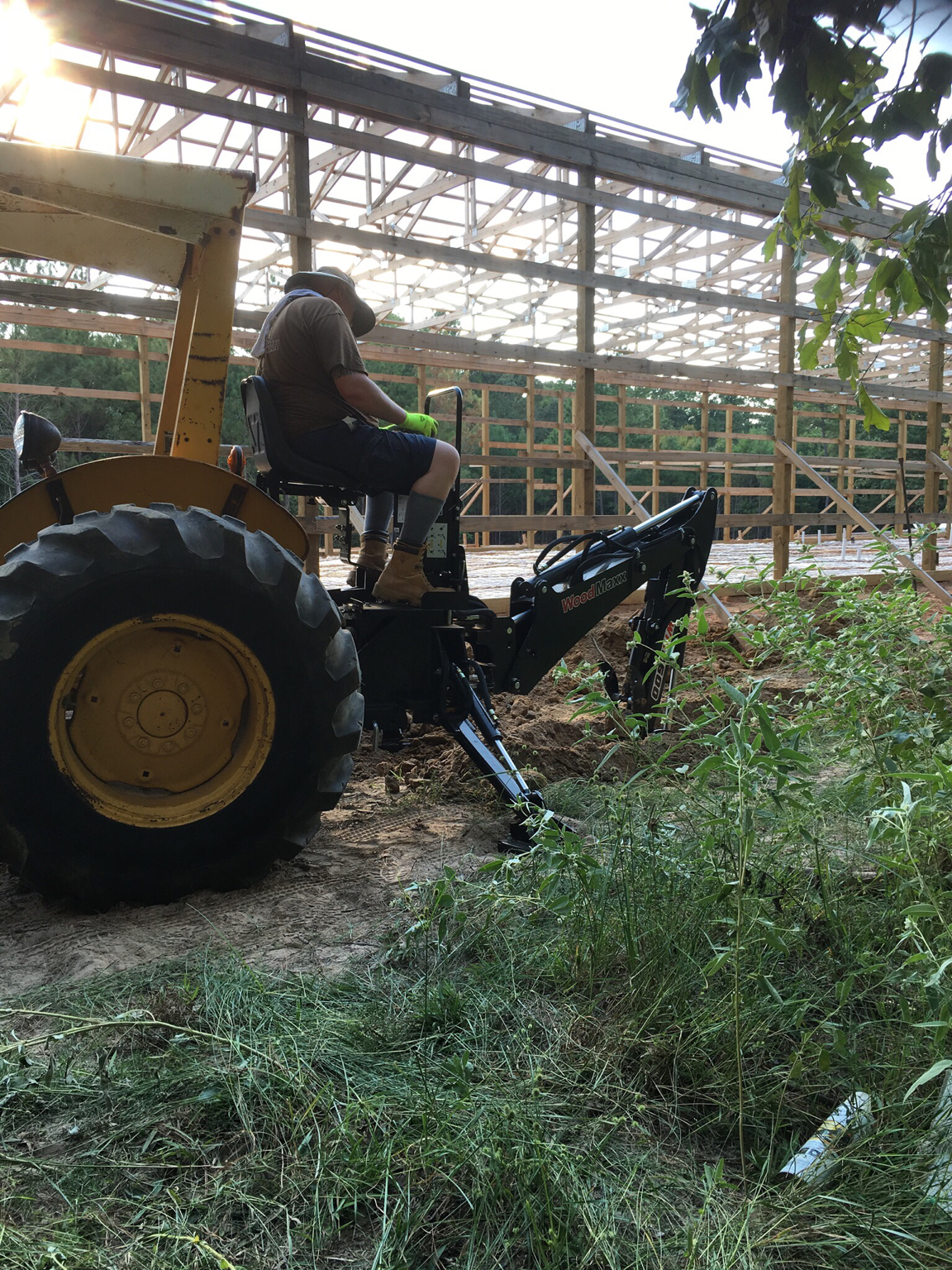

I wanted to share my experiences with my WoodMaxx WM-8600 3-point backhoe.
This is the big backhoe they sell, digging depth is 9' and weight with bucket is 1,150 lbs. I've using it for hobby-farm and light construction, strictly personal use.
I'm running a mid-90s Case IH 495 utility tractor. About fifty horse power give or take, MFWD and 6,000 lbs not counting the filled rear tires and front loader. The backhoe is recommended for 25-60 hp.
I had never run a backhoe or other digging equipment before hooking this guy up and trying it out. I'd never run a tractor before reading the manual and jumping on my tractor either. So not a lot to compare to here but I can share my experience with this specific equipment.
I looked at dozens of backhoe models. I researched the factories and designs of these machines and looked at other vendors selling the same product from the same over-seas supplier. I knew I was going to be on the low-end of the spectrum and wanted the biggest one I could get as a 3-point model. There are slightly cheaper models out there, but they were really sketchy eBay specials and that sort of thing. While there were other models and builders I would have gone with, WoodMaxx addresses the short comings of many Asian built machines by installing high quality Italian hydraulic controls. WoodMaxx has developed a sterling reputation and they have exceeded even that for me.
I wanted to have the machine for a year before providing this review, I ordered and received the machine last February. Total was $5,600 including a 15 bucket, PTO powered hydraulics, stabilizer pads, ripper, and hydraulic thumb. I had wanted yellow, but black was all that was available. I don'd care one bit about the color of my implements. They all end mud colored.

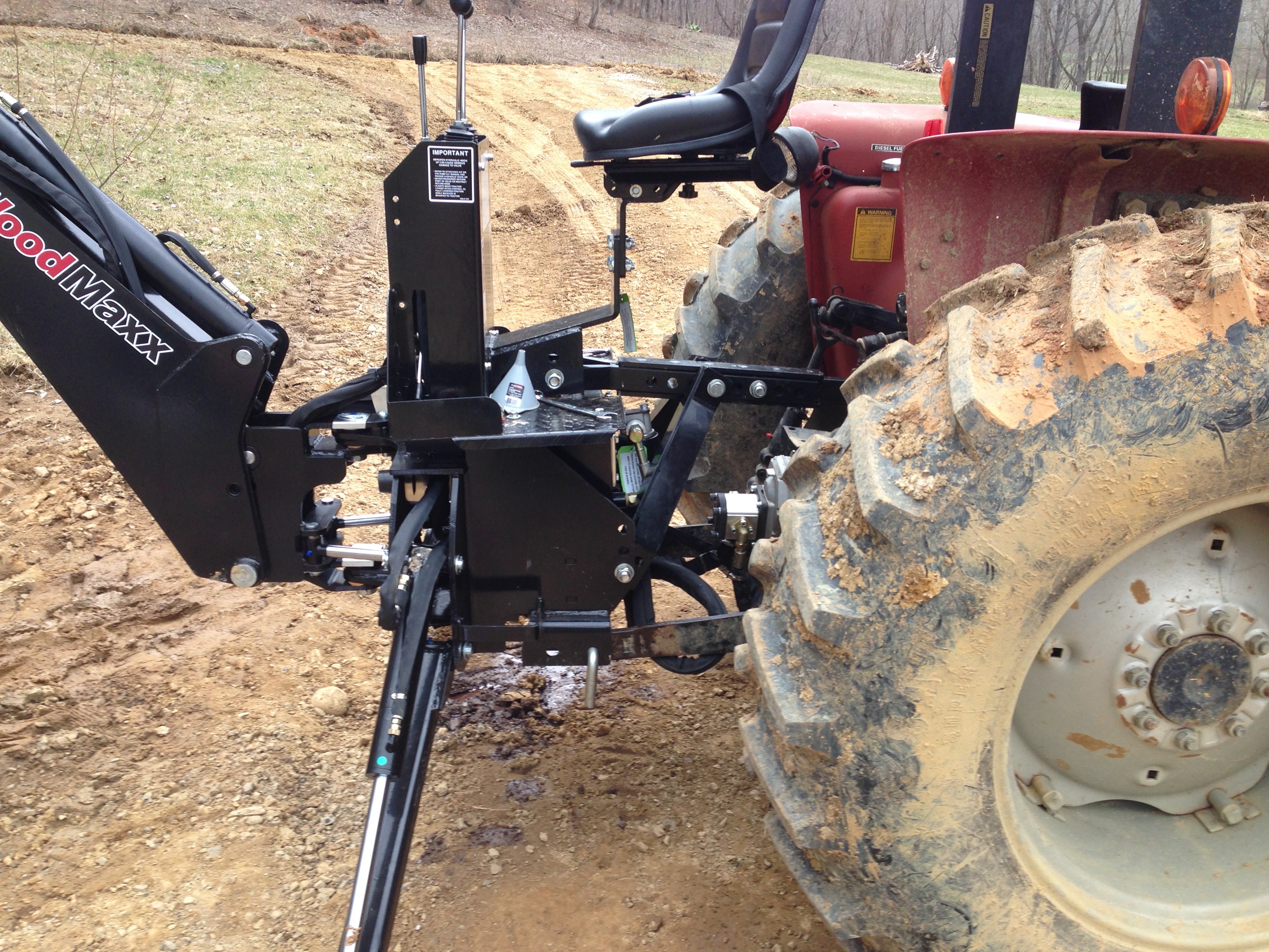

Setup was decently easy, I spent two slow afternoons getting things together and running. The only issues I encounter in setup were lots of loose connections in the hydraulic valves and tank. About half of them sprayed fluid under pressure so I went over them all. A set of offset hydraulic wrenches were an absolute must here.
Being a 3-point setup the connection to the tractor isn't rigid when riding around, it can bounce around a good bit, this is a fine trade off for not needing to fabricate a subframe and the ease of attaching and detaching. So far I've been setting it down outside with my other implements until I can build an implement shed. Hook up involves backing up, attaching the PTO pump and using the machine itself to get it into position for hookup.
I have read all the warnings about 3-point backhoes being prone to breaking the 3-point connection and taken them seriously. My tractor has a Cat 2 hitch and I've watched everything carefully and feel confident in the setup. The backhoe is powerful enough, the tractor weighs enough, and the connections are robust enough I am confident in the strength of the setup. I believe the weak point to be the top link pin on the tractor side. It's a Cat 2 pin reduced to a Cat 1 diameter to accommodate the backhoe's integral top link connection.
I have observed the top link pin beginning to bend slightly after a lot of digging, not enough to bind coming out but it isn't perfectly straight. If anyone can recommend a top link pin that is high strength that would be helpful. The setup on the Case is a Cat 2 diameter pin hole on the right side, with a Cat 1 diameter pin hole on the left. It uses pins machined down at different points to take either a Cat 1 or Cat 2 pin. Maybe this is an excuse to get a lathe. The top link member on the backhoe would need to be machined to accommodate the larger pin so I think a high strength steel Cat 1 diameter pin is probably the best way to go.

Setting up to dig I've been following the rules. Stabilizers go down enough to feel solid but not enough to lift the tractor wheels, loader goes down in the same way. Wheels on the ground all around. This has been very solid; the tractor hasn't ever been pushed around. On a few occasions digging adjacent to trenches or other difficult areas I've very carefully dug with only one stabilizer down and that has been okay. I would like the stabilizers to be longer, big tractor here, the backhoe rides higher than it is probably intended.

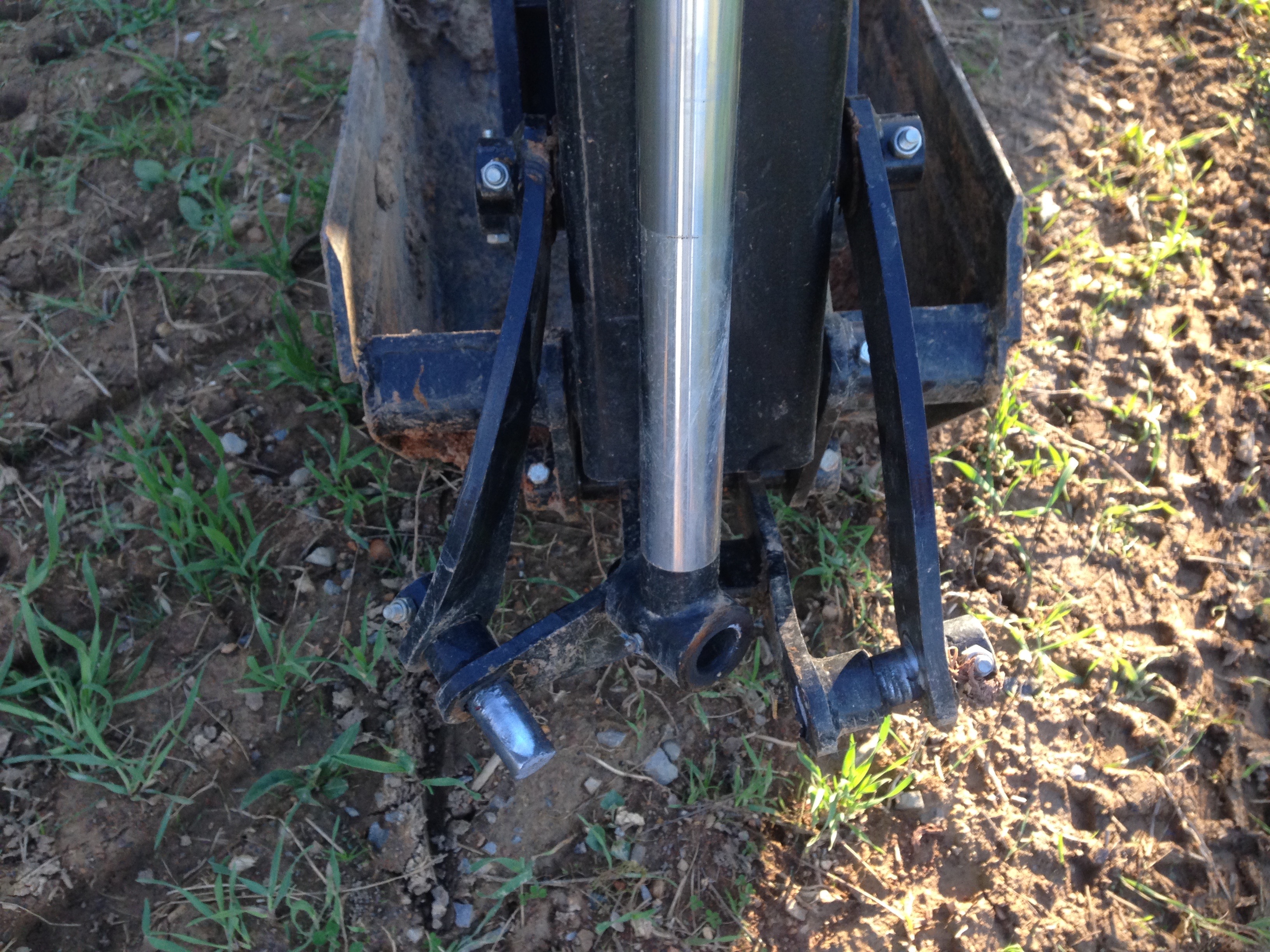

On the problem side, and I expect some sort of problems on any sort of small-volume, mechanical system. Very quickly I had one of the bucket pins break in very light use, it was just clearly way too soft. WoodMaxx had a new one to me immediately. The thumb teeth begin to spread outwards and the pin holding it also bent enough that it needs to be cut out. They also sent a new Thumb and pin. Customer service has been excellent, couldn't be better and hats off to them for their support. WoodMaxx is better than it has to be.

I've dug stumps, excavated a foundation and footing into a hill side, dug a few hundred feet of sewer line, made some nice planting holes for trees, pulled and moved big trash and other stuff with the thumb to load onto trucks and trailers, and probably a bunch of other stuff I'm forgetting. Once I dug a hole as deep and as square and smooth as I could just to try it out. I was able to get to six feet deep with a nice square and smooth hole without moving positions.
