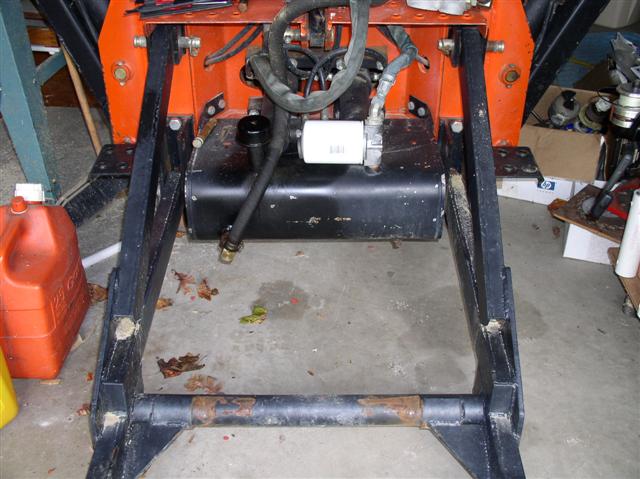

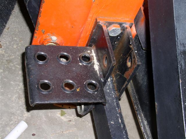

Ctyler,
Do you have the BH9000 on a subframe? How far back from the rear tire is the backhoe mounting plate? (The subframe should mount to six bolt holes on the backhoe. Please let me know this inside distance from that plate to either the rear axle, or the rear tire surface including tire type.
I am looking to findout the differences between the 3130 subframe (woods pn 1006837) and the 3 point subframe (woods pn1001199) that my tractor (L2900) uses.
Please post a photo of the hoe sitting on the rear of the tractor.
Thank you
Design
   / Woods 9000 BH - multiple piston movements? #12
I can give you a Acad file of the subframe I built for my 9000. I had a 3PH mount and it worked fine but was starting to wear the top hitch pivot on the tractor and it also scraped the ground when backing from a trailer so I made the subframe with a 3" rise to it. I also made the subframe pin to the hoe so I could remove it for extended storage. Otherwise it takes up alot of floorspace.
   / Woods 9000 BH - multiple piston movements? #13
The ACAD file would be great. I am working on a solidworks file for a 4pt hitch for the 3130. after the file is complete, I will set if I can modify to fit my tractor.
