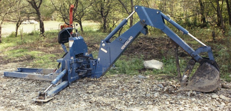

I don't think mine is better than yours, just different. At least you can replace your teeth on the thumb. Also to adjust the angle and stowing of the thumb on yours is easier. I did put it to the test last summer with about 70 hrs of feild stone work with the hoe and thumb. I attached a photo of my backhoe looks similar to the woods. It's a New Holland hoe, claimed to be made in the USA, by who I don't know. The mounting are similar too. A mouth under the drawbar and two pins on the brackets underneath the loader arms.
By the way nice looking hoe, mine was ONCE that clean and scratchless.

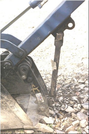

A better picture of the thumb. The yellow thumb linked before was a picture Attachment Sales e-mailed me before I bought it. I cost $550 and I had to weld it on myself.
