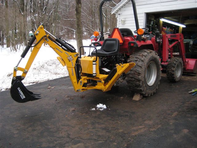

   / Woods BH600 on Mahindra 2615? #15
Yes, thanks for sending along the pics! Here is one of them for the others to share. I did have to resize this pic to upload it.

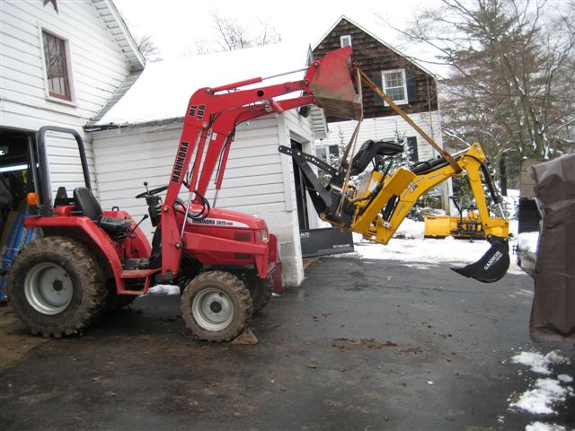

#16
Got the BH home thursday night from Maryland. Here's a pic unloading it today.

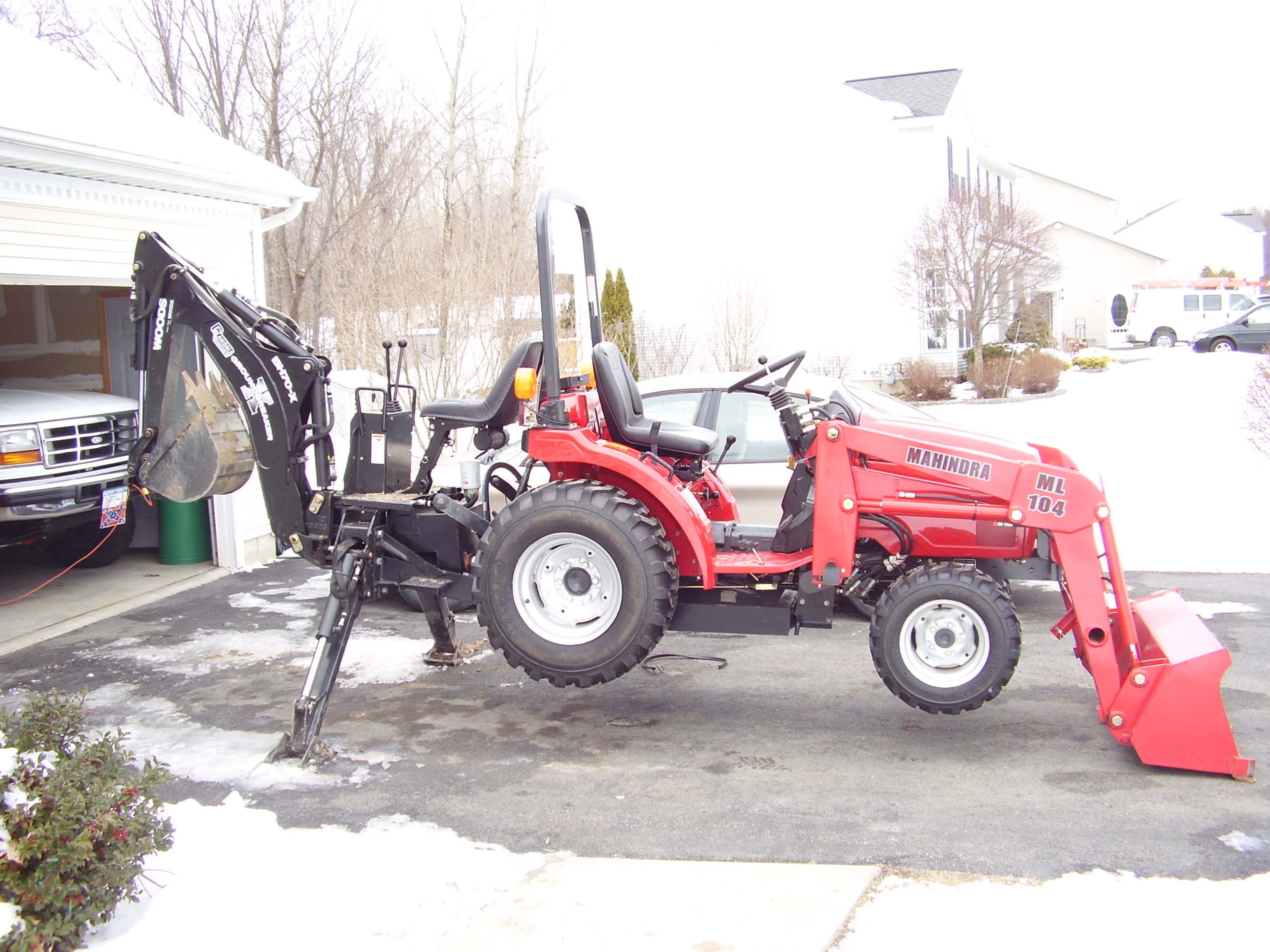

#17
Got it mounted on the 3 PT hitch, but no Hydraulics yet. Need a few fittings and my nearest TSC (only place open on a weekend) barely has crap for hyd. Have to go to the local Hydraulic shop monday or tuesday.

   / Woods BH600 on Mahindra 2615? #18
Looks great. Now all you need is a thumb, and a subframe. DON'T FORGET THE SUBFRAME!!!
   / Woods BH600 on Mahindra 2615? #19
Nice backhoe !! I wouldn't worry about the color being yellow....... it sure isn't any worse than my New Holland blue BH6000 on my red Yanmar or my orange Kubota !!
