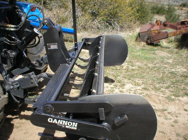

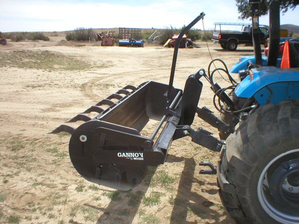

For a cab tractor, you would probably need a rope and have it go through the back window to pull the lever to roll the box over into its 3 different positions. Now the rope does work, that is what I have used on my bigger tractor, it is hard to reach the lever on a bigger tractor. The rollover box blades were designed for use with tractors that did not have rear hydraulics which were not all that common back in the 60s.
As far as the uses, the rippers can go in a full 10". A std BB rippers go in about 4-5" I believe, while a bb with hydraulic rippers will go in 10" also.
Flip the rippers up and you have the use of a BB. Roll the box over so that the blade is in the reverse pushing position and you can push material in reverse without material falling off the sides. Very good at moving material in reverse without loosing a lot of it like you do with a std type BB. Now with the blade in the reverse position and go forward and you have a heavy implement that does an excellant job of smoothing material out.
I hope that some of this helps, while the rollover box blades are very good in my opinion
/ Woods box blade? #14
I thank you booth for your input but it is very conflicting. I have zero knowledge about a roll over box blade so I am very green to those, have to start researching I guess. The BB i was looking at was just a regular 72" medium duty, and it was priced at $1100 which I know is high but Canadian pricing, it has a floating tailgate which I'm unsure about and 72" is the exact width of my tractor, so should I go wider. I go in the next few days to talk to the salesman and actually get to see the product so hopefully I'll know more as well. I plan on being nasty to this box blade so maybe HD is the only way to go.
Any more info on the rollover version though is apperciated, I haven't even heard of one of those up here.
The rollover box blades were first made in the 60s I think. They were used a lot because most tractors did not have any rear hydraulics back then to operate any hydraulic rippers.
The rollover BB has 4 uses.
1st would be as a box to drag material or to cut away material from a site.
2nd would be to have the rippers down to loosen the earth that needs to be moved.
3rd would be to have the box in the reverse direction to move material in the backwards direction. the rollover BB works very good for this since it has the sides of the box to help with any material falling off to the sides as it does so easily with a standard BB.
4th would be to move forward with the box in the reverse direction, this smooths material out very well.
The positive things of the rollover BB vs a standard BB is that the rippers can dig in 10" while most BB rippers only dig in 4-5". Plus you can be in the ripper position in seconds without getting off of the tractor while with a std box blade you have to get off the tractor and lower each ripper separately.
Using a rollover BB in reverse you are able to move more material because of less loss due to the sides of the BB. But with a rollover, you can not get as close to a wall to back fill as you can with a std box blade.
The forward use of a rollover is pretty much the same as a std BB except that with a std box you can rip and move dirt at the same time were as you can not do that with a rollover.
In reality, a hydraulic activated ripper box blade is probably the best box blade that you can get. But in my opinion, the rollover box blade is superior to the standard type box blades. I have been very happy with both of my 66" & 81" Gannon Rollover Box Blades. :thumbsup:

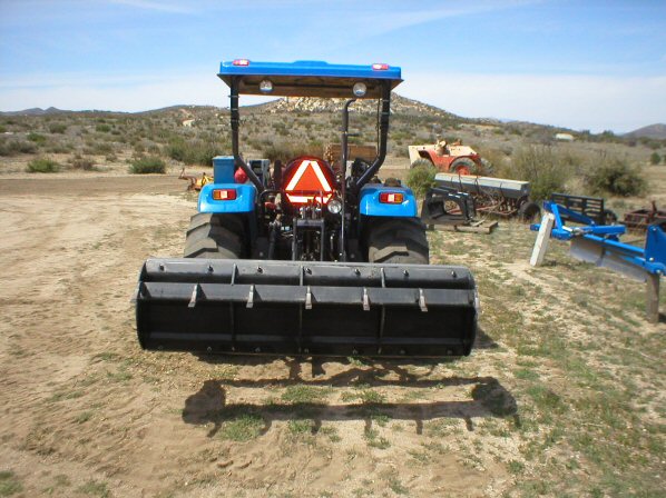

/ Woods box blade? #16
I bought a new medium duty BB last year. I debated between the 7' and the 8'. My tractor width is 6'. I went with the 7', that gives me 6" on each side, which is good. I'm glad I didn't go bigger as it would have gotten in the way when using it on my trails in the woods.
As for the ability of the rollover boxes to go deeper with their rippers, well I've always found that I lose traction sooner or later with rippers only a 4-5" deep. I can't imagine using rippers 12" deep in a heavy clay/rocky soil. If I had sandy loam, it would be different. But I don't.
In my experience, there is a big difference between light duty and medium duty. For most of us, I don't see the need for "heavy duty" and the added cost. Prior to buying the bigger one last year, I had a 5' bb that I bought used ten years ago. It was probably medium duty for it's day although the 3 point hitch isn't as beefy as new ones. But it never bent or broke no matter how I used it.
