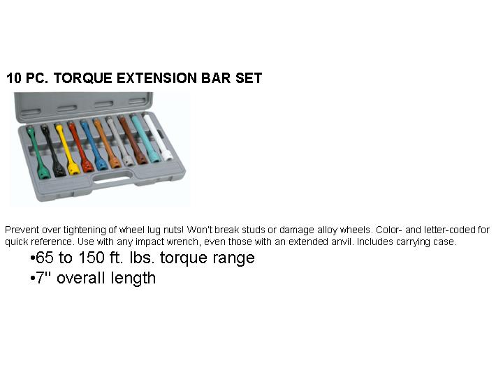

What about using a set of torque adapters with your air tools? These have probably saved me alot of aggravation time.
