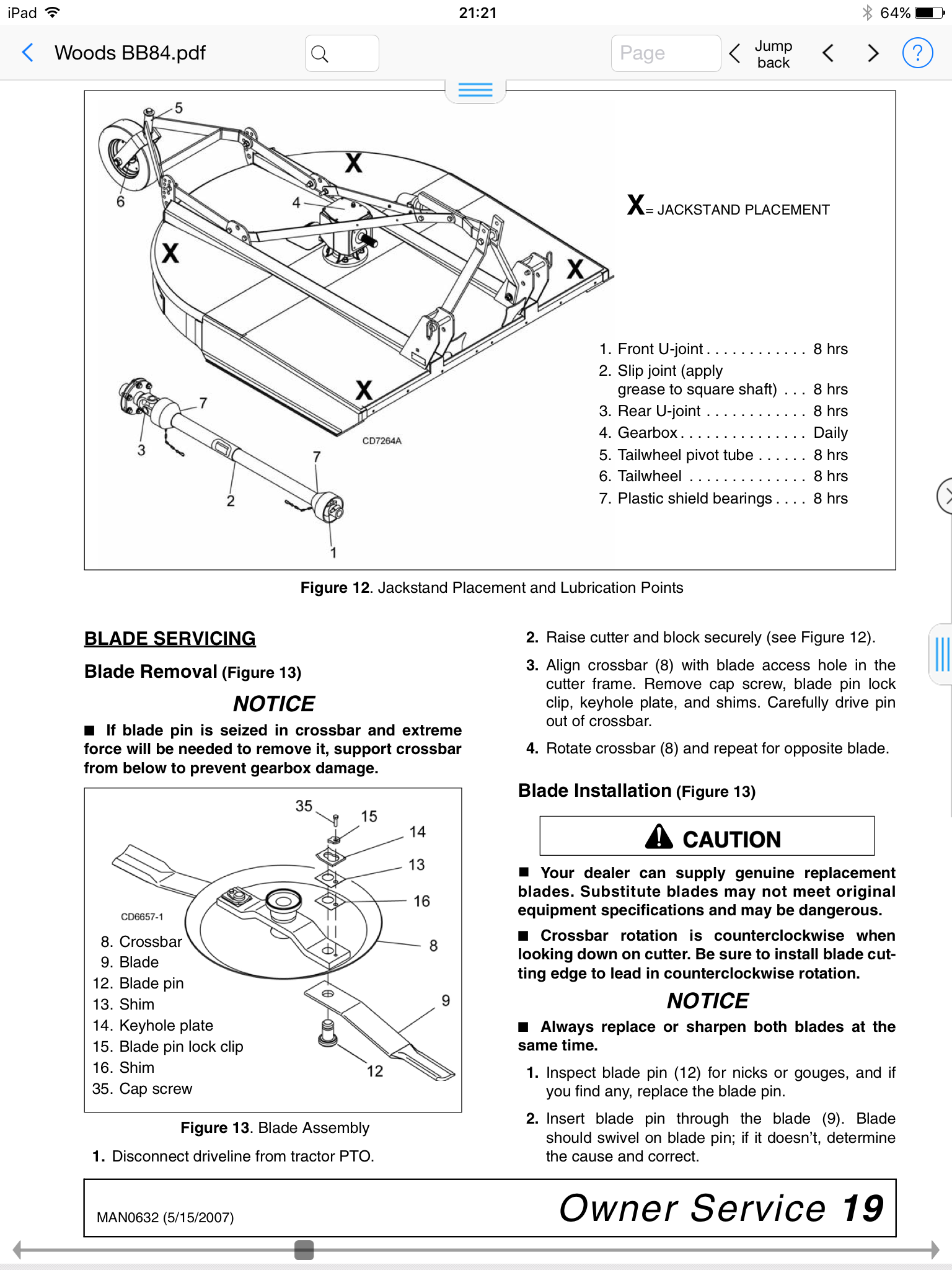

Trying to remove blades. Are they Left or Right threads? Pretty rusted so got them sprayed down with liquid wrench. Don't want to turn in wrong direction.
   / Woods Brushbull BB48 #2
Mine Woods BB is accessed from the top through a hole, maybe yours is older? Here is a screenshot how mine are removed.
   / Woods Brushbull BB48 #4
The cap screw (35) is a standard thread, you have to drive the blade pin out, read the notice about supporting the arm so you don't damage the gear box.
   / Woods Brushbull BB48 #5
Did yours have a blade pin (mushroom head) on both top and bottom? All I need to do is drive that out? Already removed the threaded bolt and the shims.
At this point I was going to just try to take the crossbar off and sharpen the blades all as one.
   / Woods Brushbull BB48 #6
My older m4 should be the same, once the shims and retaining clip is out the pin should come out, however mine required a drift, hammer and air chisel with a drift attachment to get them out.
Oh and a good soaking with PB blaster.
