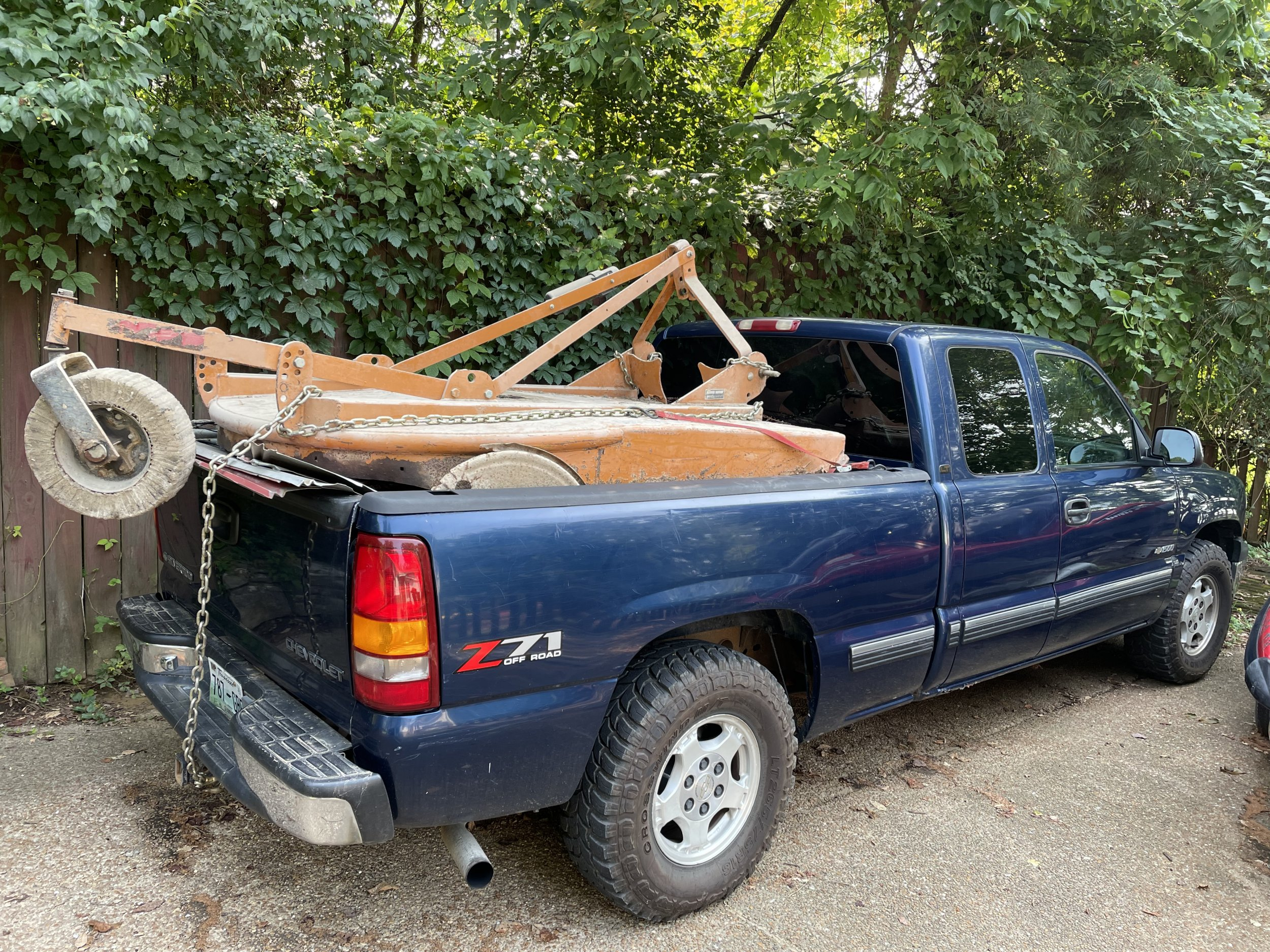

Saying goodbye to my 2007 Woods Brush Bull (BB60C)…. Woods are great implements… but these had a design flaw… the deck under side had reinforcing sleepers that hung down about 2 inches below deck…. Causing gear box shaft to extend down extra 2 to clear… this extra length in the shaft made it sensitive to any out of balance… and it ate the lower bearings…. I planned to rebuild… but Woods stopped making the gear box and made some conversion kit (very expensive)…. My RD7200 Woods has been much better with spindle rebuild and bearing kits easily purchased…. I like Woods…. But I’ve paid the price for their engineering mistake on the older Brush Bull…. Newer models fixed this… Good luck….
