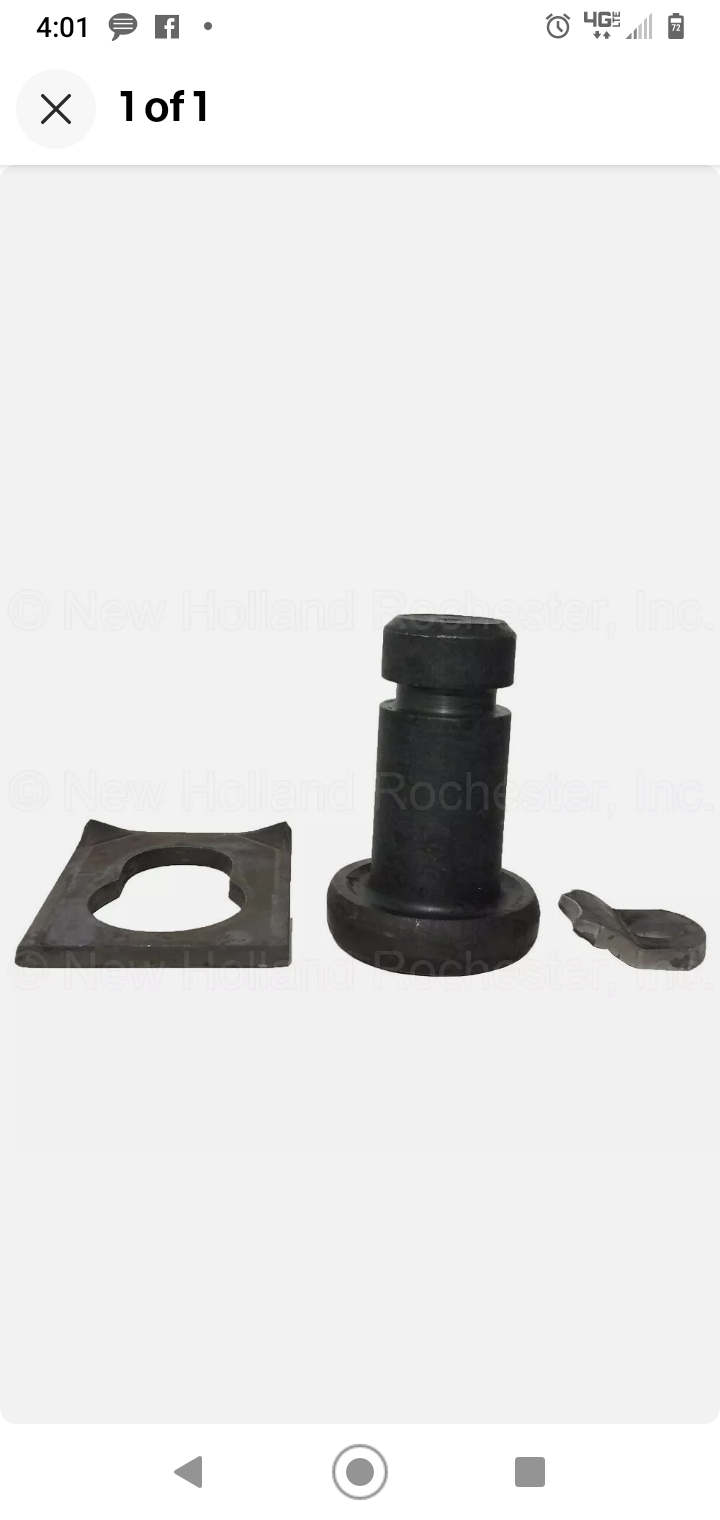

Word pic sounds real similar to their rotary cutters....however.. if they ARE the same....you are forgetting a part.
On the rotary cutters....the pin has a groove. There is a square washer thing with a keyhole slot in it. That's what actually retains the pin, and the bolt and keeper just retain that square washer.
So once bolt and keeper are moved....that square washer thing needs tapped over to the big part of the keyhole and removed. Then the pin drops out

This is what the rotary cutters look like
Nope, I didn't "forget a part." Guess the description wasn't clear, but I said the pin was retained by a "clip" and a bolt. On the RDX990, the "clip" is similar to your "square washer thing" and fits in the groove on the pin, the difference being the bolt goes directly through a hole in the clip - you remove the bolt and tap the clip out sideways. As I said, I could get the bolt and the clip out (of the groove on the pin), so there is nothing else retaining the pin in the mount - it should then drop out along with the blade.
