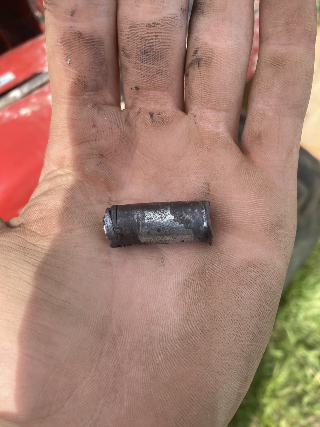

Yup. It has both. Probably just for this reason. Problem solved itself. One good hidden stump and it failed completely.
   / Woods rotary cutter shear bolt stuck #15
Yup. It has both. Probably just for this reason. Problem solved itself. One good hidden stump and it failed completely. View attachment 701328
Well, it did it's job. It's better to shear the pin than to shear something inside the tractor.

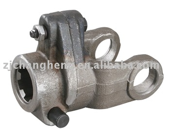

We use this style of shear pin over here. It's very easy to see when the pin broke and to change it if it actually broke as you don't have to pull the PTO shaft off to take the middle part of the broken shear pin out.

That's what struck me as funny. Both a shear bolt AND a slip clutch.
I suspect the.mower originally used the shear bolt alone and the slip clutch was added later.
#17
Nope. It came that way new but I think it was an option. I remember because it is the first completely new piece of equipment I ever bought.
