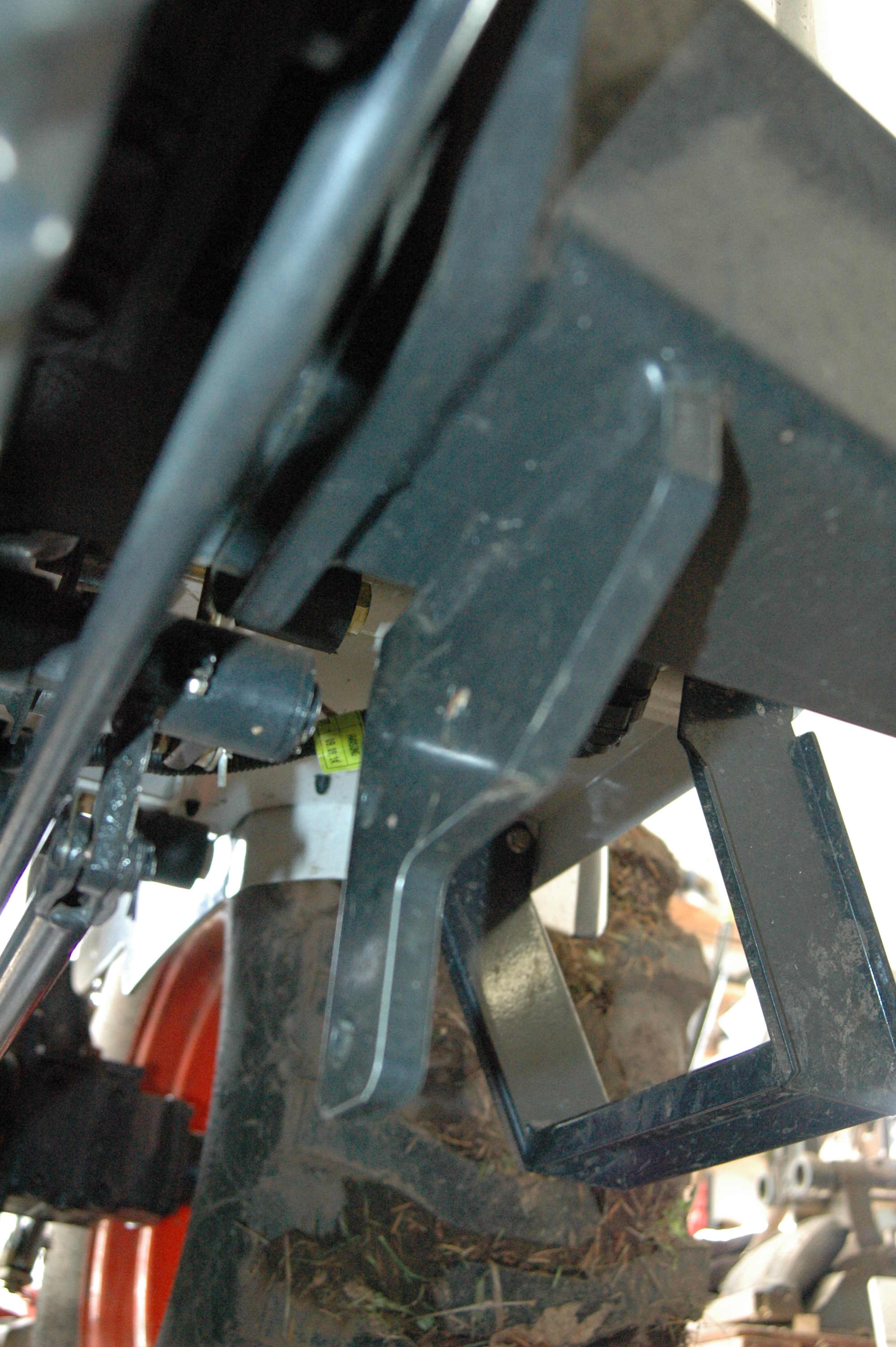

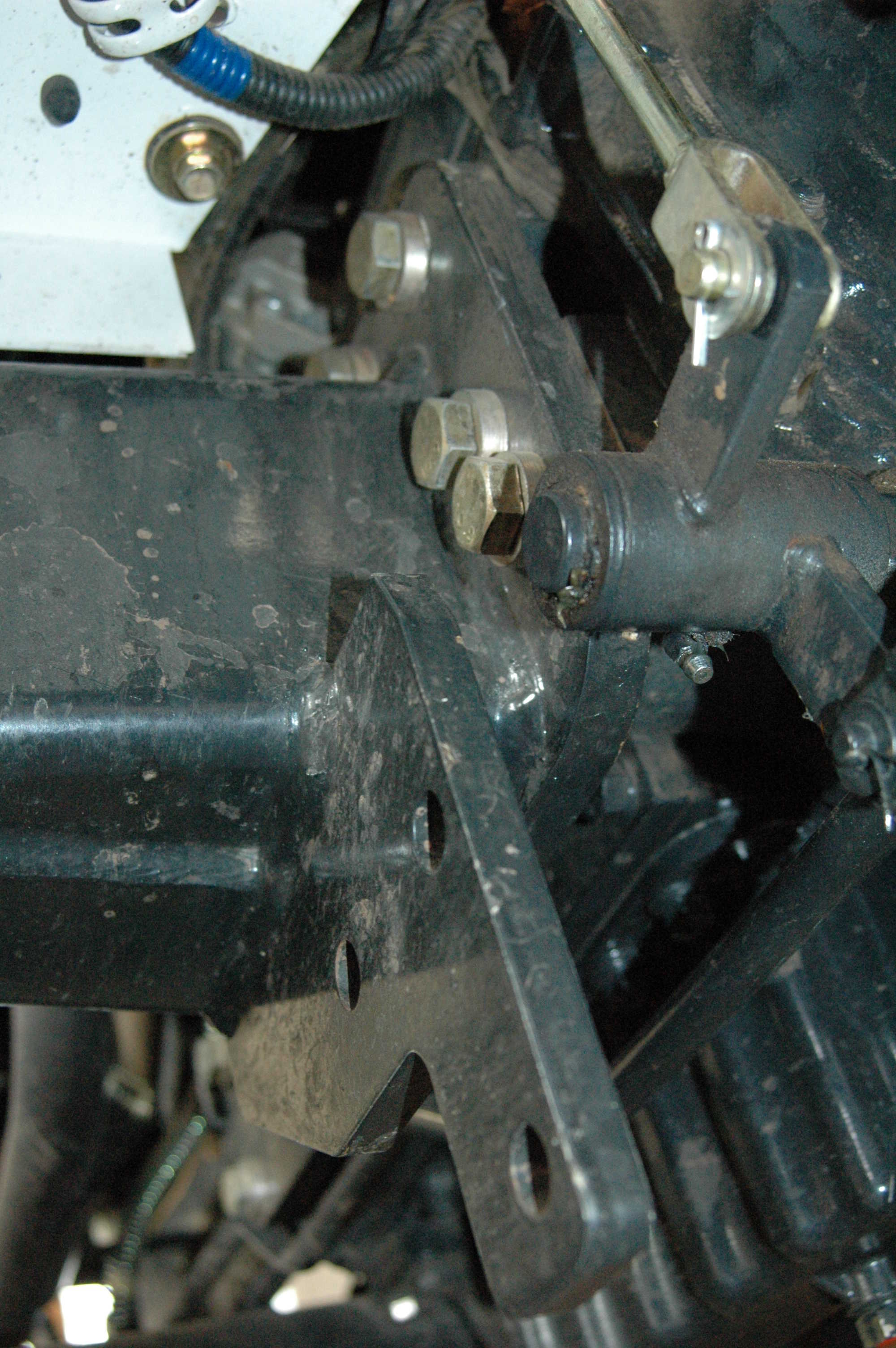

Thanks Tfish, it would be helpful to see the fit-up on that at the front end. Do you know who built the loader on your CK30? I believe that any differences between the Bobcat and the Kioti are related to The FEL mounts.
   / Woods subframe to CT230 #12
The loader on my ck30 is a kioti. I'm out of town right now but when I get home I will try to figure out how to put a picture on here... but the connection in the front was simple but I was able to just order a subframe from woods to put the woods backhoe on my tractor..I'm surprised that they can't make you one, that's what they did for me because they had discontinued the subframe I needed.
   / Woods subframe to CT230 #13
I'll attempt to upload a couple of photos here... it's the left front mount for the FEL, with the subframe mounting tab that would be used for the backhoe subframe. Is this different from the Kioti with it's FEL?
View attachment 489451 View attachment 489452
Dave - I must be loosing my mind, but I swear someone posted a pictures of the loader sub frame on their Kioti and it bolted to the two L tabs in your picture. These are the same tabs used for the belly mowers which I believe fit both. Il keep looking, but is somewhere or got deleted for some reason. Found it - post 23...but you already know that ;)
http://www.tractorbynet.com/forums/bobcat-tractors/310763-wanting-backhoe-ct-225-a-3.html
   / Woods subframe to CT230 #14
Dave I took a picture of the front mount on my CK 30 but can't figure out how to load it...but the front of the subframe bolts to the two L shaped brackets from the FEL. If it is only the front mount that is different on yours that should be easy to modify. the back mount is definitely more complicated...I must be brain dead but I can't figure out how to post a picture on here!
#15
Yeah, those two L-brackets are the key, I think. They are a part of the FEL subframe, and could be different depending on the FEL that was installed. From all the discussion and comments, it appears that any modification would be "relatively" minor, though I don't relish the thought of either cutting and rewelding the subframe, or fabricating an adapter plate to make it work. I'm hoping for a straight bolt-up.
