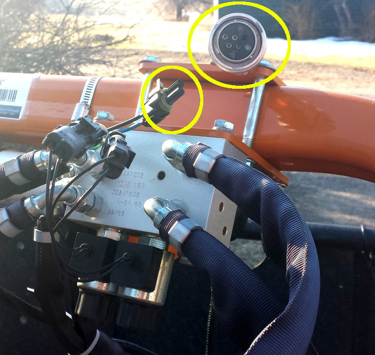

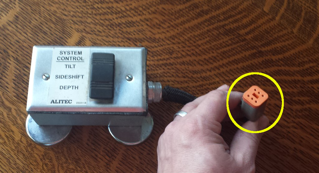

I picked up a "used" Woods TSG50 Stump Grinder yesterday for a very reasonable price. My family recently had some logging done on the homestead and I convinced them to put some of the proceeds towards a stump grinder if I could find a good deal on one. My dilemma is this grinder appears to have the "Electric Solenoid Kit" installed and its missing wiring harness parts. I was hoping someone could help me identify all the wire and/or control parts that are missing.
History about this unit: It was traded in with a tractor to a dealer. The dealer is not a Woods dealer. The stump grinder sat on the lot for about a year. The dealer has either misplaced the wiring harness, or it was never removed from the tractor that was traded in. The tractor dealer so far is cooperating in trying to find me the missing parts.
This is the controller I received with the unit. I do not have the wiring that it plugs into.
This is the electric solenoid valve and connectors. I am also missing the wiring that plugs into these connectors. Should I assume its the same wiring harness that connects to the controller also pictured above?

1) How should this control kit tie into the tractor's electric system? Does it have its own wire/fuse etc to the battery?
2) Am I missing any other controllers/switches?
3) A part number I've found for the wiring harness assembly is E0066. How much would this part cost if I had to buy new?
4) The electric solenoid kit is designed to work with a tractor that has one rear remote. My LX has two rear remotes. Would it be better to just remove the electric solenoid kit and replace it with hoses to my two rear remotes?

In general, the solenoid valve appears to be a dual solenoid control .
Even if you can not find the wiring harness, you could just wire up a switch to control each of the solenoids.
You need a hot lead with fuse, and ground.
Can you determine which cyl each solenoid operate by following the hoses.

The dealer looked into ordering the missing wiring harness and came to the conclusion it must be made of gold. The solution we came to yesterday was they will make me four hoses to hook the cylinders up to the dual remotes on the LX, no extra charge. I'm satisfied with this outcome. The electric solenoid feature was not something I was looking for and was not factored into the price.

Yes sir, the dealer made good on their promise and sent me the factory hose kit which arrived directly from Woods. I just had to purchase the quick-connects and fittings that matched up to my Yanmar LX and turn the wrenches. Everything worked as expected - one hydraulic remote lever controls the up/down action, the second lever controls side-to-side action. The spinning grinder wheel of course is spun by the tractor PTO.
