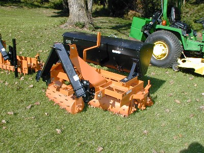

   / Woods "Turf Renovator" #13
Re: Woods \"Turf Renovator\"
Here is one view of the 4 foot version. Another photo is shown in a reply.
The large black triangle is half of a Freedom Hitch coupler. It is not a part of the Woods Turf Renovator.
JackIL

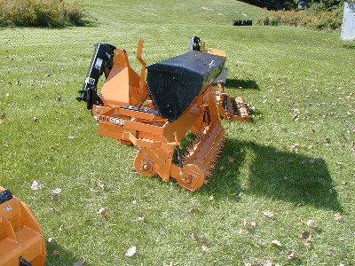

   / Woods "Turf Renovator" #15
Another View of the Woods STR - 4 foot version.
JackIL
   / Woods "Turf Renovator" #16
Thanks for the pic.
One question I have is do the seeds just fall from under the seed box to the ground or do they have tubes they fall through like a grain drill?
Around here, the wind blows like stink, and it could affect your seed pattern.
I'd be planting only fescue in one I bought.
THANKS!

   / Woods "Turf Renovator" #17
No seed tubes. Seeds just flow down the inclined plate. On the new version of the STR (mine is the previous version), there is a cover over this slide so I don't think that wind would affect it as much.
JackIL
   / Woods "Turf Renovator" #18
Just falls onto the rollers.
I have had no problem with mine at all.
I think mine is a 4' not a 5'.
Like those freedom hitches, I have them on every thing & it beats any other hitch out there.
I actually sell them they are so good.
But you cannot go wrong with the gill super turf renovator.
It works real well like it was said before, go over it a couple times & it works the ground up great. Also if you back up with the front rollers angled all the way it is better than a field cult or a garden tiller for prepping a seedbed.
