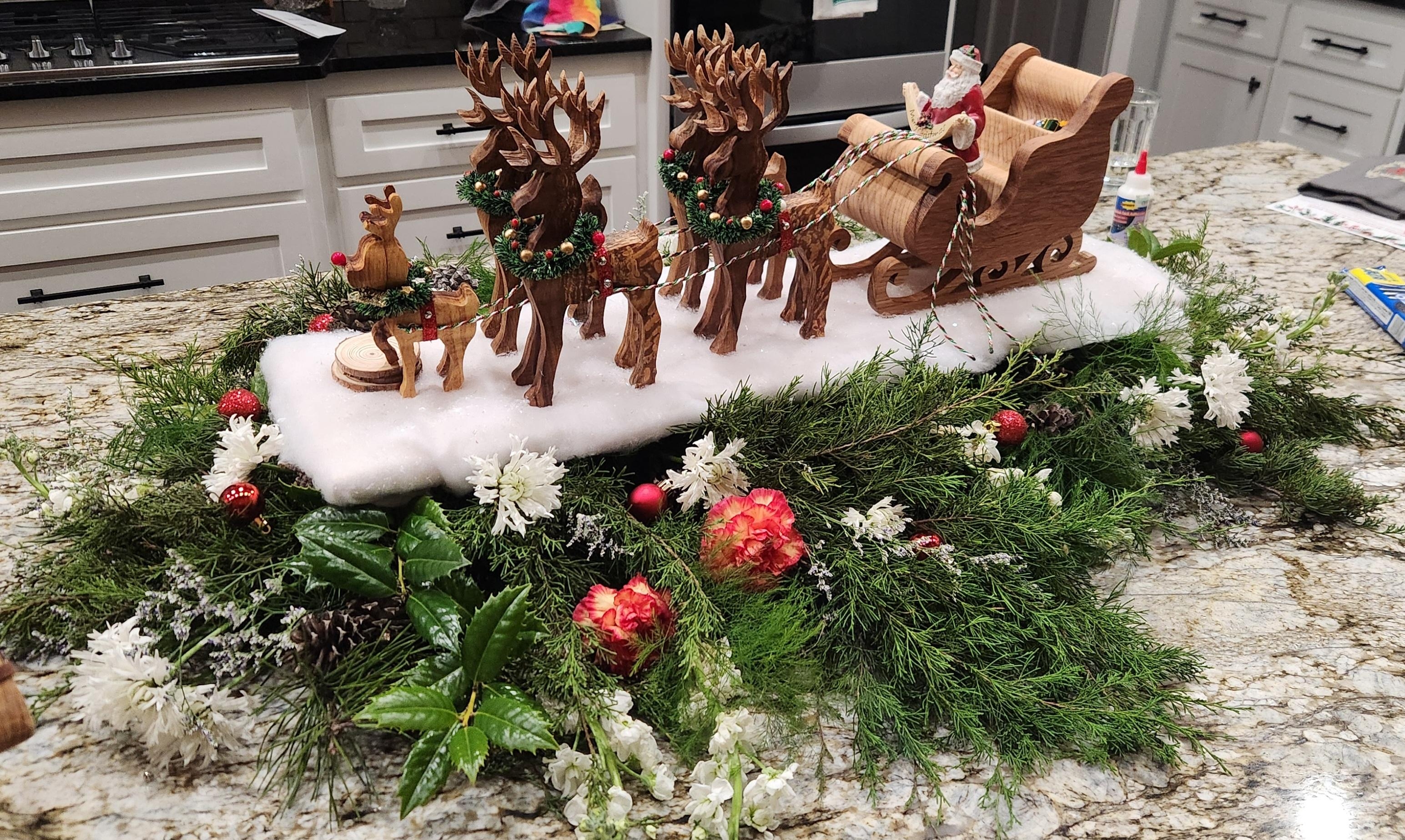

Getting closer. I think I have around 35 cut. I'm sanding this evening. There are 3 distinct woods and I don't really know what they are other than the red oak. One of them is pretty dark and the grain is very tight almost how cherry grain is. The other is very light with super defined and porus grain
/ Woodshop Projects #29
Are you using a ban saw for all of your cuts? Do you have any pictures of it? I'm curious how you get all those small cuts, but also the deeper cutting on the bench in the sleigh?
/ Woodshop Projects
#30
Turns out I don't really have many pictures of the saw. It has a 6-1/2" high capacity with height adjustable guides. Everything was cut on the bandsaw for the sleigh except for the inside cuts on the runners, those were made on a scroll saw. I glued up and cut the interior of the sleigh - the lighter color wood (pine because I had a leftover chunk already glued up from a past project). Then I glued oversized planks on both sides (red oak), and cut the outside all at once so it would all line up. The runners were cut as 1 thick piece then ripped into 2 equal width pieces with big tabs on the top where they attach to the sleigh. I had to do some figuring on how to connect them. I ended up cutting mortices by hand with a chisel on the bottom of the sleigh and cutting the tabs into reasonable size tenons.
