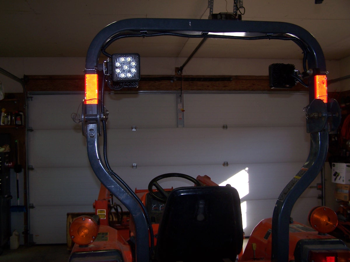

You will enjoy them. I mounted two facing forward and two facing to the rear on the ROPS. Love them.

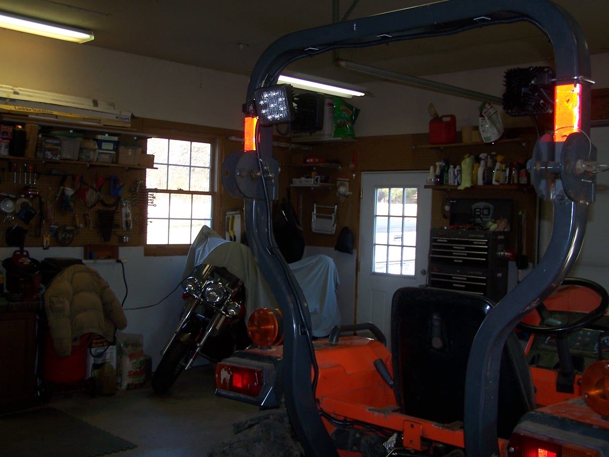

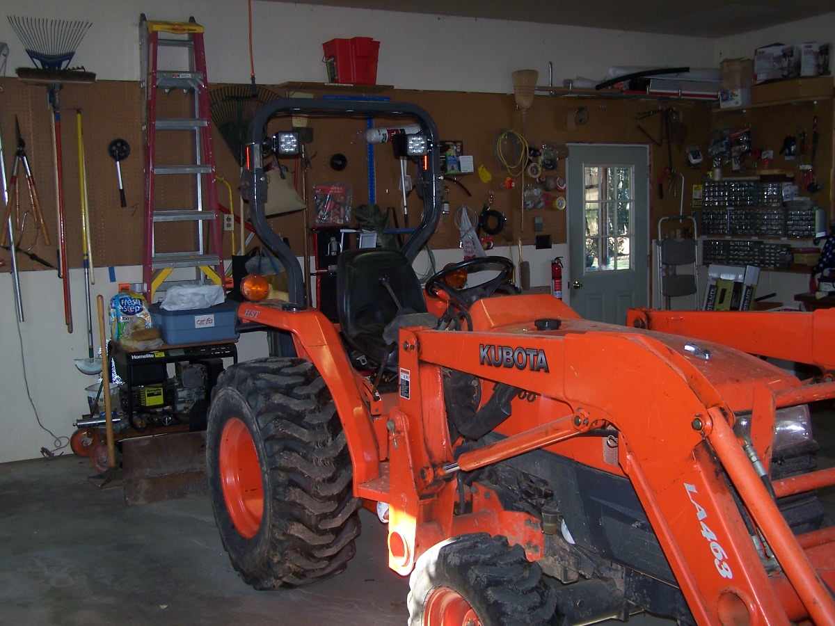

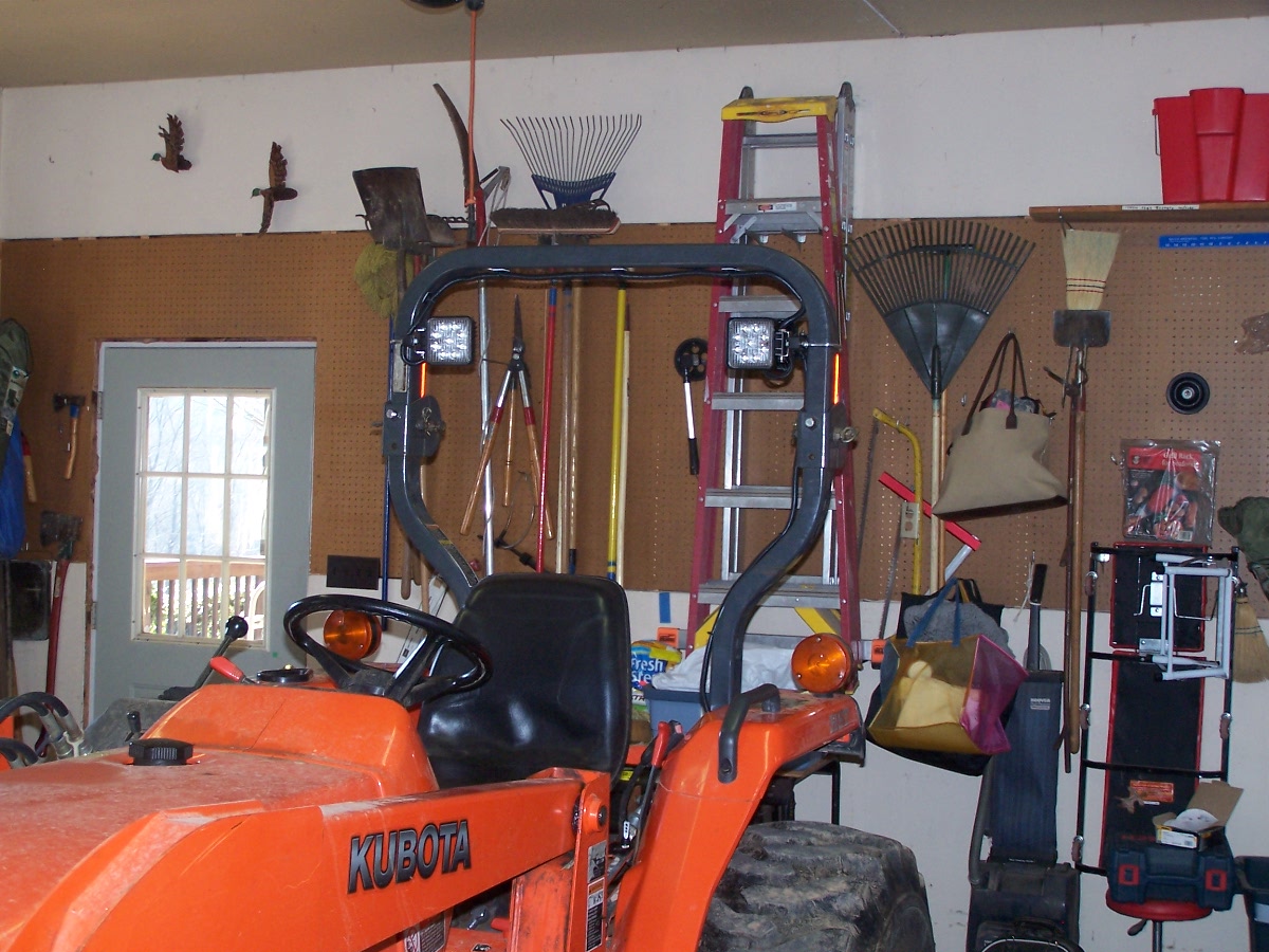

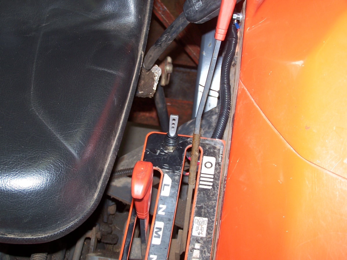

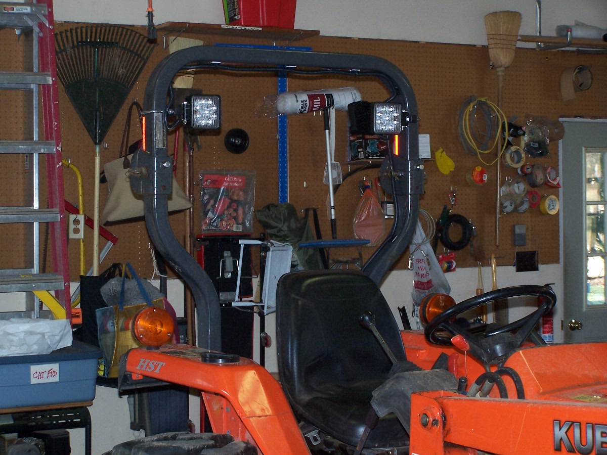

OK, spent the morning getting the lights installed. I have 2 facing forward and one facing the rear. There was an unused connector under the left fender that I believe was intended for a work light. I tapped into that and since it is connected to the ignition switch the lights will only work when the key is on which is what I wanted. I mounted the switch near the hydro controls between the seat and the left fender. I have never folded the ROPS down before, but I believe there is enough slack in the wiring that I can fold it if necessary.
Once it is dark, I'll see how they work and if they need to be aimed differently. So far, so good!
   / Woot woot! Santa brought me some LED lights! #9
The lights look great. You did a nice install job.:thumbsup:
I could not help but notice the "cat fud" box.
Now is it named that in honor of the Gary Larson cartoon of the dog misspelling cat food "cat fud" on a sign to entice the kitty to go into an open door on the dryer? Do you remember this cartoon?
