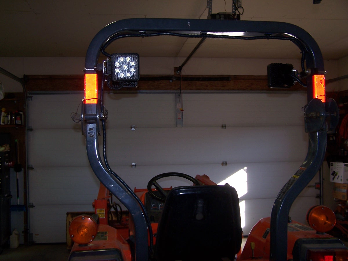

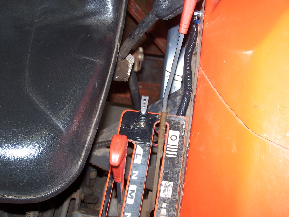

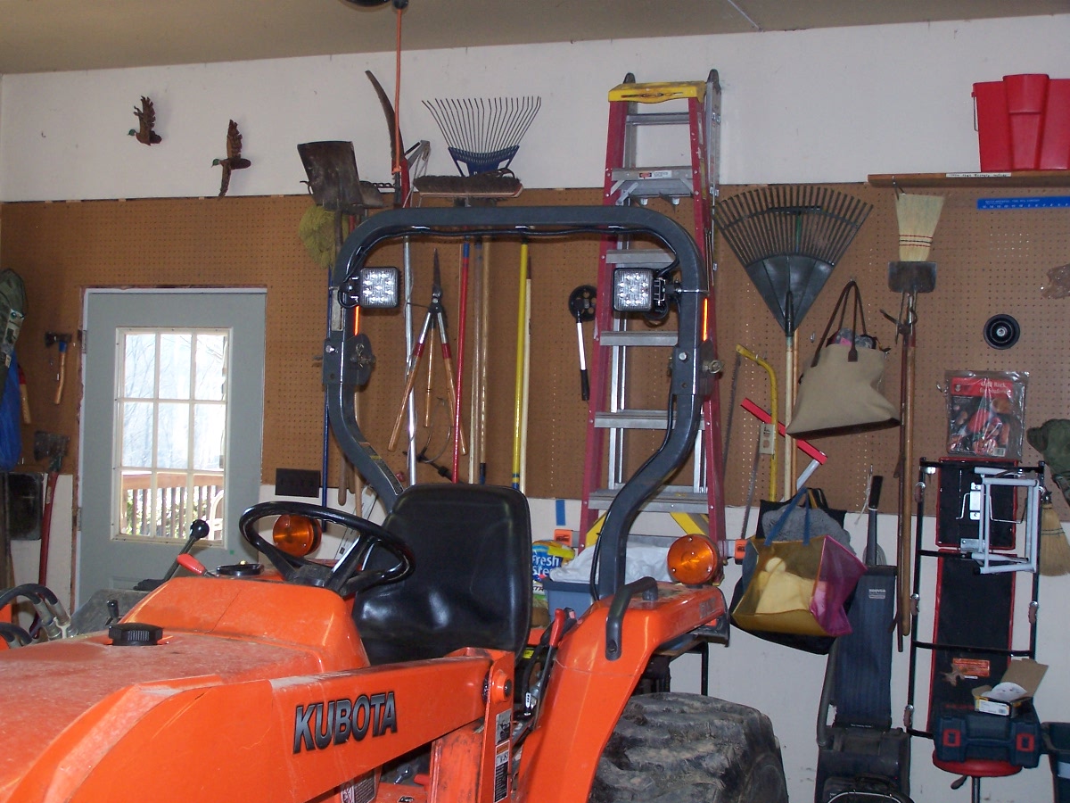

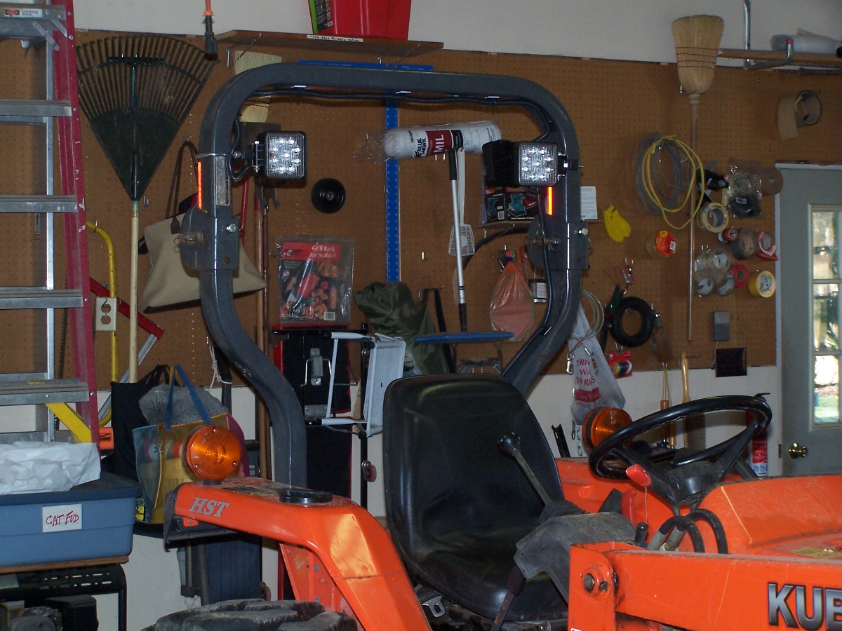

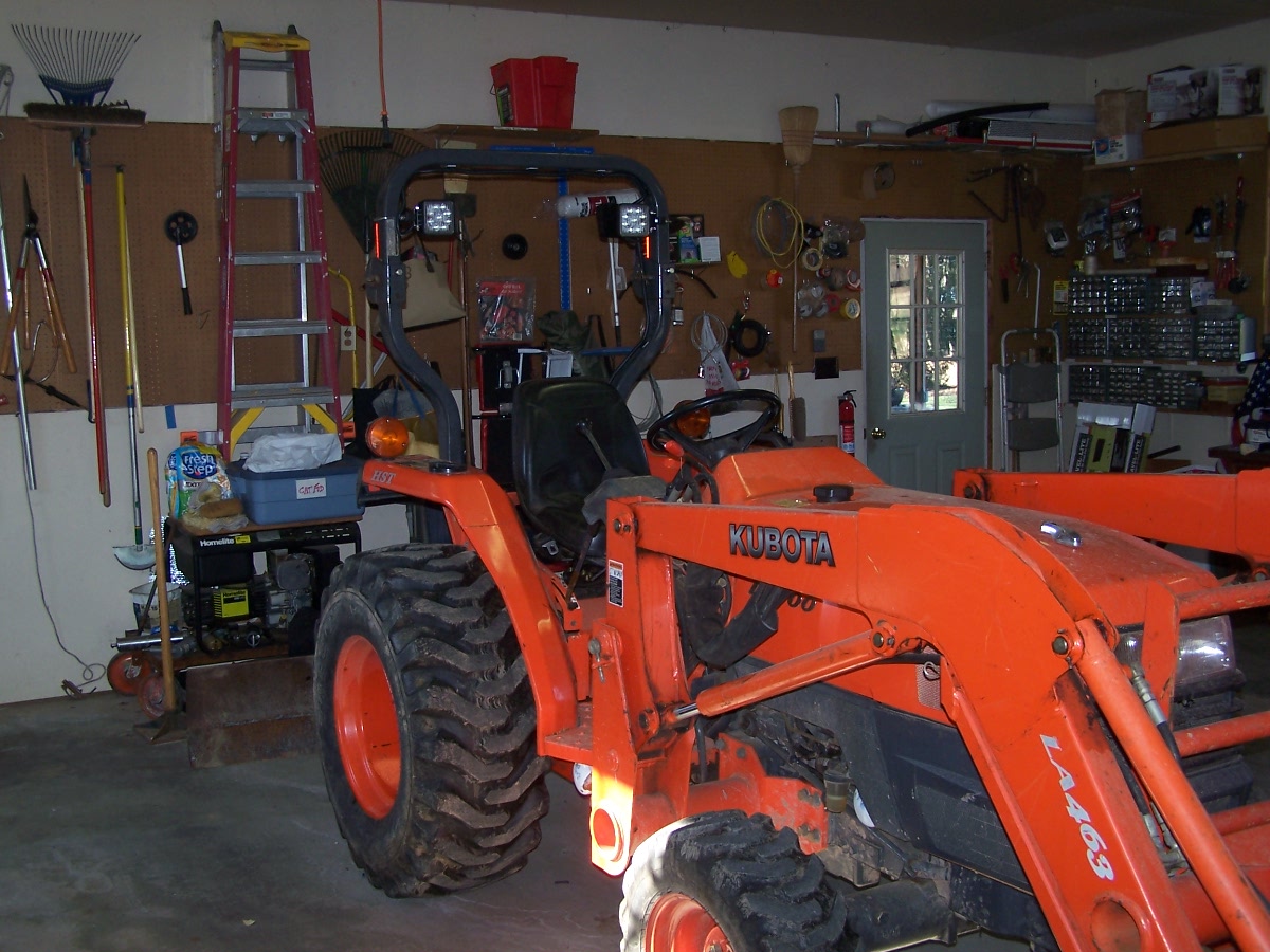

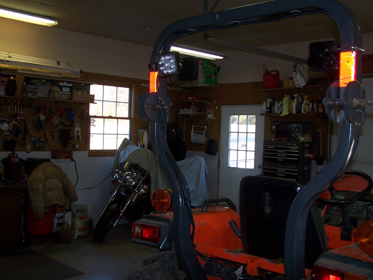

OK, spent the morning getting the lights installed. I have 2 facing forward and one facing the rear. There was an unused connector under the left fender that I believe was intended for a work light. I tapped into that and since it is connected to the ignition switch the lights will only work when the key is on which is what I wanted. I mounted the switch near the hydro controls between the seat and the left fender. I have never folded the ROPS down before, but I believe there is enough slack in the wiring that I can fold it if necessary.
Once it is dark, I'll see how they work and if they need to be aimed differently. So far, so good!
View attachment 404833View attachment 404834View attachment 404835View attachment 404836View attachment 404837View attachment 404838
Very nice! That is a fantastic price they are offering right now. Is that an extra mount you made yourself for connecting them?
   / Woot woot! Santa brought me some LED lights!
#15
Yes, I used some 1" square tubes and connected them to the ROPs with square U bolts. Then drilled holes in the tubes to connect the brackets that came with the lights (had to get longer bolts that would extend through the tube).
