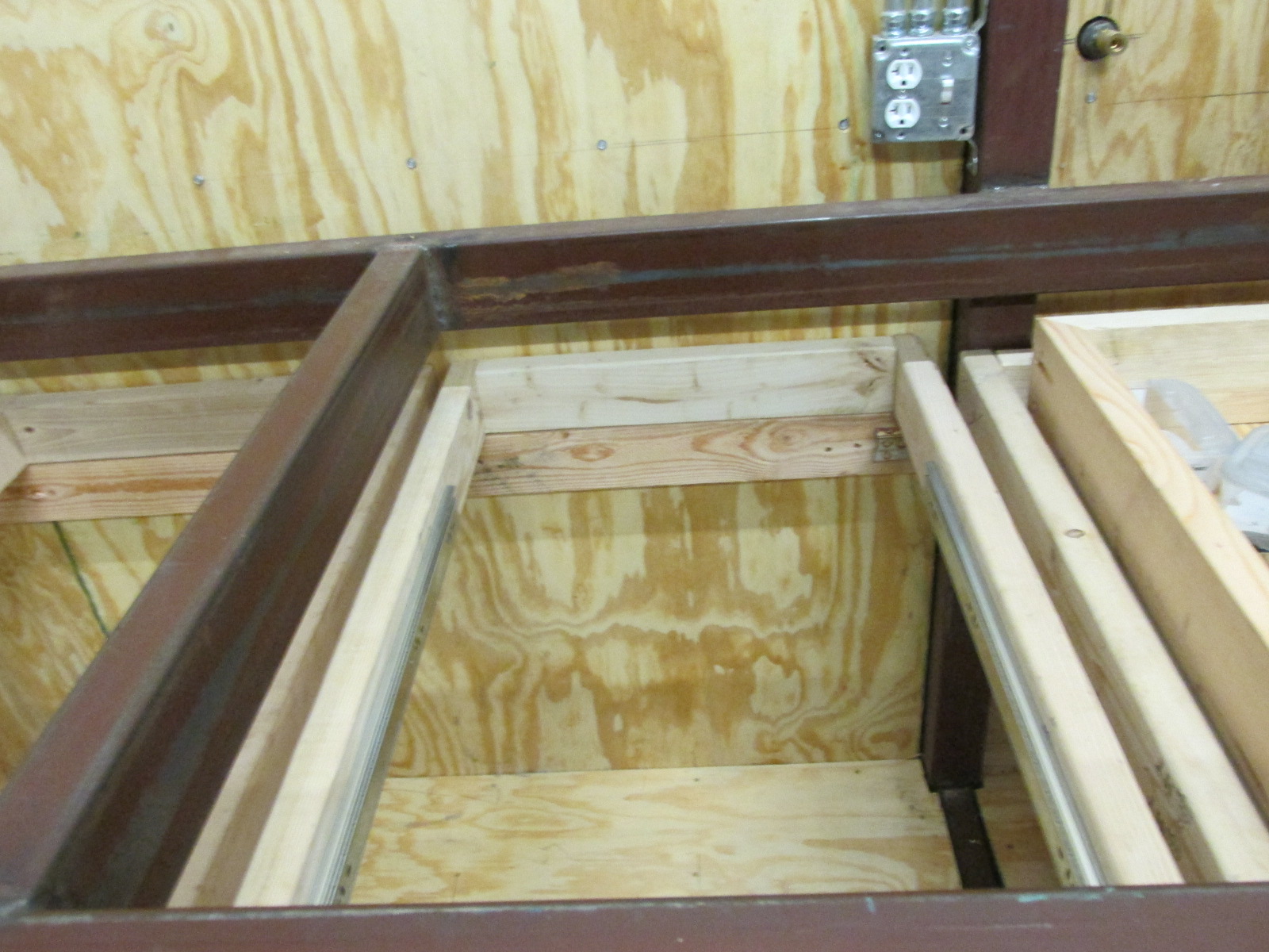

I framed mine with 2"x4" red steel tubing. It will have full pull out drawers.
