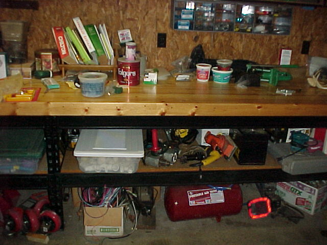

I took 2x4's and ripped about 1/4" off one edge to make a good square edge. Cut to length and glue numerous ones together standing on edge with square edge as your top. Glue and nail enough together to make it the width you prefer. After dry, sand smooth with a belt sander and finish with polyurethane. If you want to get fancy, mix light and dark wood for a beautiful laminated look. My bench is 16' long and took my front end loader to set it. I used old warehouse racks as the base. Long process but much cheaper and stronger than anything on the market today. I sent you an email with a picture attached and attached one here too.

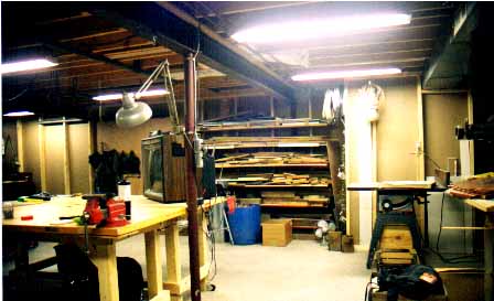

I managed to find a couple of pictures of the benches I built. The pictures aren't real good but maybe they'll give you an idea. The tops are a couple of solid core doors that they were throwing away when remodeling was being done at work. The frame and legs are just 2X4s bolted together.

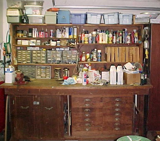

This bench was built in about '58. The plactic bins at top hold paint brushes, etc. Lots of shelf space for spray cans and parts drawers. The drawers at right are for sand paper, chiseld, glue, measuring tools. Flammable chemicals in the cabinet under the vise. I really should move these to the yard shed.
This bench makes a good wall unit.

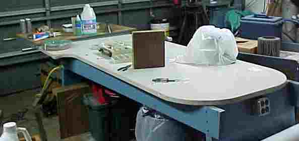

I made this bench from a 7' walnut veneer office door and a refinery control room console table. It is 1/4 lower than the table saw table, so it is also an outfeed table. Lots of storage underneith for stool, trash can, shop vac.

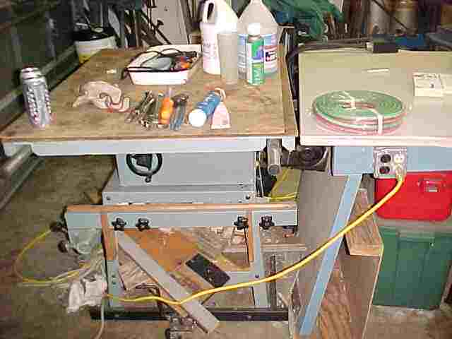

This shows my table saw cover. This keeps the saw like new and is also my welding bench! The top is 3/8 plywood with 2x2 edges. The very top surface is tub surround. There are two pieces because the old one, loose on top, gets welded and painted on.
Note also the 4x4 electrical box. I like these and have them mounted along the outside of the bench.
The bud light cans is evidence that I really enjoyed my hammock yesterday /forums/images/graemlins/laugh.gif
Using the bench behind the saw I can rip a sheet of plywood by myself.

Ken, Thanks for sharing... That's the general idea of what I'm looking for... It looks sweet! /forums/images/graemlins/laugh.gif
