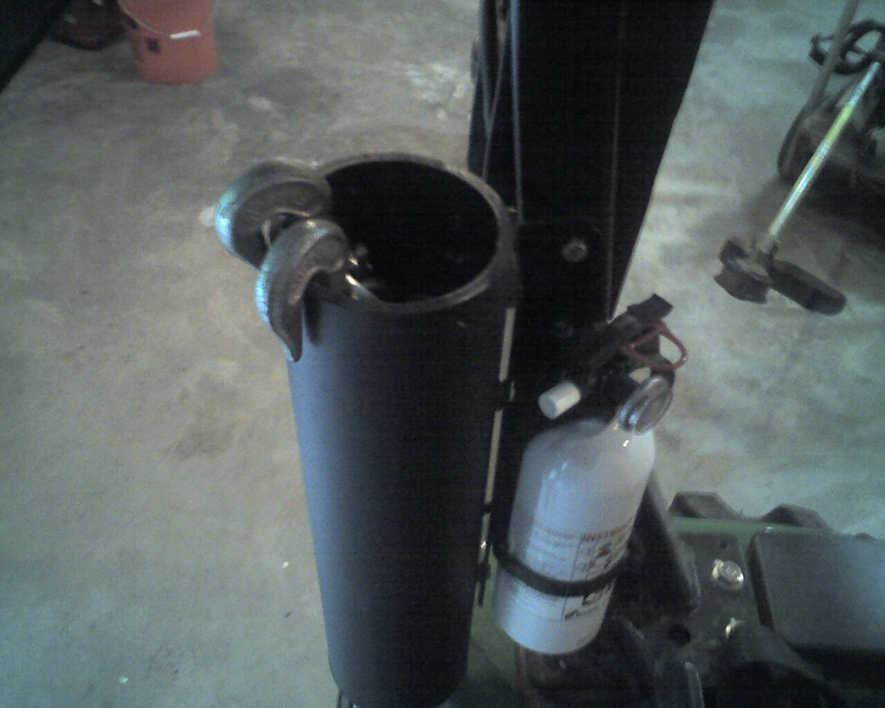

What is the diameter of that pvc pipe that holds your chain? A picture would be nice.
When I received my new JD I found that the dealer had mounted my SMV right over my rear light so it shaded it.
It's 4" pipe with the slotted pvc drain plug cemented in the bottom. I'll try to get a few detailed pics up.

#15
Ok, here's a poor quality cell phone pic, but you can kind of make out the 1/8" angle that both my chain box/tube and fire extinguisher are attached to. This angle is what JD uses on some of their CUTs now to mount the SMV triangle on (and not cover up the nice JD logo on the back of the seat). I always thought it was a pain positioned there & wanted to attach a chain box so it was done. Credit for the chain box goes to another TBNer who I saw in a pic mounted one to FEL mast. The angle is simply drilled to match the bolt holes through the ROPS for the turn signals.
