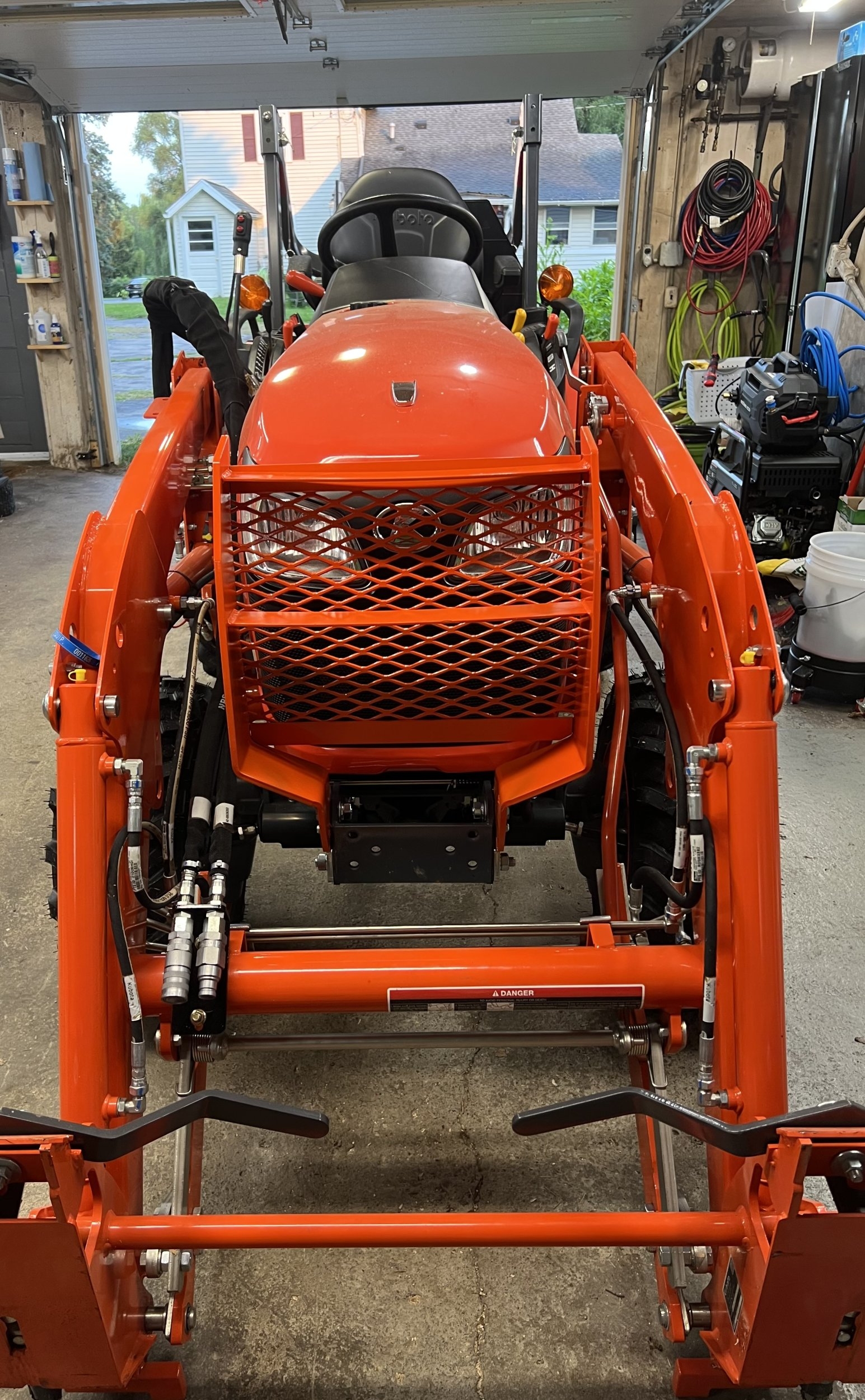

Just adding to my post. I added some expanded metal to my grill over the weekend to make it more a brush guard and was able to see where I was placing my gun and what I was doing when the arc was lit with my hood. There's just a momentary period when the arc first strikes and when it goes out it's black for half a second or so, but otherwise I absolutely can see what I'm doing and I'm positive my ability to see makes me a better welder than I otherwise would be.
