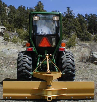

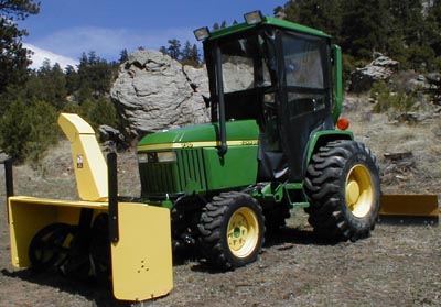

Try Peterson lights - Reasonably priced and well made. I used 504HF (flood lights) with a SPDT switch to select the front or back set.
   / Work Lights- Which one to use????? #8
Here the back set...
