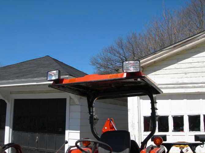

This is my setup I'm on my third winter and i'm very satisfied. I bought 4 trapezoidal beam lights from northern tool 14 .99 each. I wired them on a toggle where I can select front or rear. The center rear light is a flood type on a separate switch used as a backup light when doing snow removal.

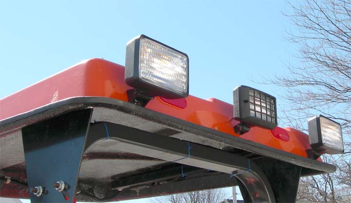

Rear Lights
