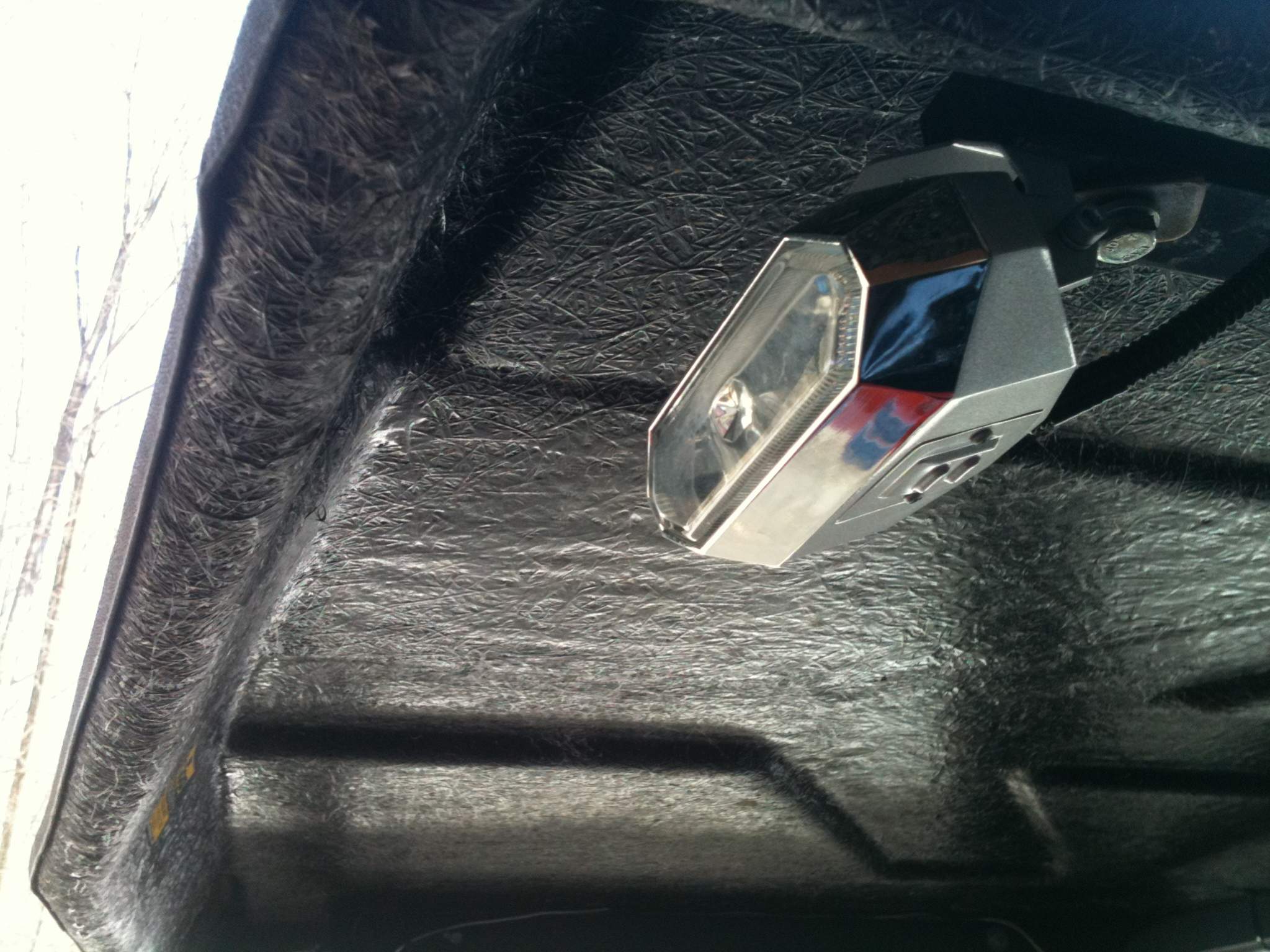

I will share what I did for both front and rear lights hanging from the sunshade.
A) Fused 12 gauge from starter to switches (Made splitter wire to supply both switches off the supply wire)
B) Used two switches (front and rear)
C) Did not use relays as the switches were rated for 20 or 30 amps each. Plus I was just lazy and did not feel like wiring relays into the circuit. Switches were from Radio Shack and had a rubber boot to provide some degree of splash protection. Switches are housed on a home made bracket with a splash shield around it.
D) Used 14 gauge wire to the lights.

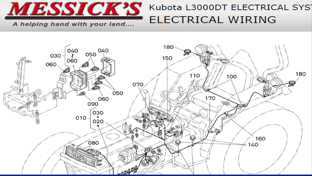

Have you been to Messick's site and downloaded the electrical system PDF for your L3000DT ?...it may not show a blow up of the harness but it may give you an insight...
   / work lights
/Pine, thanks. I did check out Messick's site. Drilled down to my model and they wanted to email part of the manual. I have not received any email. Am I missing something? It would be great to simply download a schematic.
   / work lights #11
What you get are PDF files that are taken from the original parts manuals...they show ALL the parts connections etc with numbers...they are very nice references to have on hand...
Not sure why you have not gotten the file...you might check your spam filter or junk folder etc...

I was able to download it without issue. Send me a private message with email and I'll send the file out.

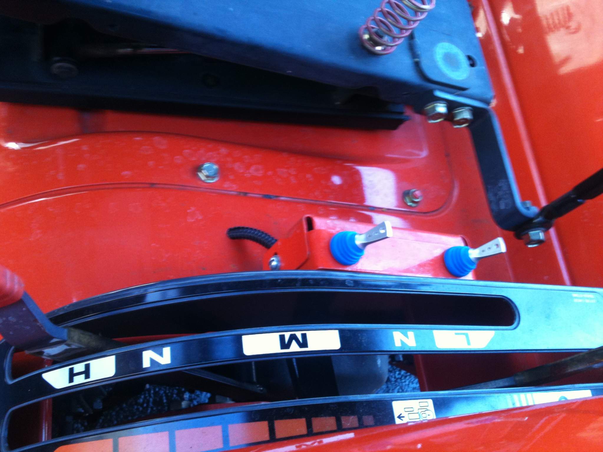

It does not show a specific work light wire, but all the wires for the rear lights, flashing lights, etc... are under the fenders. The right hand side (as seated on tractor) seems more promising.

nealfris,
Here is the switch I used. Prefered something more waterproof, but gave up driving around looking for something. This switch came from RadioShack and was ~$4.
It is also rated at 40amps.
SPST 12VDC 40A On-Off Toggle Switch - RadioShack.com
Below you will find the wiring from Messick's and a picture of my switches and lights.
