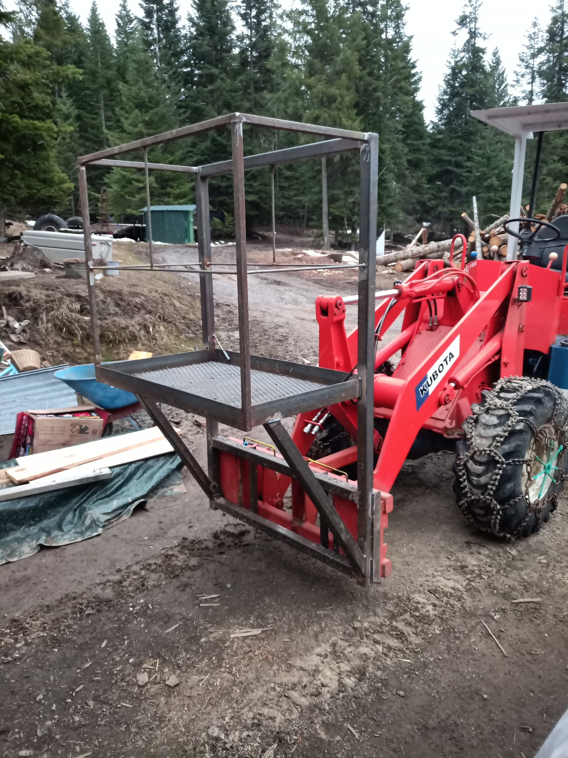

This forum has been a great source of information for me so I thought I'd try to contribute a bit.
My new tractor has a cab. My old tractor didn't. My trails through the woods have plenty of overhanging branches that won't clear the cab. A platform should work good once the ground is froze with a friend and chainsaw in the bucket.
So my first build was a work platform. I wanted more lights in the shed so it worked out great for that too. My BIL electrician loved it.
Materials were under $300 from a local welding shop. I cut things to size, welded and painted it. Used 5 lbs of welding rods!
Still need to make a "tool box" for it.
Thanks to all who share their info on here.

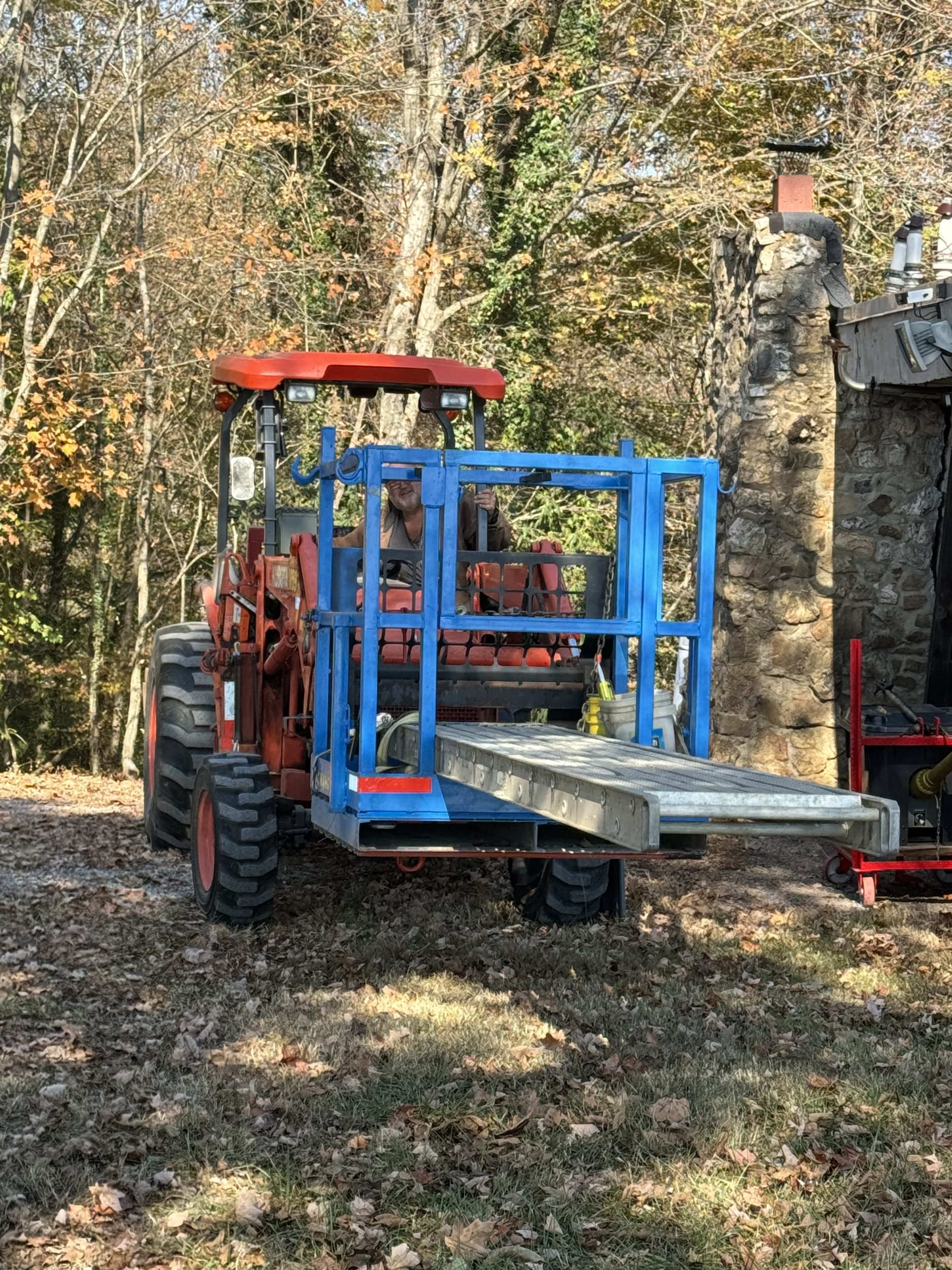

Looks nice. Good to see the chains on it. Years ago, I was on a job where they were using a basket like that and the operator in the skid steer backed into a rafter and wiped the basket off the forks (they'd forgot to hook up the chains) with a guy in it. The whole thing came crashing down and threw the guy out. He ended up with a big gash under his chin. Was lucky whatever cut him wasn't a few inches further back towards his throat.

I like to put a ratchet strap on mine. It stops it from moving around on the forks. It looks like the OP has a bolt to tighten against the forks that would do the same thing. I was considering welding a skid steer plate directly on the basket to avoid having to use the forks all together.

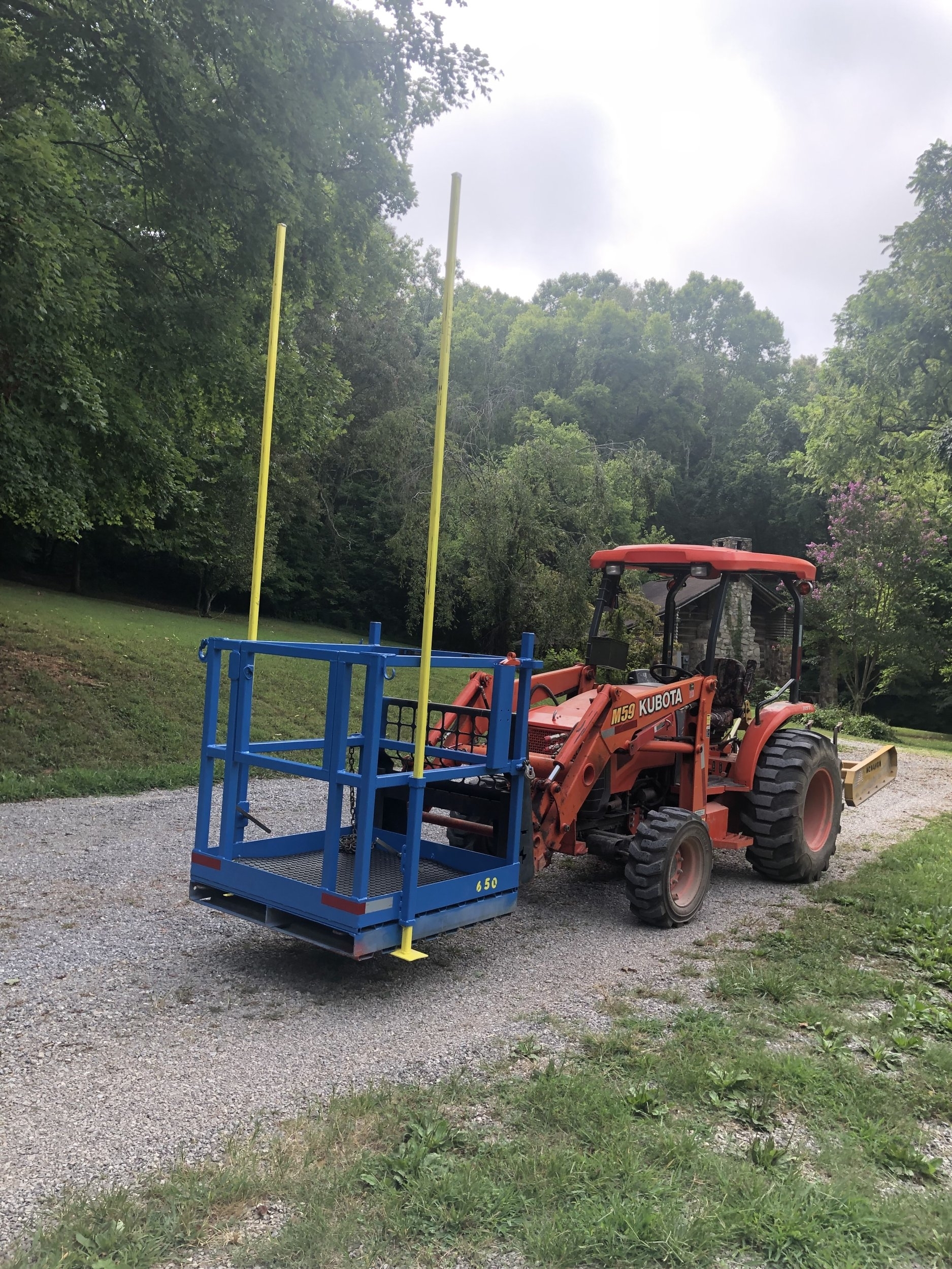

I built a work platform for my forks but I'm always a bit nervous using it. I know it's very rare but a sudden hydraulic failure could cause an injury.
I came across this idea in a post by @Smokeydog in another thread. His build uses adjustable support legs:
I can see where the rig could be cumbersome to use, especially indoors, but his idea has merit. The legs can always be removed if necessary.

That looks like an interesting idea, but it would be good to test it before becoming too confident in it. It appears that in the event of a hydraulic failure the basket would rotate toward the tractor and bend/collapse the legs as the loader arms went down.

If you read the build I did test with a 950# weight. Tractor off, hydraulic pressure totally relieved. One leg could support the platform.
Any safety system can be defeated.

/ Work platform #18
I like the looks of it.. I doubt that I can buy the metal any cheaper than what yours cost. Is it as sturdy as it looks?
It is sturdy enough and the guardrails feel sturdy too. Had it for years, lent it out to a neighbor who like it also. It folds up about 6 inches wide and I roll it into a space between the container and the garage wall where it quietly waits for the next use.

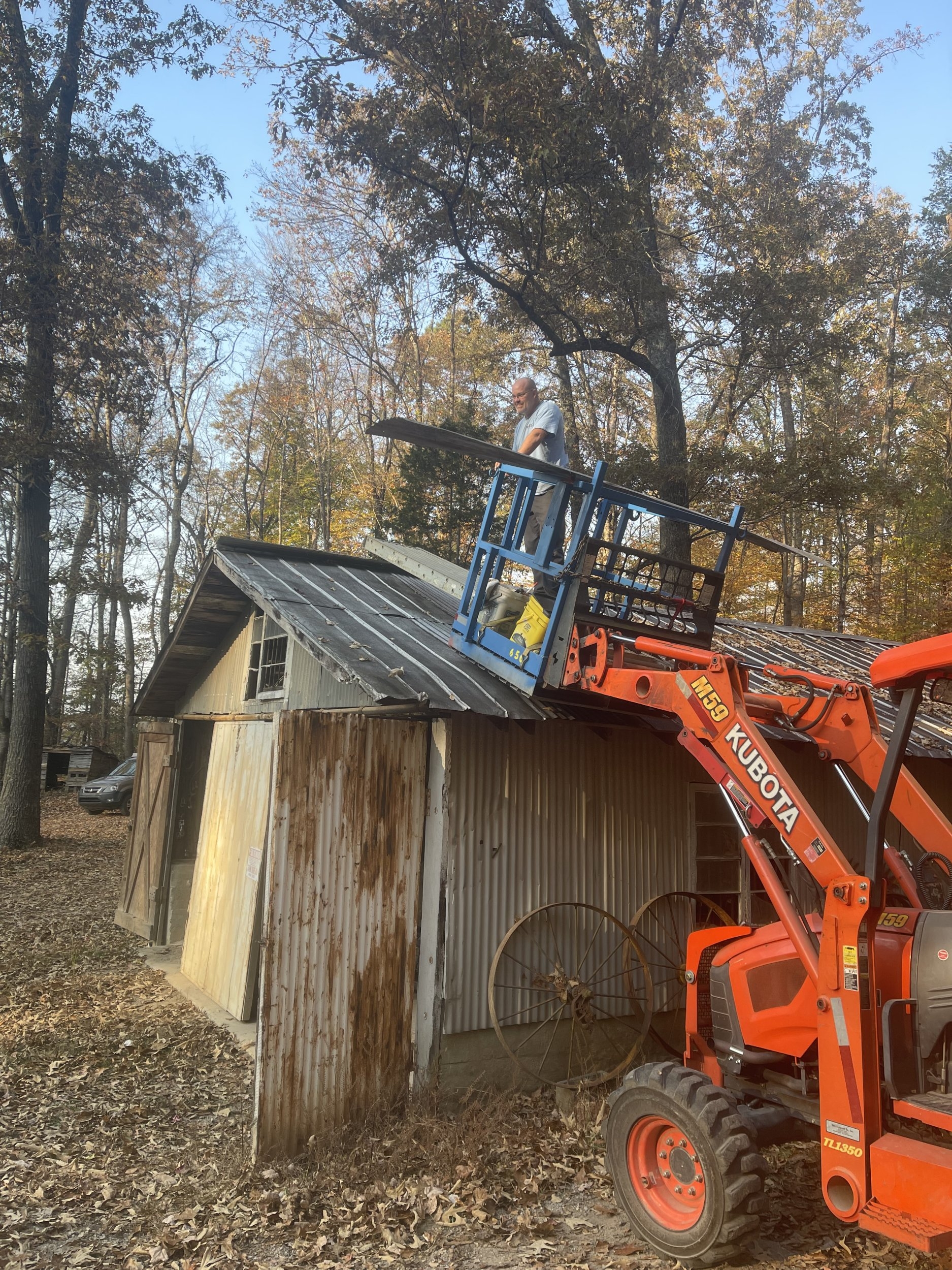

With any man lift, proper fall protection should be used. Harness and tether anchored to good attachment point. Do I always use? No but sometimes. With a tractor the terrain is not level and smooth like a warehouse floor. Trimming tree like having sturdy rails to lean against. Sometimes plumbing up with backhoe stabilizer before lifting.
Sturdy rails double as carryall, sawhorses, and work platform.
