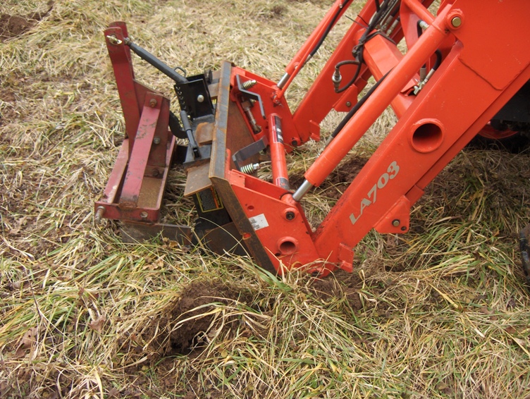

I had posted a while back about the Sub Soiler(SS) on the FEL and I posted some pics of the hill side that I loosened up early in the winter. Spring is when I can do alot of dirt work without stressing the machine because the soil is loose.
The first pic is of a small part of the slope right after I run the SS through it.
The second pic is of the SS sunk into the ground. I couldnt push this through the ground like you can pull it from the rear I had to push it in and curl it back or not sink it all the way down. It does work well for rooting things out of the ground.

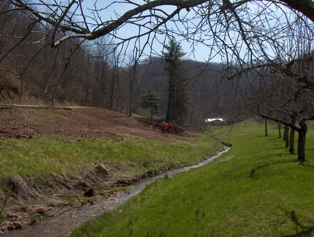

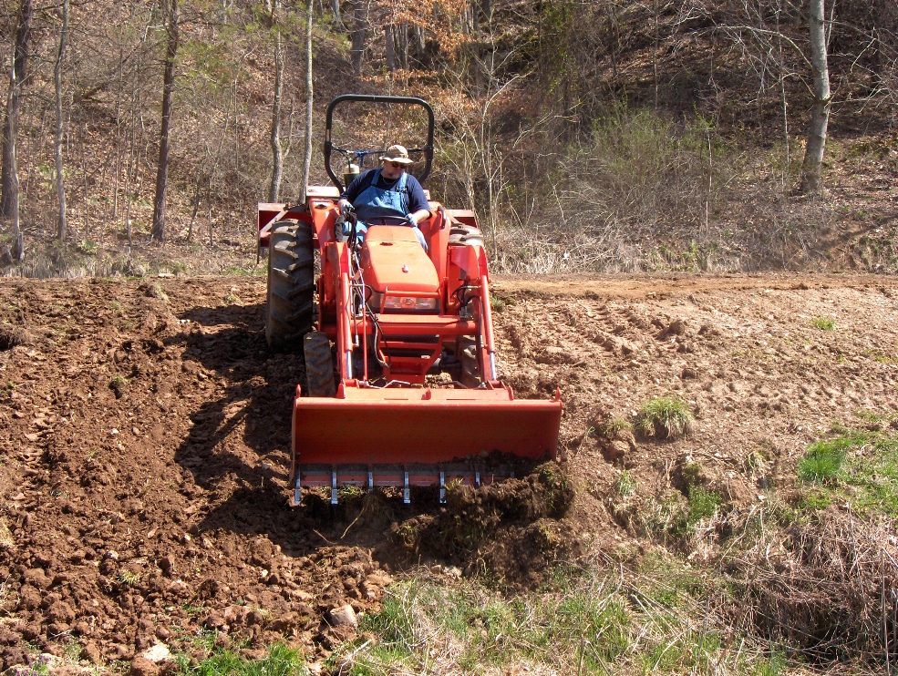

I have a tooth bar and a Box Blade that I normally use for dirt work. That combination has served me well.
Here is a few pics of the slope with the dirt work in progress.

Looks like you did a great job, pretty country there!

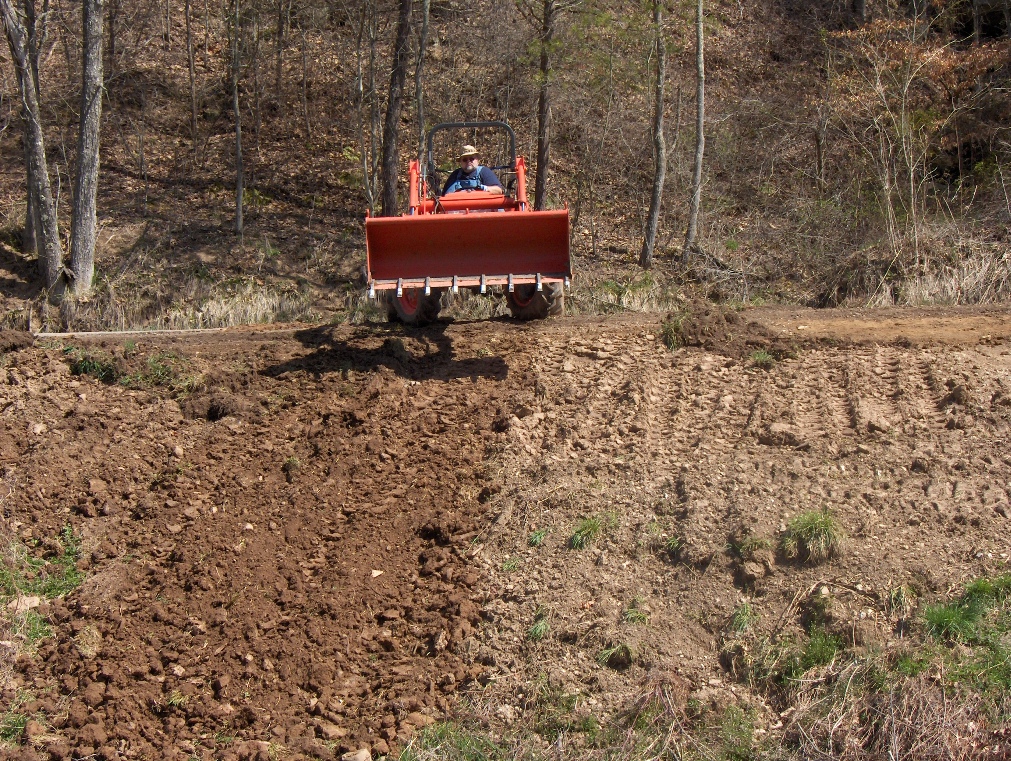

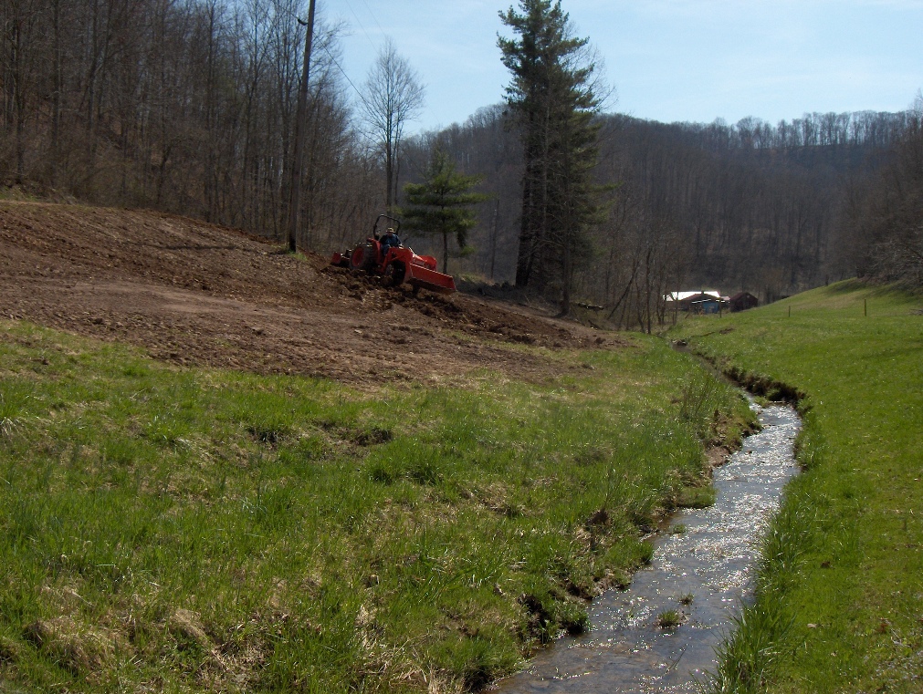

This was the part that made me nervous and it is steeper than it looks. I will mow this down only when I get the grass to grow on it.
I did most of this work a few weeks ago and the grass is coming in nicely.
