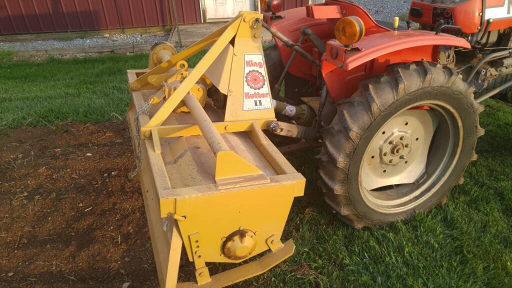

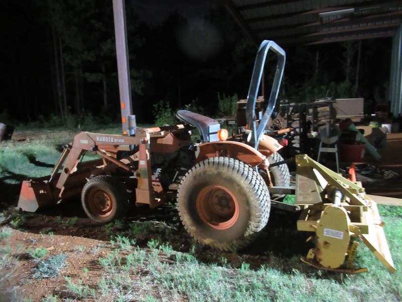

I have a Kubota L235 (23.5 engine HP and 19 PTO HP) running a KK 5' tiller. It is supposed to be to big for the tractor, but as long as I take it easy, it works just fine. 1st gear so I don't go to fast and 4 wheel drive for the traction, otherwise the tiller will push the tractor. I also use multiple passes starting with a shallow depth and can get a really nice seed bed. It will also chew up some pretty hard and rocky ground.
The tiller has skid shoes to set the depth, but as the soil is broken up the skid shoes sink into the soil an inch or two. I do not know how deep it goes, but it's more than enough for anything I've ever needed to do.
