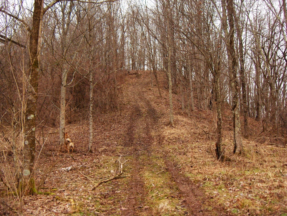

Let me add this as a new tractor user you should go slow until you learn the machine. Don't try to do everything that the tractor is capable of, because it takes time to learn where the limits are. Go slow, always keep the FEL low to the ground if it is on the tractor. keep all of the implements as low to the ground as possible. Watch for pot holes dips sales rocks or anything else that could change the angle rapidly. Have an experienced operator walk you through the operation and what may be acceptable or unacceptable areas. Stay off of the slopes when it is wet, A tractor is not a fun sled ride. I agree with backing up the slopes first to see how the machine does. Here is a pic of a 27 degree hill tractor path that I made with my L4400 HST
