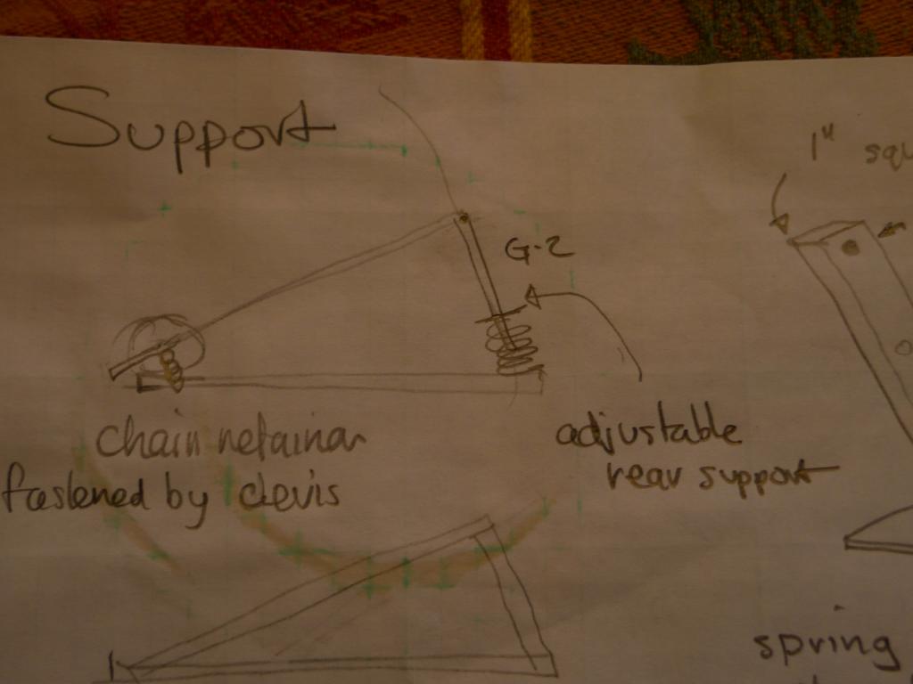

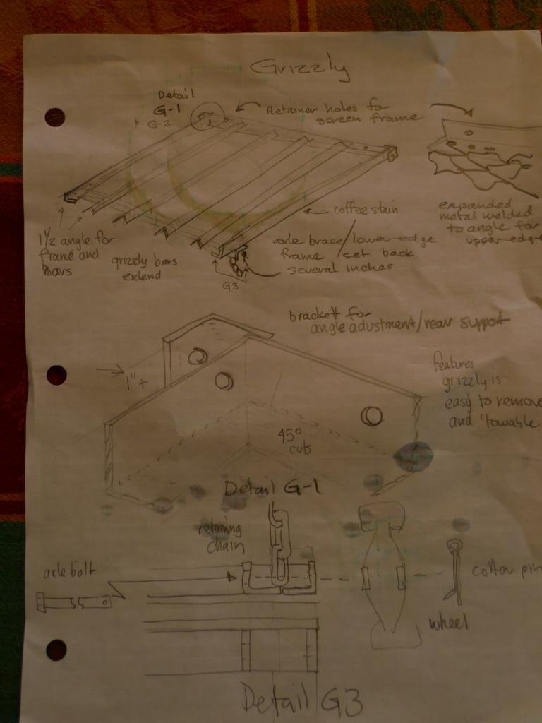

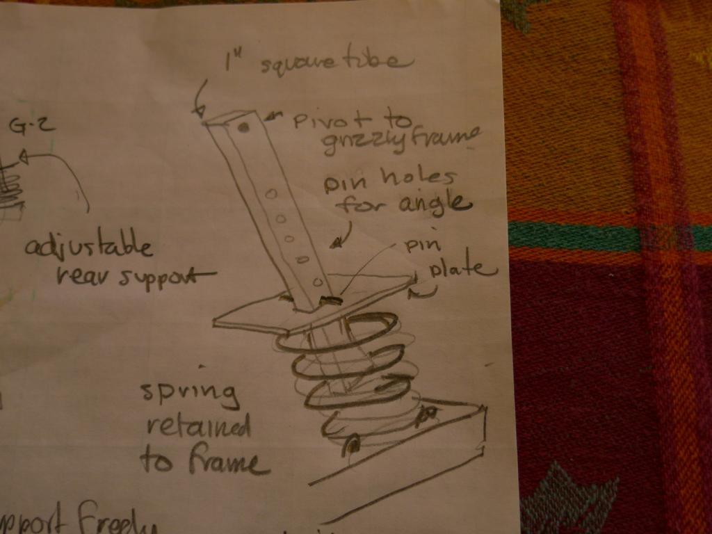

My design goals are:
Minimal Material
Minimal Cutting: No Complex Cuts. Straight Cuts Only.
Separate Large Rocks using Grizzly Bar
Provide for interchangeable Screens for sizing.
Easy to disassemble for moving with loader / tractor
Provide for various 'shaker / vibration' methods.
I don't have much more in writing except these pics.
The OVERVIEWS IN BOLD should be sufficient, but detail views included.
OverView of Grizzly
Grizzly Closeup
Pivot Bracket for Adjustable Support
Overview of Support and Frame
Support Side View
Adjustable Support with Spring

What do you plan on using for the shaker part, an eccentric weight or something else. I didn't see that part on your sketches.....Mike

I have a home made (by someone else) grizzley, non vibrating. I find that the angle needs to be at about 45° to shed the bigger stones without piling up. The spacing on my bars is about 3". It makes decent gravel but a secondary shaker would be nice for a finer, better (graded.sized) end product. It looks like you might be planning on using expanded metal for your screen. A friend has a small EZ screen? and has experemented with expanded metal with poor results. It is just not heavy enough and the commercially made screen seem to be worth it.

My notes indicate that I am still working on the vibrator mechanism.
I have several design ideas.
1) a spiral wheel that compresses the springs during 359 degrees and pops it loose at 0/360 degrees. Maybe this will launch a few stones.
2) an eccentric driven by a longer belt that is concentric or coaxial with the wheel axle to eliminate belt length variation.
3) a crank shaft on the lower frame that has an adjustable connecting rod to the grizzly. (there is that word again).
RustyIron
Hopefully I can use it non vibrating with the adjustable arms at full length to achieve about 45 degrees.
When vibrating, I think I can come down quite a bit.
The inverted angle iron would create the main grizzly. I would like to have several screens (expanded metal) welded on the upper edge to another angle iron that can be fastened at this upper edge to the grizzly frame. This approach means that in a run, all material would pass through the equivalent of a single sized screen.
I would like to have a finer screen below the grizzly bar with a means of further separating the materials, but this mostly likely would complicate the frame. Open to ideas tho'.
