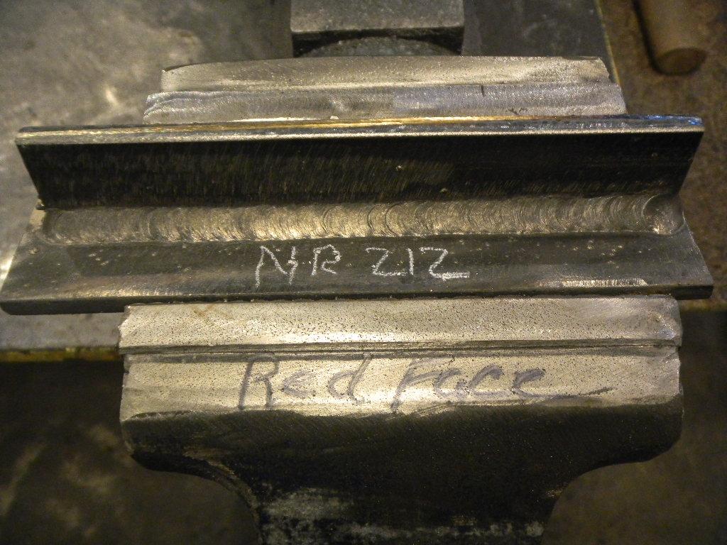

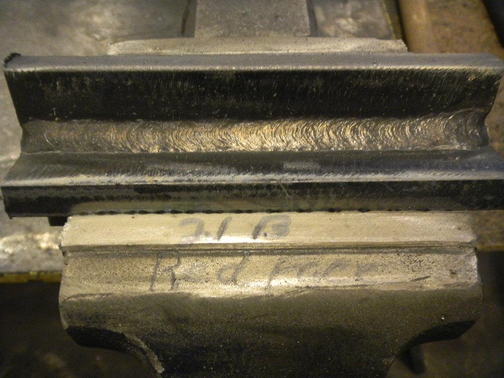

I believe that machine and wire is too small for a project like this. Do you have or can you borrow a SMAW / stick welder? I'd run 1/8-inch 7018.
I've run more flux core self shielded wire than anything else. Can't say I've ever run .035 wire though.
Here is some .045 Lincoln NR-212, and 1/16-inch Hobart 21-B.

I went and found the manual for your welder. Yeah you'll need a bigger welder! Here is a calculator from Miller, play with the numbers to make sure I'm not missing something.

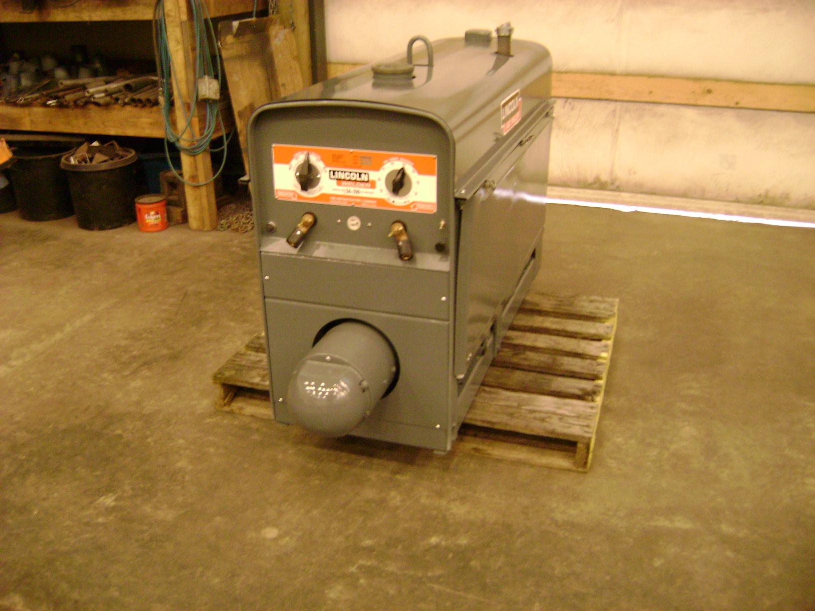

   / Working on Design for Grizzly Vibrator. Input appreciated! #28
I don't know what this guy means by older rod welder. He is just north of you, maybe something to go look at. Sometimes around here there are some good deals on Craigs list. I bought this 1966 Red Face for $200.00 just north of Sea-Tac.
older rod welder
#29
there are some good deals on Craigs list.[/url]
I have a saved search for Craigs List.
I look at it regularly but haven't been serious about a bigger unit yet.
My brother in law has the Lincoln that looks like a red tombstone. I see those around $200 - $300 But Home Depot seems to have a new one for about $299: Lincoln Electric AC225S Arc Welder-K1170 at The Home Depot
I will admit that I DON"T KNOW A GOOD DEAL when I see one :)
I have been happy with the repairs that I have made with the 125.
The Miller calculator shows .035 for 3/16 steel. Manual boasts 1/4"
Dang.... I was going to build a bridge with it. :)
