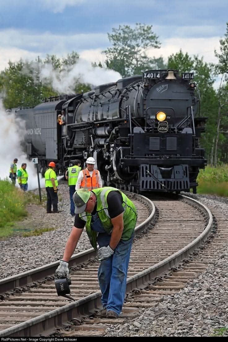

A few years back the UP 4014 Union Pacific Steam 4-8-8-4 was in Superior, Wisconsin. Can't believe I missed seeing it then. 😟

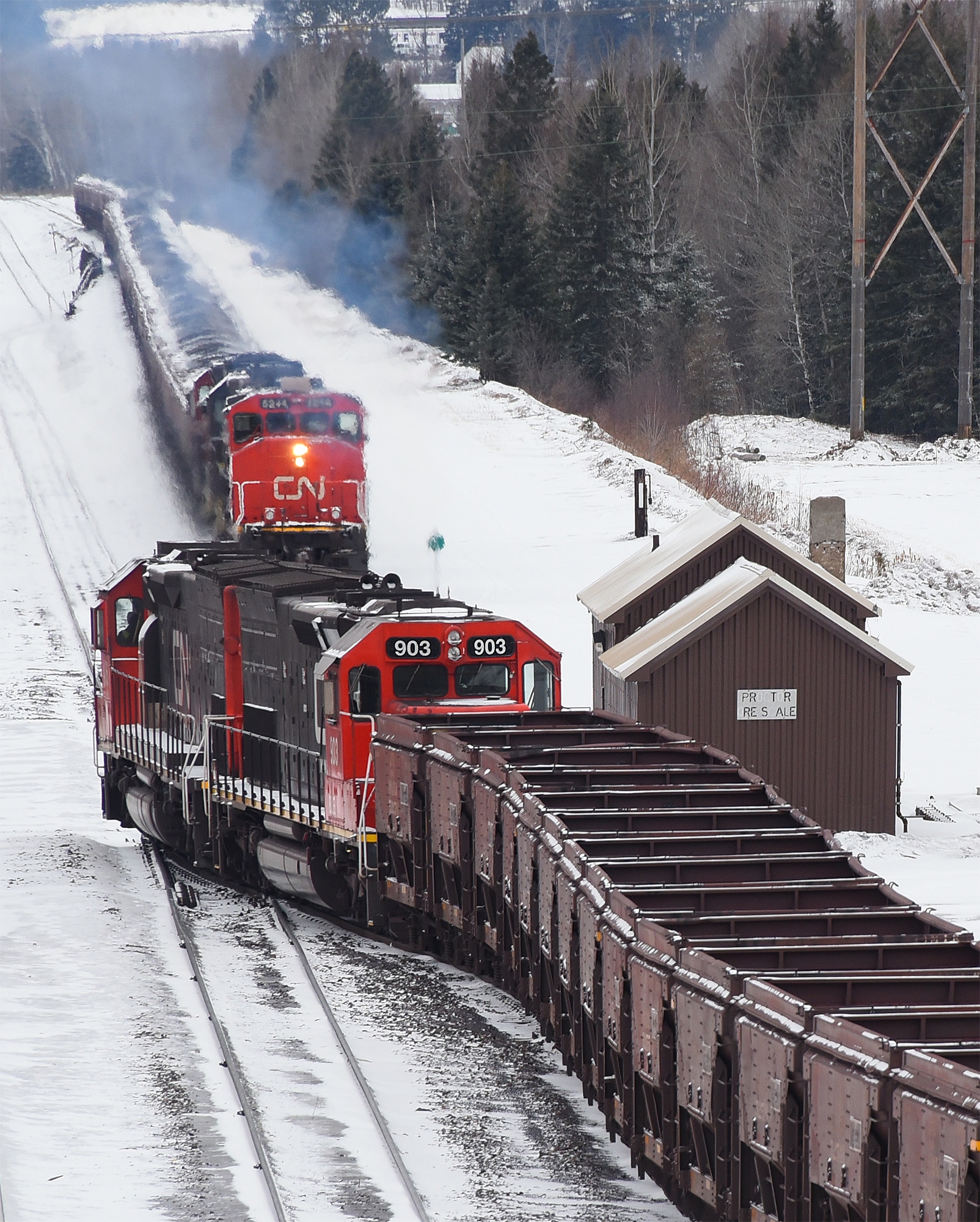

A break in the snow finds a U716 departing with ore empties for United Taconite while a PRS crew gets ready to take a load down to Dock 6 in Duluth MN.
Taken on February 18, 2018.

A few years back the UP 4014 Union Pacific Steam 4-8-8-4 was in Superior, Wisconsin. Can't believe I missed seeing it then. 😟View attachment 2207223
The guy in the foreground is applying oil to the inside of the rail to cut down wear in the wheel flanges. In some areas, they used to have oilers on the rails that would apply lube to wheels on the outside rails of a turn to help them negotiate the turn with less friction.
