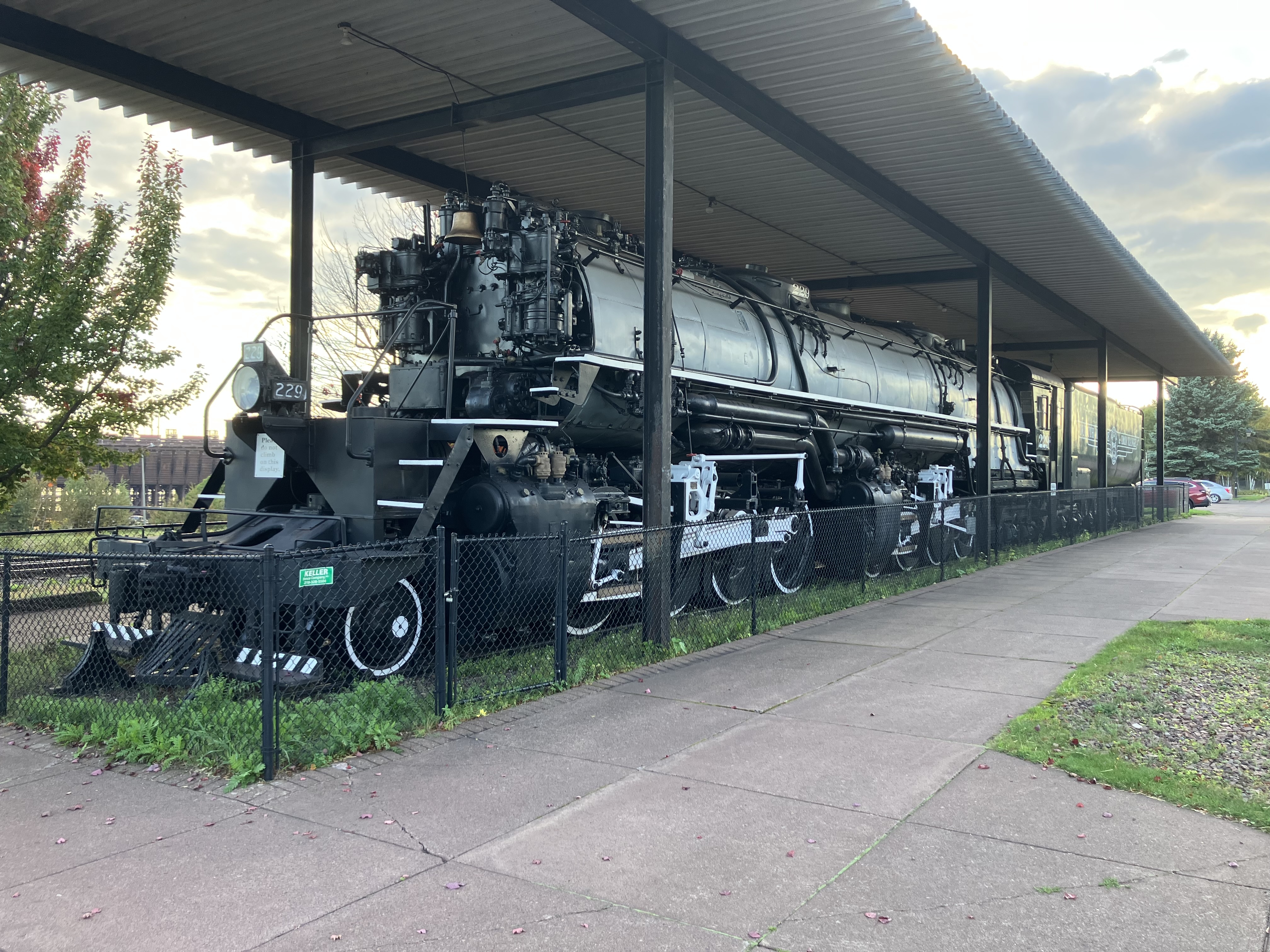

If I remember correctly, the Mesabe Iron Range Yellowstone locomotive on display in Duluth, MN had well over a million miles on it when it was retired.
   / Working rail roads and their tracks. #4,204
Just saw it two weeks ago! (y)

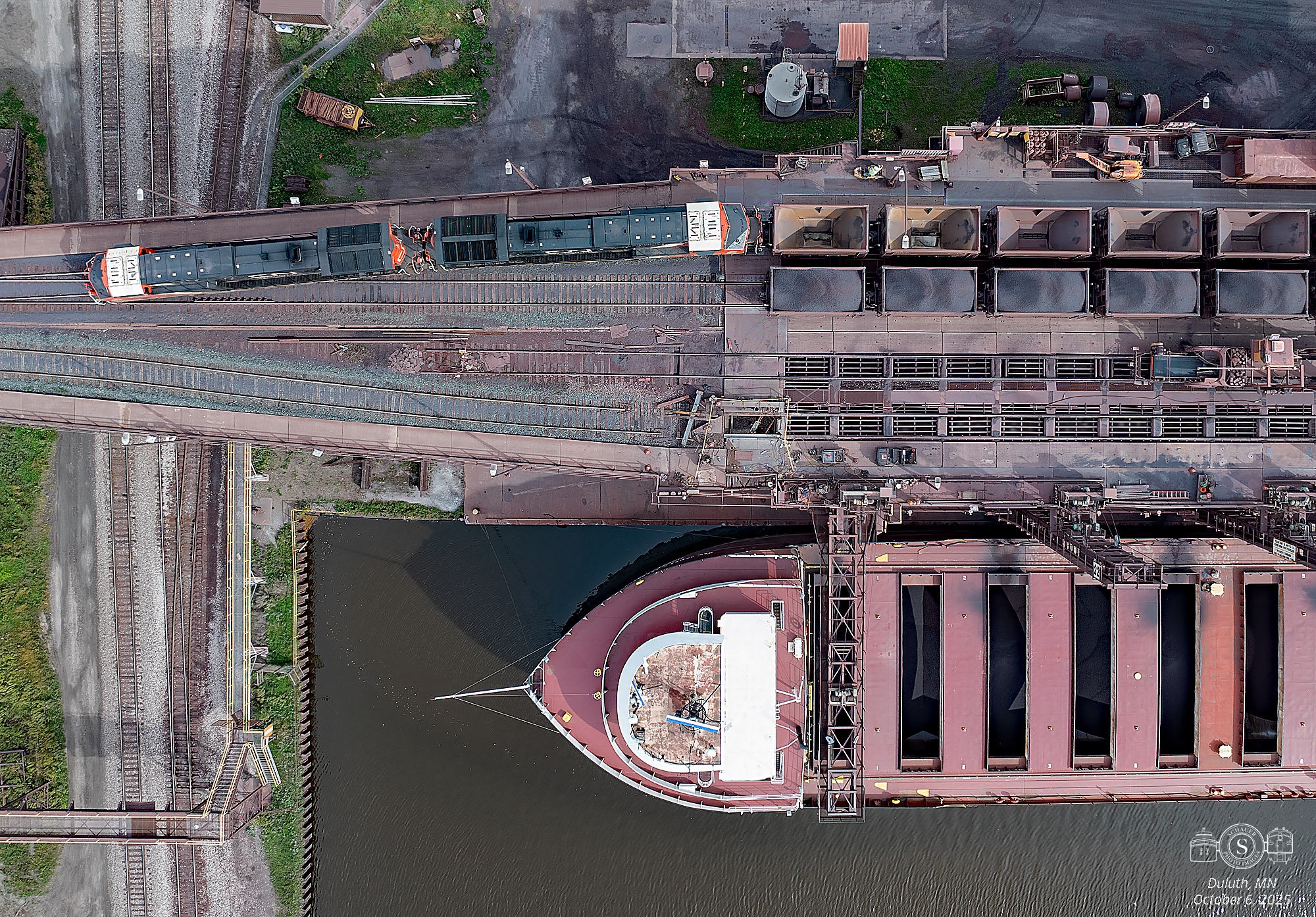

Boat and rail pic.
CN's day hill job R921 spots ore cars for dumping at Dock No. 6 as the Hon. James L. Oberstar loads UTAC pellets for Indiana Harbor, its first trip after being at Fraser nearly four months undergoing repairs. The new face of the Missabe, GE AC44C6Ms 3321 and 3313, provide the power. Duluth, MN - October 6, 2025
