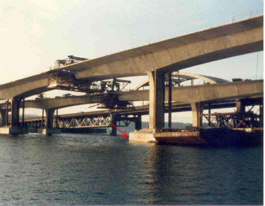

First time I had to do a lot of galvanized welding. Was on the 3rd Lake floating bridge in Lake Washington. The pre-cast concrete panels had galvanized angle iron embedded in the ends. Placed a 1/4-inch thick galvanized flat bar over the angle iron and made lap joint welds.

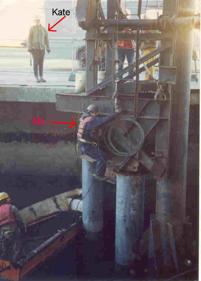

Pier 69 downtown Seattle is an all galvanized steel dock.

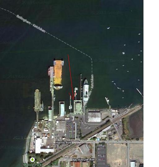

Same with the Alaskan Ferry Terminal in Bellingham Washington.
